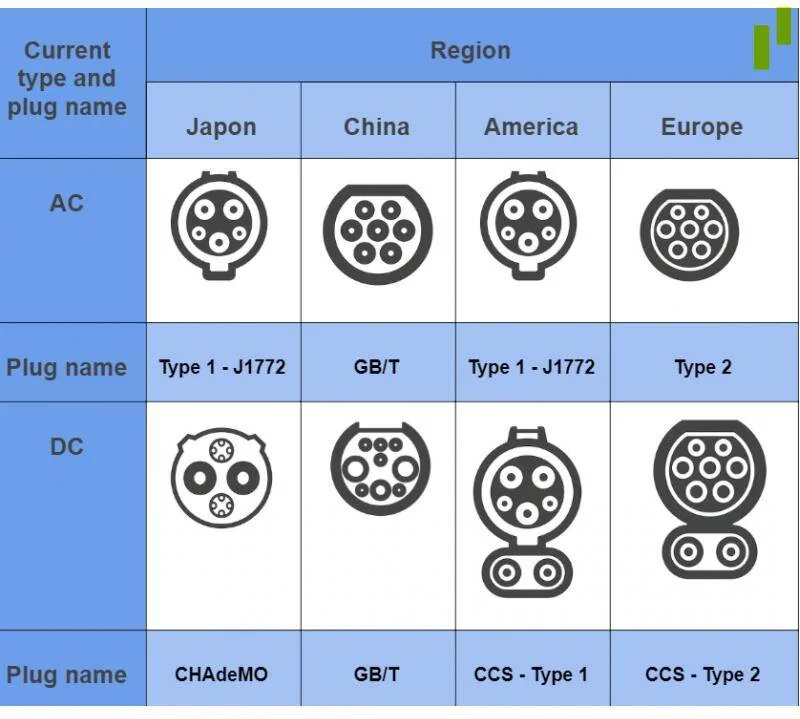

No surprising. There are 4 (5 if you count the old Tesla Roadster) in just North America and Europe.
Yeah in this day and age it's a bit idiotic.

Look at the evolution of VGA, USB to name a couple. I don't think it will change for EV's . How does this square connector fit into this circle port; ah you force it in ;)
