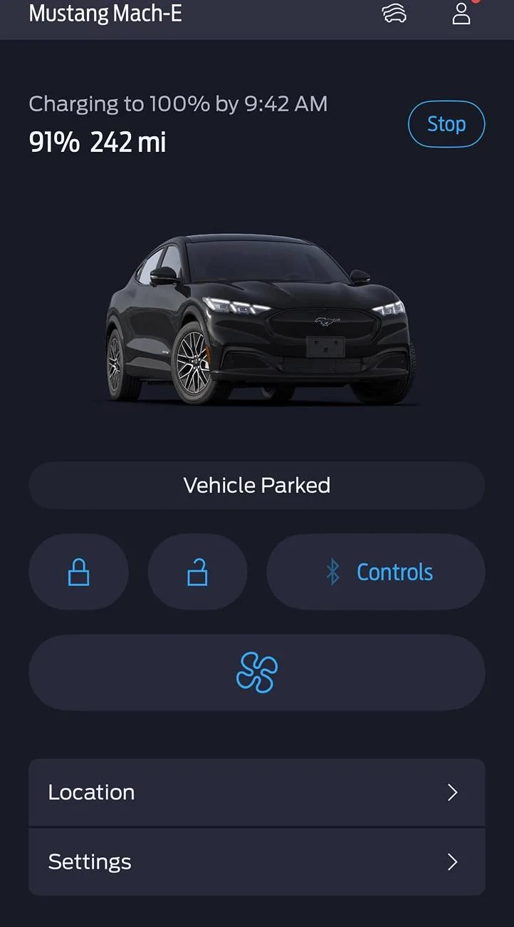

This new start/stop button showed up today on the upper right. All it seems to do is force charge to 100%…and override my 90% setting. Anyone know of any other purpose.
Was hopeful to get climate controls on the app, but nothing yet and no car updates since purchase of this 2024 MME.
Hi, I use the start/stop button often.
Here in Denmark we have different prices on power throughout the day so when my car is plugged in I can stop the charging when the price is high and start it again when pris is low and that way save some money ?
Maybe you haven’t noticed yet, but if you stop the charge with that button, it will start back up after a short period unless you unplug.
Okay, I have not experienced that, are You sure ?
I did experience it once - the only time I used it. I parked at the airport on a charger and since I had not charged there yet, there was no location for which to set a charge limit. I figured no problem, I’ll stop the charge when I get to my destination. I stopped it at 90%, but when I returned to the airport, I found the car at 100%. I don’t know how much time elapsed before charging resumed.
Others on the forum have also reported seeing this.
Okay, maby it's because it was on a public charge ? Because I only use it on my own home charger and there it does not start by itself unless it reach into my preset charging timer.
Maybe different software in Europe.
When you tap the Stop charging button in the top right it will pause charging for 8 hours. Charging will automatically resume after 8 hours if the car is still plugged in.
