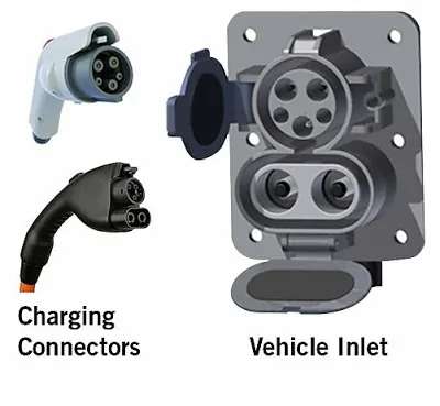

I don't disagree about the confusion, but the article you've copied that info from was intended for a European audience. North American hookups are different.
At home (or if you're lucky, at work), where you'll hopefully be doing the majority of your charging, you'll be using the J1772 connector. The car comes with the charging adapter for this. The other end of the adapter plugs into either of two standardized, North American wall receptacles.
During a road trip, you may also encounter the J1772 (or sometimes even a wall receptacle) just like at home. This will be at places like hotel parking lots, where you'll be parked overnight.
And if you need to charge up more quickly, you'll be looking for so called "DC Fast Chargers" aka CCS.
The only things you can't use are CHAdEMO or Tesla's Superchargers. CHAdeMO is only for older Japanese electrics (and the current Leaf and Teslas w/ an adapter). Fortunately, you'll nearly always see a J1772 or CCS cord whenever you see a CHAdeMO, so that's not really an issue.
Tesla currently restricts its Supercharger stations to its own vehicles.
This graphic shows J1772 above CCS, and what it looks like on the car that supports either them (Mustang Mach-E supports both).
Ford Mustang Mach-E Ford Charger for Mach-E ccs2

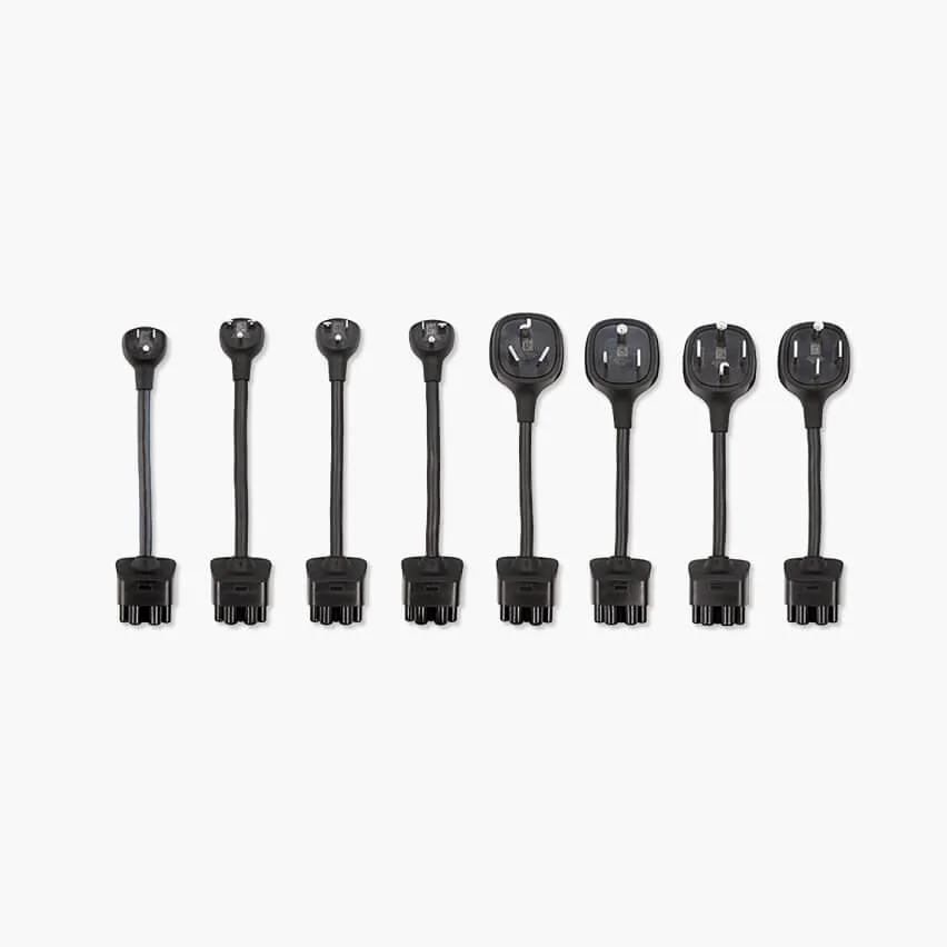

Yes I agree. When Ford gives us the cord for charging we will need adapters that
will fit our choice of power supplies. I had these with my Tesla roadster. They plug
into the end of your 10 foot charging cord. These will not come with the Mach as
per cost and your personal needs. Below is what I am speaking about.
Each adapter is $35.00

I have a similar setup to my Clipper Creek I keep in the trunk. It has a twist lock connector and I use adapters to go from that to others (mostly the campground plug).

You are correct "easy peasy". The J1772 will plug into your car BUT the other end must
fit your power supply. That is why you need adaptors .

May not need every adaptor. Some are commonly used elsewhere.

Yes you will not need more than 2 and maybe 3. I had 120V 20 amp and 240v 4 wire 50 amp.
This is all very simple but many will be totally confused. Just plug in your car use the adapter
to fit power supply and use touch screen to dial in your charge.

Just so everyone knows, adapters that you use on the plug that are non-OEM are usually a bad idea, they can cause thermal issues if you buy a cheaper one. The OEM adapters are usually the best bet.
What sorts of plugs does everyone use besides the 14-50 and 5-15?
