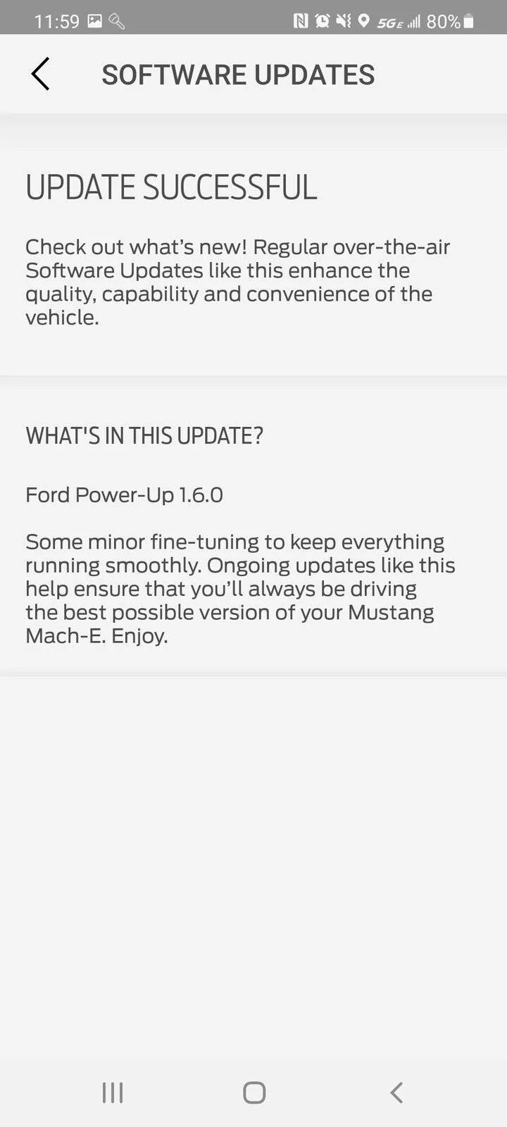

I have had no noticeable additional problems since the 1.6.0 update. SecuriAlert now does not toggle itself back on or send messages which is good. With the extent of hardware and software in these it is not difficult to believe that not all are created equal. Couple of bugs to iron out but all and all this is one of the most awesome vehicle's I have owned.

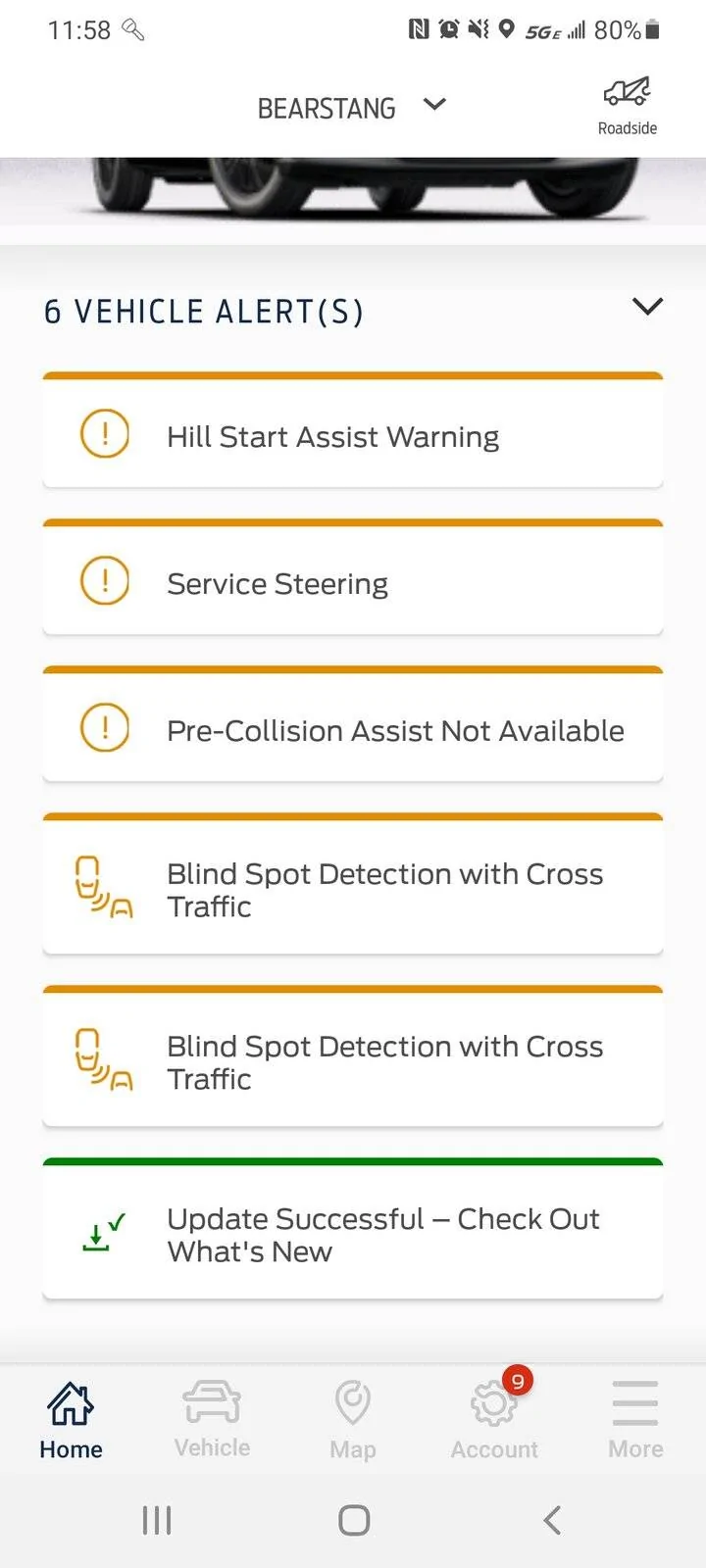

For anyone interested, here's the latest on my original issue. Took it in Thursday 8/5. On Friday they told me that software updates/re-installs weren't fixing the problems. The current theory is there may be a problem in the car's wiring. So they want yo keep the car through this week to try to figure it out.
I'm losing confidence that this will go well. But fingers crossed.

Update: The dealer now believes it is the electronic components within the steering column which have failed. They are ordering a new steering column, and that's where we are at the moment.
