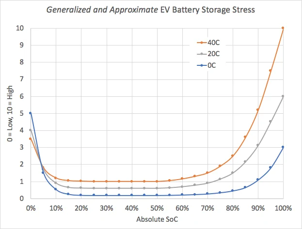

AS for HVB battery stress, below 20% soc and above 80% soc is what one wants to minimize. Meaning don't charge to 100% once you get home and let it sit all night at this level.
Ford Mustang Mach-E Ford's Connected Charge Station tesla battery stress and soc
