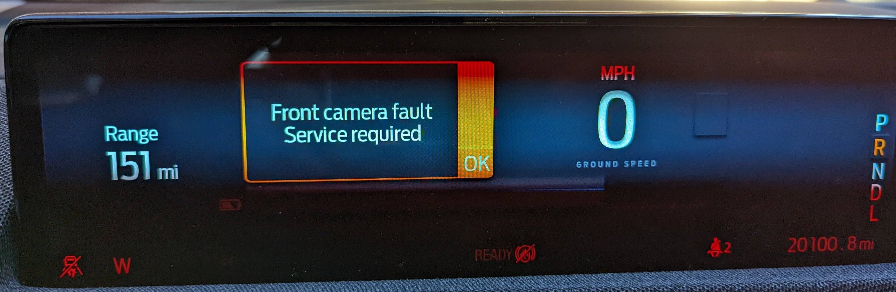

In fact, look what greeted me this morning after all my trips to get the issue fixed, all the part replacements, and all the software updates and resets.
Ford Mustang Mach-E Front Camera Fault & Pre-Collision Assist Not Available Errors PXL_20220929_132333493
I think I only saw it twice this week, which is less than normal. I suspect as it gets cooler the errors will be less frequent. Then next summer it will start all over again.
FYI, was 59 degrees this morning :)
