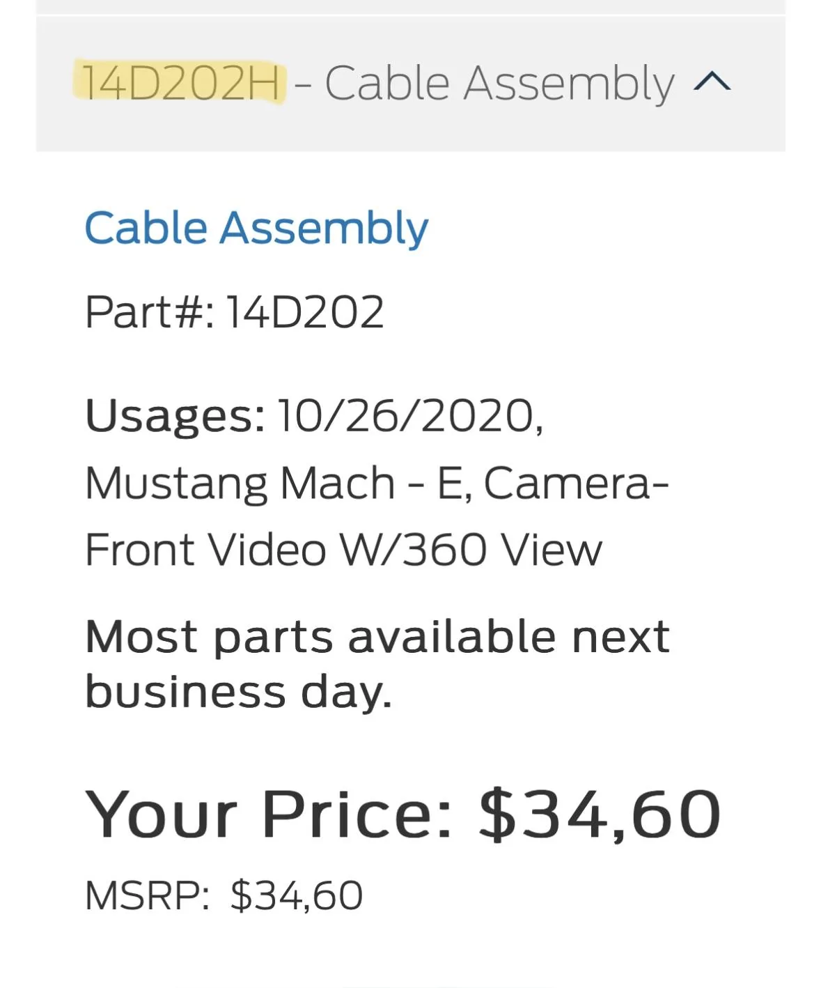

I get both. One in the ipc and one in the app. I did have my coax cable replaced and it has been solid since
Do you mind editing your first post with the Coax part number etc to make it easier for us to track down what we need to tell the dealer? Thanks!
I would love to except I dont have the part number. I believe someone else posted the part number in this thread somewhere. Also, It will take a couple of trips to the dealer. Best thing to do is call the ford hotline and open a case and see if they can have your dealer do it. I went to the dealer and they said they didnt find any errors and couldnt replicate it. The hotline called the dealer and told them to replace the part and its been solid since.
Ok, yeah i'm trying to track down the part number. My dealer is pretty good about just listening to me, so my plan is just to provide the part number to them first.

Personally, I would be cautious about pushing any particular "fix". I realize a couple folks in this thread indicate the cable fixed the problem, but other folks had other "fixes" that worked as well. Push instead for the Ford BEV customer team to open a case for you (contacting the Ford rep on this forum like you have is the first step). They will deal directly with the dealer for whatever fix you happens to need.
zhackwyatt
Dec 18, 2019
1,617
2,635
Arizona
True, but it makes a lot of sense to me for two reason:
1) I can reliably cause the problem by hitting (not hard) the upper console.
2) I, like many others, had the headliner taken down due to a previous recall, so it makes some sense that process could have damaged the cable which is apparently very sensitive.
I am thinking the root errors are bad cables or connectors on either end of the first section of coax either from factory, or POSSIBLY from windshield replacement trauma.
about a month ago, I popped off the black plastic cover above the rear-view mirror, and I just rotated the cable a little and pushed in to make sure the connector was fully snapped in. I have not had an error since, so I',m thinking I might clear the DTC codes and consider it 'ok for now'.
