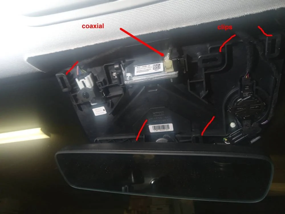

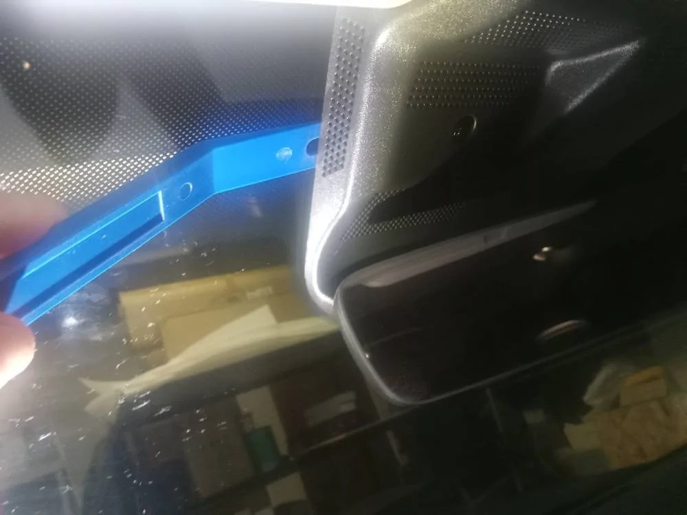

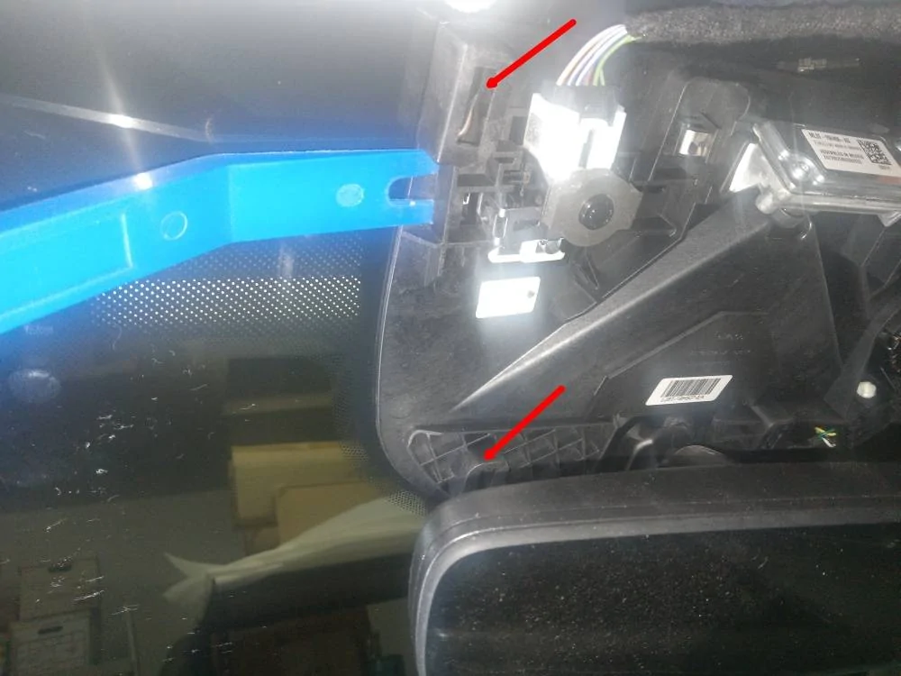

Would it be possible for you to post some photos of where this cable is located at?
5 clips hold the cover on..... just pry straight away from windshield
Ford Mustang Mach-E Front Camera Fault & Pre-Collision Assist Not Available Errors 01 pry location
Ford Mustang Mach-E Front Camera Fault & Pre-Collision Assist Not Available Errors 02 pry location under cover
Ford Mustang Mach-E Front Camera Fault & Pre-Collision Assist Not Available Errors 03 cover off
