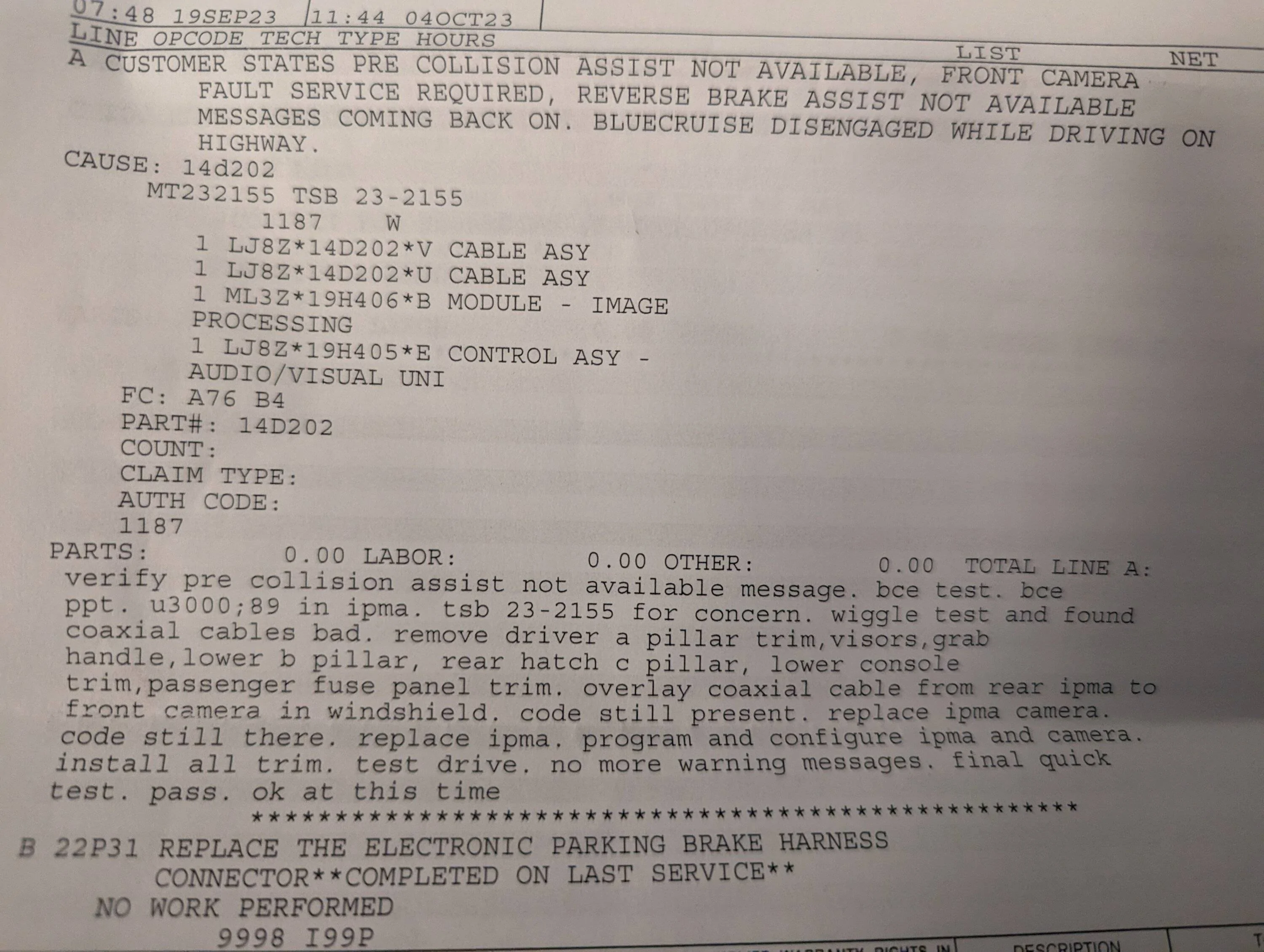

Got my car back today after being with the dealership for a second visit. This time TSB 23-2155 was performed. Error code 03000;89 stored in the ipma. Note the process followed by the technician. They replaced all of the cable assembly and error was still present in ipma. Replaced front camera, error still present. Replaced rear ipma and error went away. Only time will tell!
@Briguy Been ~1 month, did this fix the problem (so far)?
zero problems with the camera since it was fixed about a month ago. With that said, three days after getting it back the hvbjb failed and it went right back to the dealer for another two weeks. So really, I've gone about three weeks of driving with it since the camera was fixed. So far so good.
