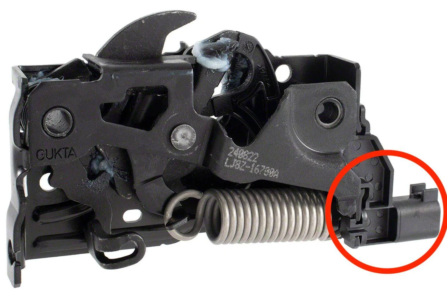

The Mach-E's frunk (hood) latch has a built in ajar switch which detects it's closure. Either you don't have this latch/switch incorporated in your setup or it's not wired correctly.

Do you not have a wiring diagram for the Mach-E?
There are two wires going to the hood ajar switch. Blue/Orange and Black/Green. Blue/Orange goes to the BCM, Black/Green is ground. As long as the Blue/Orange is grounded, the BCM thinks the hood is closed.

My car never came fitted with an ajar switch. According to the Ford wiring diagram , only the RHD models have one.
Nope, yours had a two-pin connector on the hood latch for the ajar switch.

Listen: The ajar switch is supposed to connect via the BU-OG wire to pin#26 on the BCM connector C2280e . The car I used as a donor never had a wire connected to pin #26! It has been suggested to me that the frunk latch switch is used to detect frunk closure

Don't know why your donor car didn't have this wire at pin #26 to the BCM. The North American wiring diagrams I have from '21 - '24 all show this wire in the diagrams. Was the car from a different area than North America? Yes the hood latch (ajar) switch is what detects if the hood is closed.
