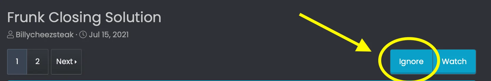

Yep. Or ignore. It's right here:
Of course, as I said, this has been calm and solution-focused. I'll keep watching. :)

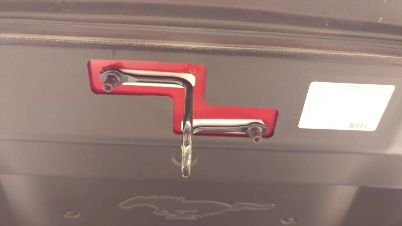

Yes I have (for other reasons) and as Mark said above, the air pressure problem was eliminated by adding a drain in the frunk. Removing everything under the hood did not change anything. The hood latch is NOT adjustable which is odd as I've never seen this in a vehicle before. Per the repair manual, the rubber bump stops on either side are the up/down adjustment and only there to align the hood with the front fenders. I lowered them completely then started raising them up until the hood was perfectly aligned in height with the front fender.
I did the same mod that Rob did in his post ( #12 ) a few months ago when I had the frunk torn apart. I used two metal spacers which were 3/16" thick. I never let my hood drop down from from high or slam it. I gently lower it down until it catches the first latch then apply pressure in the front middle where the latch is until it closes. The only drawback to this is I get handprints on the hood unless I use a towel. Doing the same mod above that Rob did and adjusting the bumpers did make it close easier but I do wish it had a self closing mechanism like the rear liftgate.

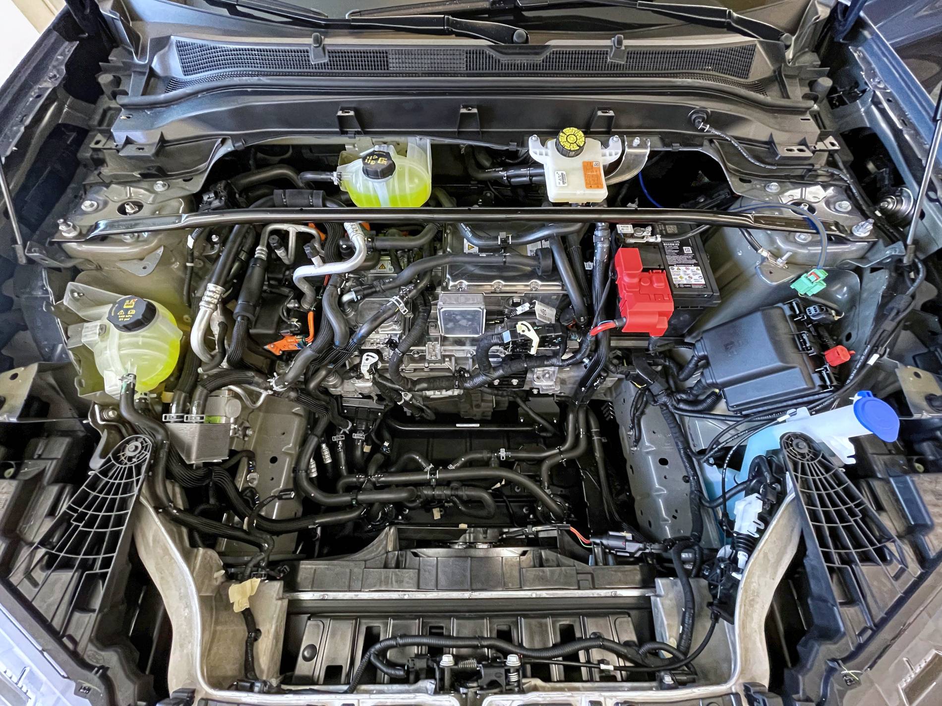

I don't have a MME yet so I can't check but has anyone that's having problems removed the struts to see if they are possibly bottoming out, make sure the hood will pop up without the struts so that you can open the hood again (really be careful here, I don't want some ones hood permanently closed). Also I would look at the bottom of the hood for wear marks where the hood may be hitting something before it should (like those bumpers). I would even silicone the gasket that is just before the windshield wipers. In MarkBoris's picture there is either dirt or wear showing on that gasket (or just something in the picture). Lastly I would activate the latch manually (you can use a screwdriver) and make sure that it is latching smoothly (make sure it is unlatched before trying to close the hood again).
