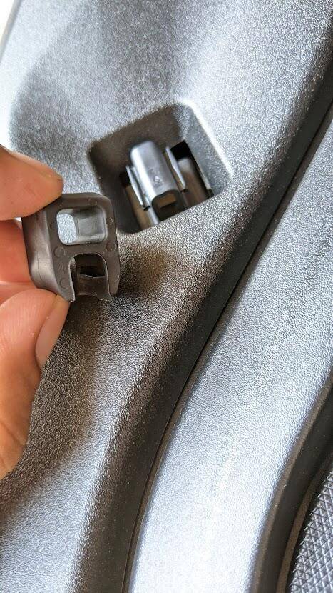

Does everyone have these rubber cap type thingys? Pulled both mine off, and at least now I can close the Frunk by applying pressure with both hands while it's resting on the latch. Kinda scared to go back to slamming it shut like I was with these pieces removed. Normal for everyone, or something they maybe forgot to pull off?

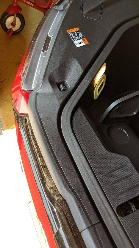

Reference pic for location:
Ford Mustang Mach-E Frunk Closing Solution 1630087396042
Before:
Ford Mustang Mach-E Frunk Closing Solution 1630087216951

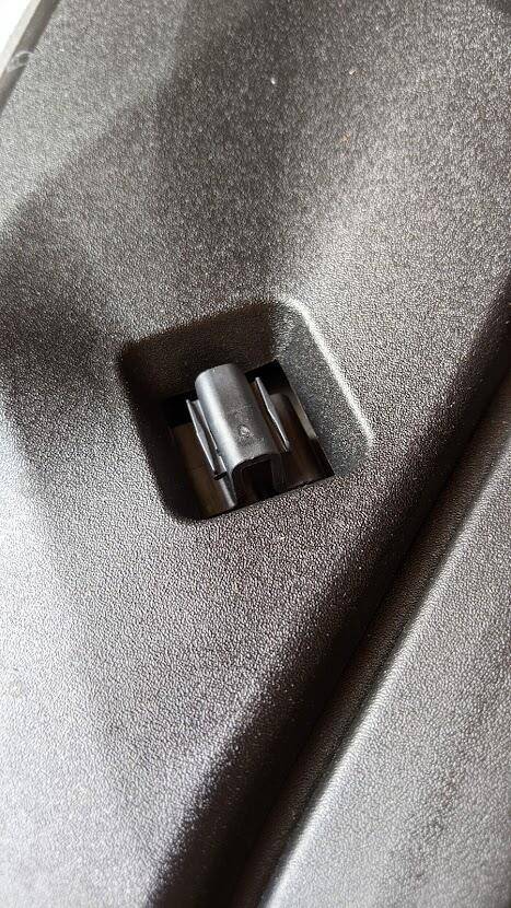

After:
Ford Mustang Mach-E Frunk Closing Solution 1630087337250
No, those are not supposed to come off. They look like they are cushions to soften the blow of the hood being closed.

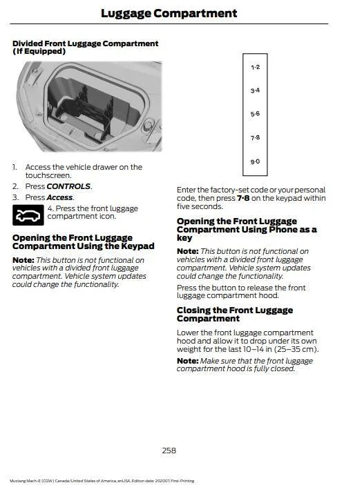

I agree. Not sure slamming is the way to go. Bringing hood down slowly and then pushing down firmly seems to be working better for me and it definitely sounds better for the car. In any case manual says if you using the gravity method, drop should only be 10-14 inches.
That advice has been updated to reflect the approach that I've been using (and preferring). :)
https://www.fordservicecontent.com/...rket=USA&div=f&vCode=&vFilteringEnabled=False
Closing the Front Luggage Compartment
Lower the front luggage compartment hood and apply closing force as it drops.
Note: Make sure that the front luggage compartment hood is fully closed.
