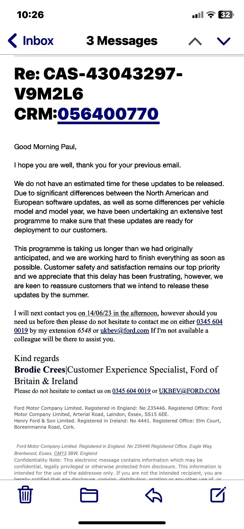

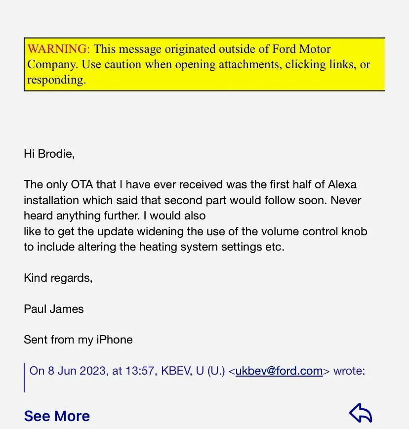

Here’s the latest from Ford Customer Service and my dealer says that there are no current updates.
Yes, exactly... ? For everyone who has working updates, January was last update 3.5.2.1 and even then was expected "big things coming soon"... I wish there is massive update coming anytime now.... ? Maybe the same IPC as F150 lightning has.
