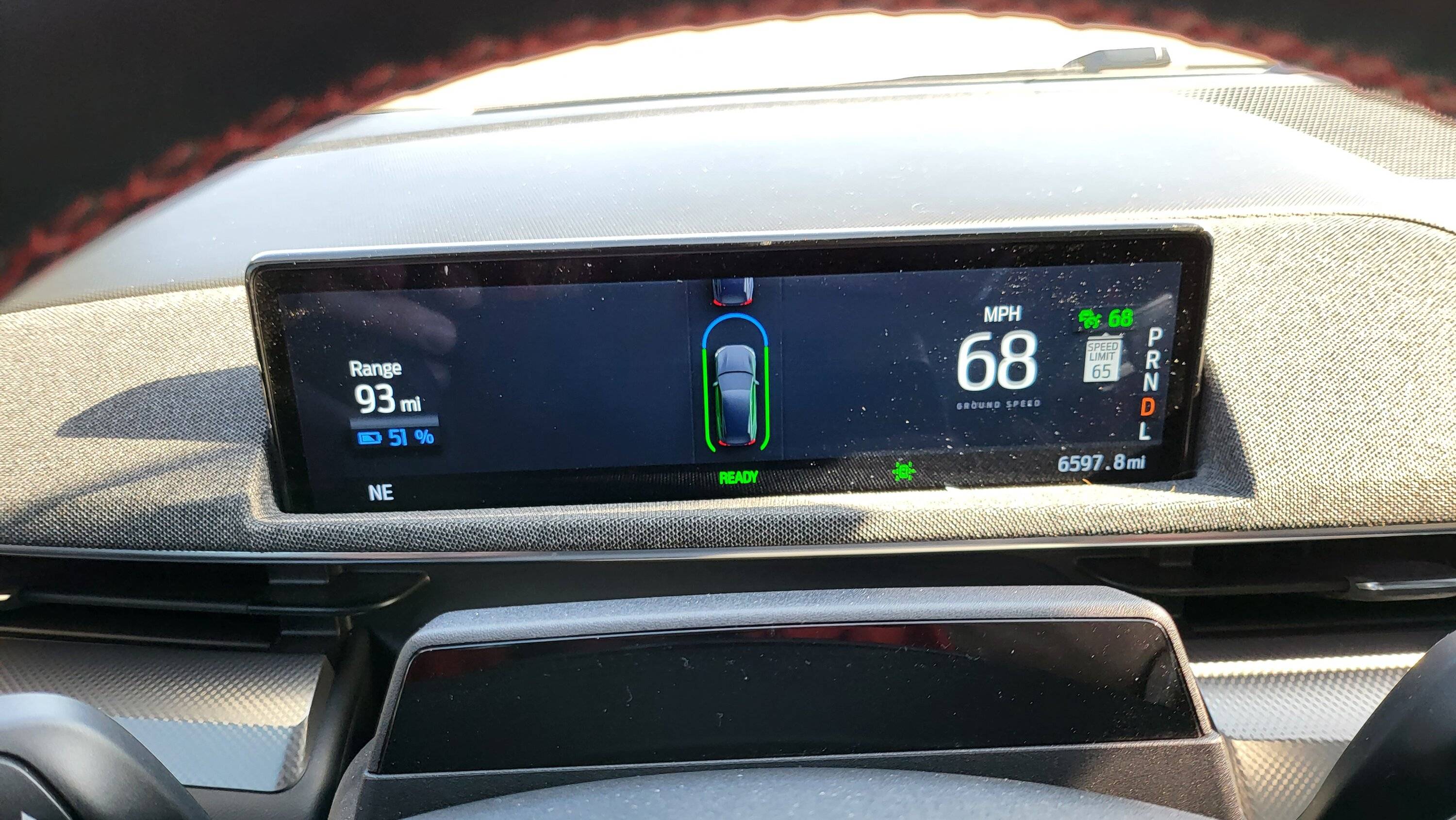

I get a call that my car is ready and so I drive an hour to the dealership to go pick it up. As soon as I turn the car on I can tell that Sync has not been updated and I'm still on the launch UI. At this point, I think to myself, it's not worth telling them about it because I don't have any confidence that they can update it, much less understand what I'm asking of them. I drive back home and then I notice that BC Hands ON isn't working either. I've got green lines for the lane keeping, but they never turn full blue or go into the curvy circle thing for Hands On BC(see photo). I've washed the car, cleaned the cameras, went on clear roads - you name it, no BC. I also get a notification when toggling lane keeping with the steering wheel button that says: "BlueCruise not available. Driver Camera Blocked - See manual." The driver camera is definitely not blocked, there are no obstructions or anything. It just will not work.
