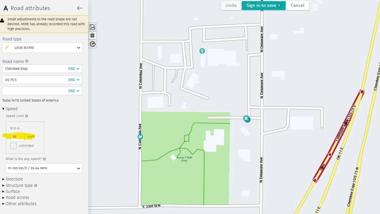

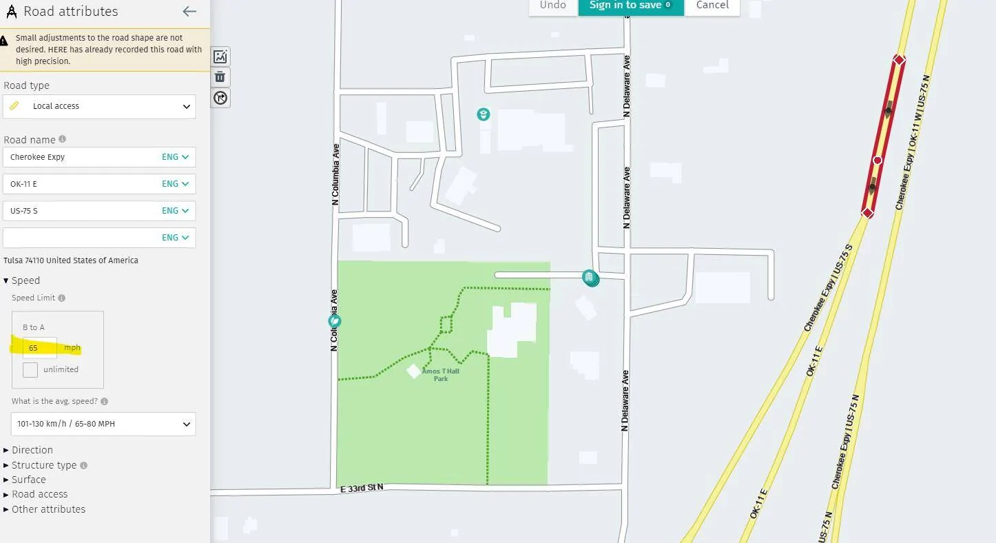

Just to confirm, the speed limit change is in the map database.
65mph here:
Ford Mustang Mach-E GPS errors and speed sign confusion 1646152569158
The next "section" of highway in the database drops to 55mph. But there is no actual speed limit change here. So the map data is wrong.
Ford Mustang Mach-E GPS errors and speed sign confusion 1646152628439

I actually just submitted a change to the database to correct the speed limit in that area I mentioned. Curious to see if that actually works, and how long it takes.
