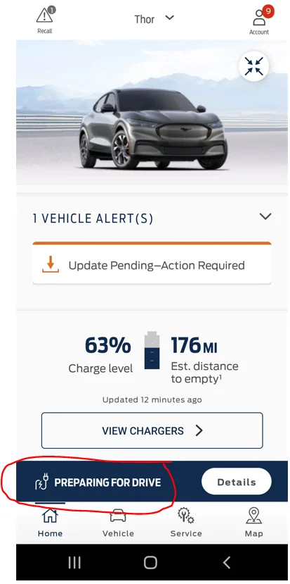

For those that are curious.....
Here is what FordPass looks like when the car is cooling the HVB without charging. It will say Preparing for Drive.

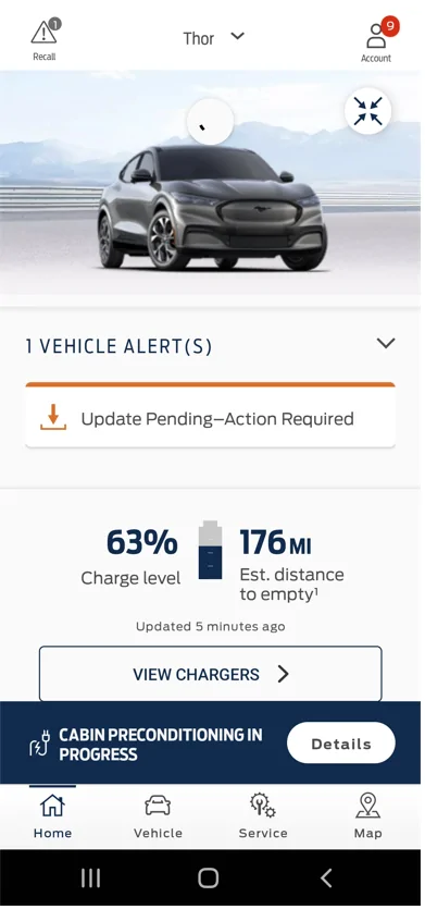

Here is what it looks like when the car is preconditioning the cabin for a departure time.
