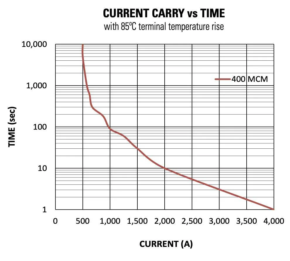

EV contactors are typically 300-500A, you don't often see ones bigger than that because it causes a lot of issues with packaging, cooling, and price goes up exponentially. Remember a 500A contactor can carry more than 500A for a short time. 500A is the continuous rating.
This is the current carry curve for a 500A rated contactor. You can see it can handle 1000 amps for 80 seconds, 4000 amps for one second, and 500 amps indefinitely.
Ford Mustang Mach-E High voltage / Powertrain Malfunction (2024 premium) Screenshot 2025-01-30 at 7.26.27 PM
The size of the wire or busbar attached to the contactor is important and affects this curve since the wire provides the heat sinking. In this case, the curve is for a 400 MCM conductor, which would be a solid copper wire about 5/8" in diameter. If the wire or busbar is smaller than that, then the carry current curve is less. The Mach-E uses a 3mm thick busbar, which is difficult to compare to a wire. But very roughly perhaps the equivalent of 175 MCM. This means our contactors should handle about 1000 amps for about 30 seconds cold. But after that the power has to be much more limited below 500A to prevent excessive overheating.
In summary, I think the 500A contactors are appropriately sized for the Mach-E, if anything the design flaw is the busbar the contactors bolt into is too thin for repeated runs at 1000A. GTs should used a different design of HVBJB with a thicker 5mm busbar to provide more heat sinking. The rest of the problem is just faulty parts that fail too soon even if engineered correctly.
