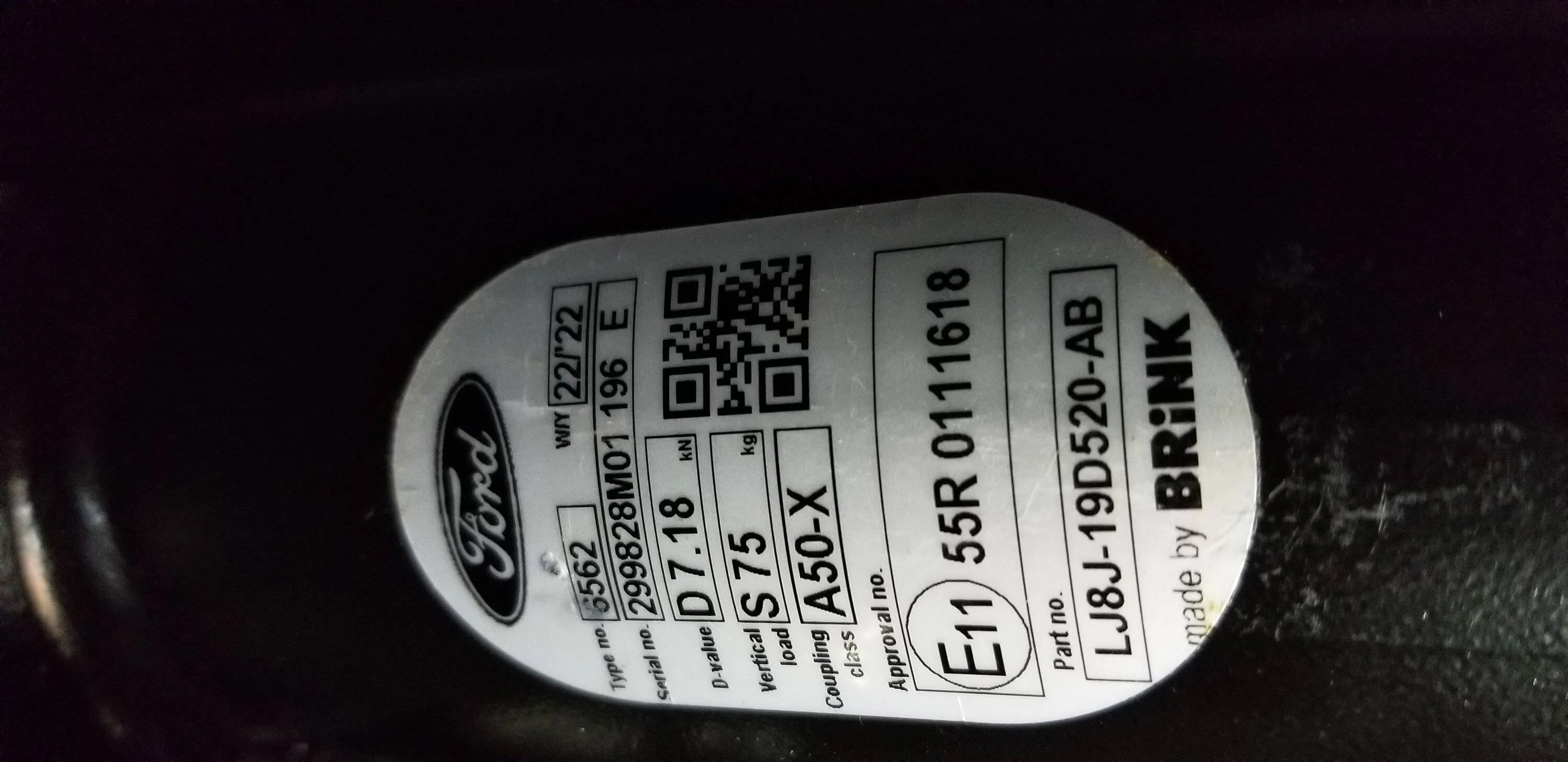

Mach E AWD technically accepts up to 3,306 pounds tow weight, and a 136 pound tongue weight for towing, and up to 175 pounds vertical hitch weight for a bike rack. I think some of these limits are dictated by the Mach E's mechanical design limitations, as my tow hitch Mach E installation instructions gave a tow strength of about 4,200 pounds for this attachment. This info is also available on other threads here so I won't repeat it.

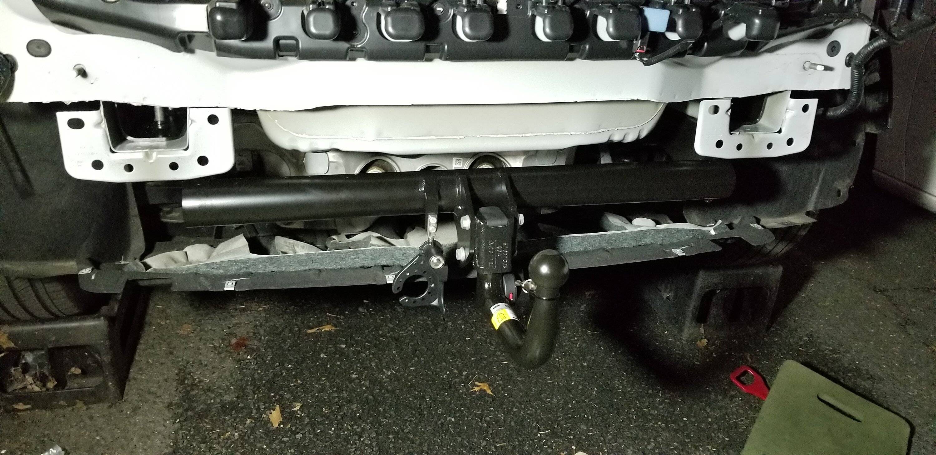

And yes, the bottom of the rear bumper cover needs to have a cutout - shown in two of my attached pix above.

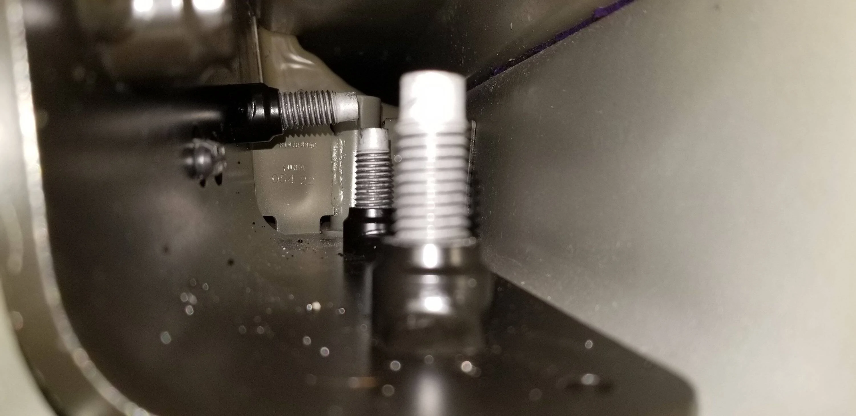

Well... there is also the manner how these hitch frames tie into the vehicle. Pls see the attached pix in this post to see the Ford tow bar bolts into the frame rails with a steel L plate which sandwiches the frame rail between this L shaped insert and the corresponding L shaped tow frame on the outside of this vehicle frame rail. That's a pretty robust setup. For comparison, how does your Draw Tite hitch model tie into the frame rails?

Ford Mustang Mach-E Hitch install uhaul Mach E OEM tow frame insert with 3 bolts

Ford Mustang Mach-E Hitch install uhaul Mach E OEM tow frame - assembled except for the electric connector
Ford Mustang Mach-E Hitch install uhaul Mach E OEM tow frame - data sheet with Ford label
