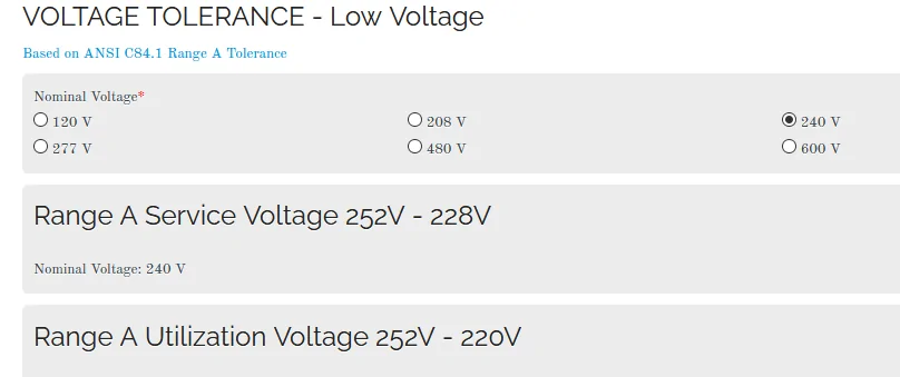

Voltage tolerances are defined by ANSI C84.1. Here are the numbers for 240V:
Ford Mustang Mach-E Home Level 2 Charger Issues 1614623621549
While the max is 252, I would consider equipment to fail to operate at 256 to be of poor design.
I had the electrician at the house this morning and he disconnected by charger, took a meter and verified I have 248V at the outlet. We plugged the EVSE back in and it still did not charge. I agree, either an issue with the 240V and the variable voltage that can happen that some MMEs are not liking or it is software relating to the car not charging while at home (or sporadically charging at home). Either way, makes me feel better that the Chief Engineer of the Mach-E is in communication with me and the dealership. After I create the online excel sheet and we start listing the effected VINS, hopefully that can provide his team further insight.
