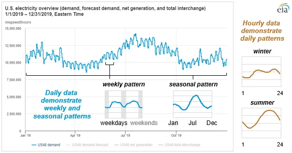

This might lean towards a high voltage issue. The demand fluctuates throughout the day, week and season. If you take a look at the demand curves, when the demand is highest (grid is most stressed) is when it's more likely to have a voltage sag and when demand is low is when it's more likely to have a high voltage. So at 1 - 4 pm on a weekday, demand is high.
If you can determine a trend where you can charge during times of peak demand but not on weekends or overnights that's certainly something worth reporting to whomever is looking into this at Ford.
Ford Mustang Mach-E Home Level 2 Charger Issues 1617022902306
https://www.eia.gov/todayinenergy/detail.php?id=46117
https://www.eia.gov/beta/electricity/gridmonitor/dashboard/electric_overview/regional/REG-MIDW
