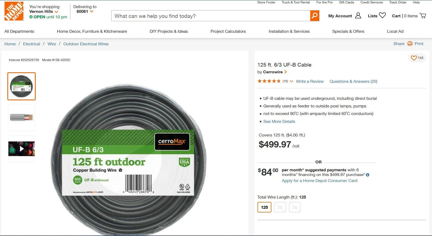

We were allowed by our local inspector to use direct burial #6/3 UF-B cable buried two feet or placed into rigid conduit and buried 1 foot. The ground wire was enclosed within the cable, so that simplified the grounding issue.
Ford Mustang Mach-E Home Level 2 Charger Issues UF-B Direct Burial Cabl
