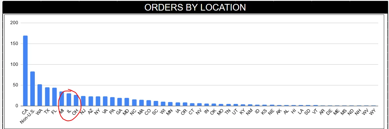

Another member from Illinois. This is so odd.
Agreed. I was originally leaning towards high voltages, which it may still be, or at least part of it. But either there is a largely disproportionate number of people from IL on this forum, or there's something going on with them. I'd be interested to see if they're delivering power with a high total harmonic distortion (THD) or if there is some powerline Ethernet in use by the utility (which was already identified as a known issue).
Either way, I would hope that Ford can lighten up their tolerances a little to clear out this issue via software.
