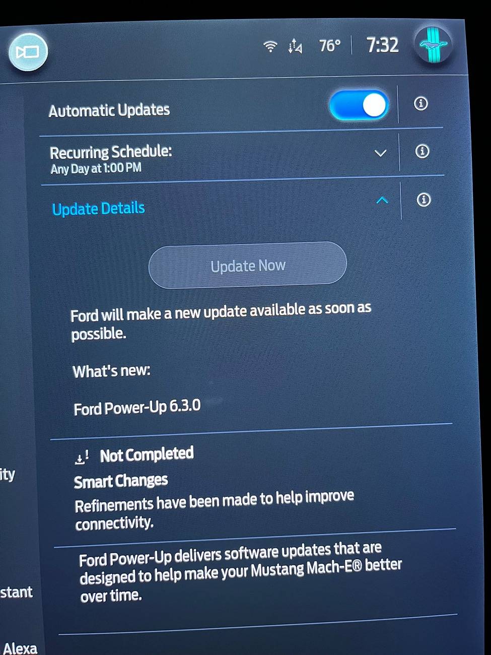

I’m stuck on this update.
Please see the note at the top of the original post, this topic does not apply to "Not Completed" updates. There's nothing you can do but wait.

The same OS version is not complete for me as well (6.3.0). The tech spent 5 hours updating all of my software module and he said that new APIM didn’t show up after all other module was updated. So I guess it’s waiting game.
Sandpiper
Jul 17, 2024
Toronto Canada
Mach e 2024 AWD Extended Range
Were you able to get the dealer to look at it under warranty? I'm also stuck at 6.3.0 and I'm hearing mixed messages on dealers performing software updates.

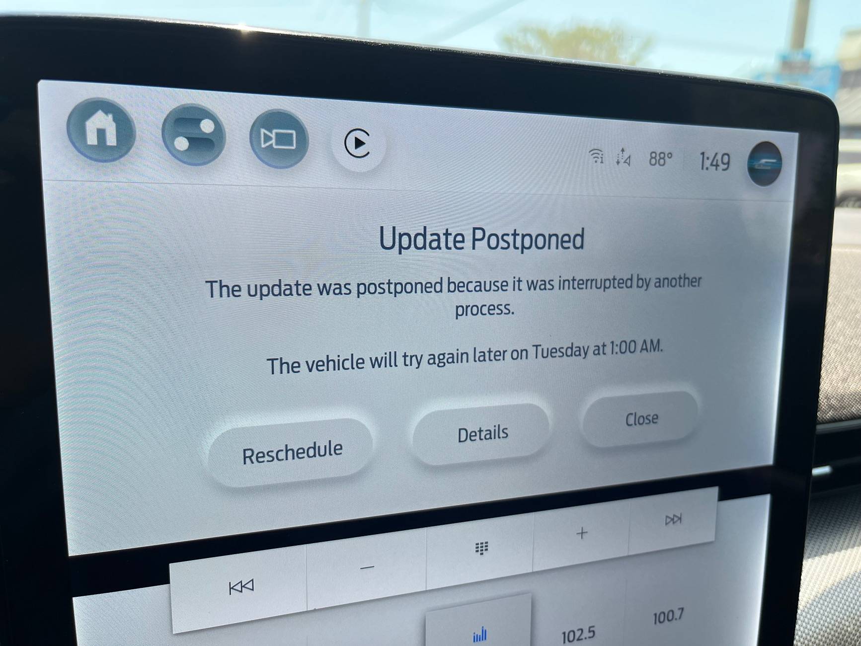

Thanks for this thread.
I kept getting this “update postponed” error when trying update now.
Ford Mustang Mach-E How To Get Failed OTAs To Install IMG_2321
I used the 12v charger method. Even took two times charging to get the charge high enough.
