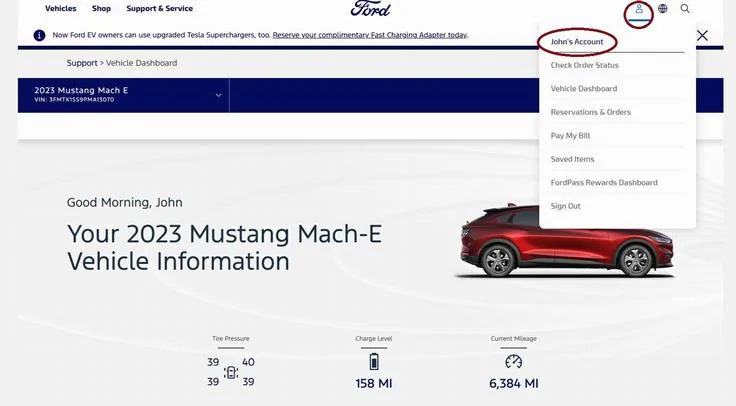

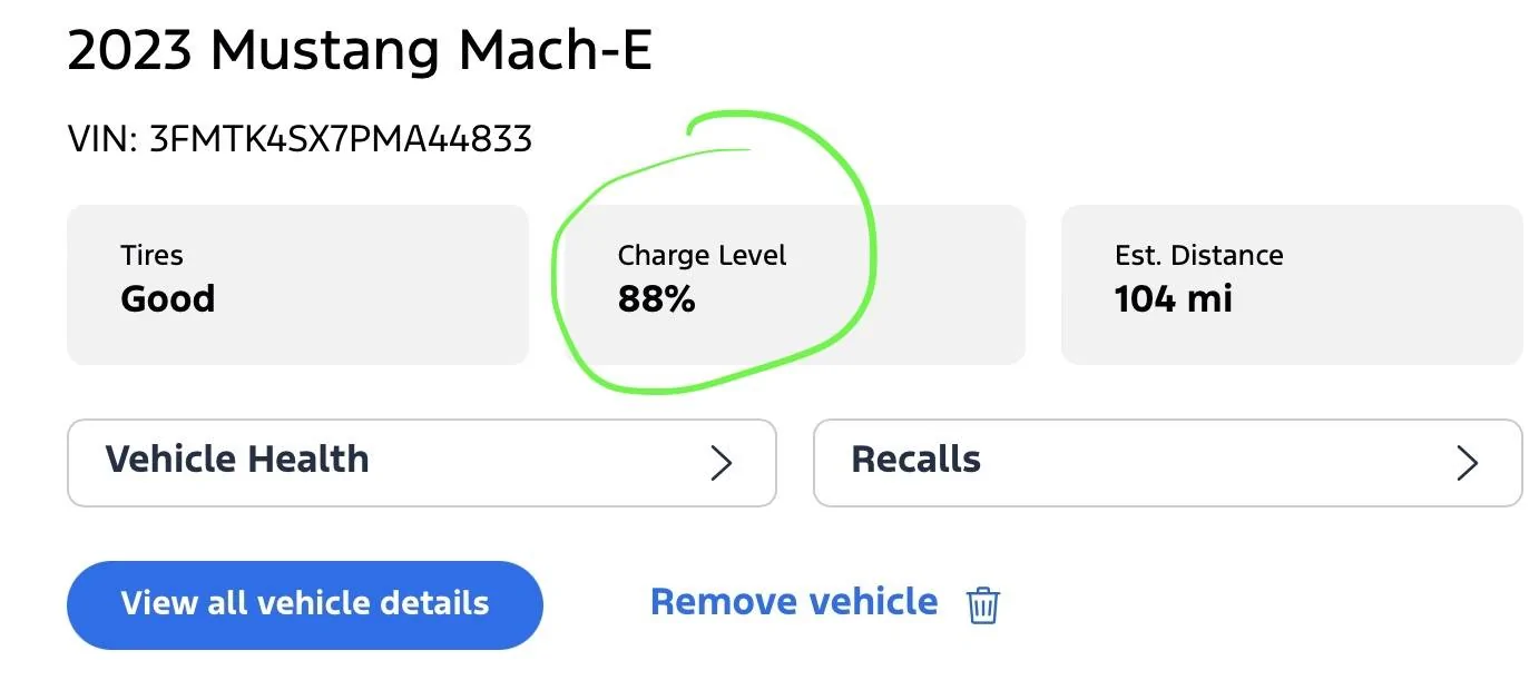

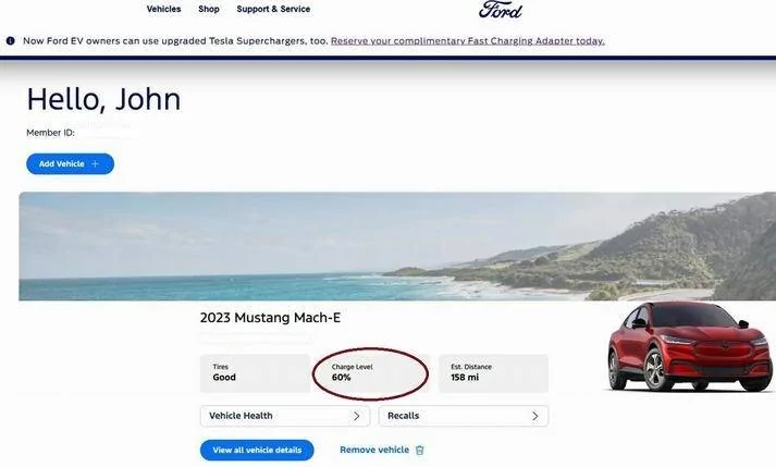

Yes, that is where I obtained the screen shot however I do now see where the 12v battery level is shown.
You need to do one more step and click on your account page.

OK, that works. Wow, it's nuts that it is not on the initial site landing page. You have to hunt for it.
