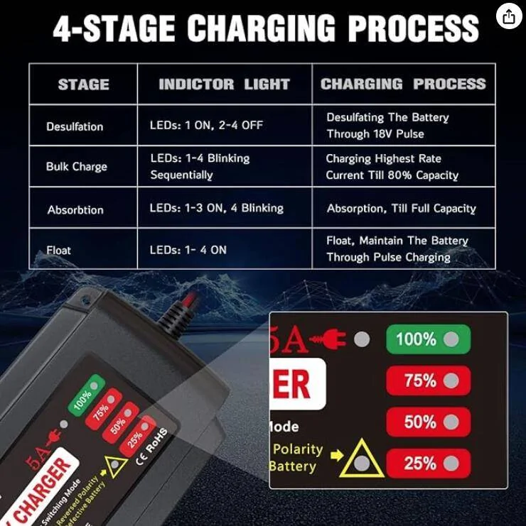

I tried to get 6.6 to install for almost a week with failures each time. Now I don't get the pop up prompt to install anymore, and when I go to settings the option to manually update is grayed out. Is there any way I can force it to attempt the update again?
You may be in the same boat I was in, with a failing 12V battery. While waiting for Ford to release the OTA hold, perhaps you should recondition your battery for 48 hours. This is the charger I bought:
BMK 12V 5A Smart Battery Charger Portable Battery Maintainer
Ford Mustang Mach-E How To Get Failed OTAs To Install 1703431789186
