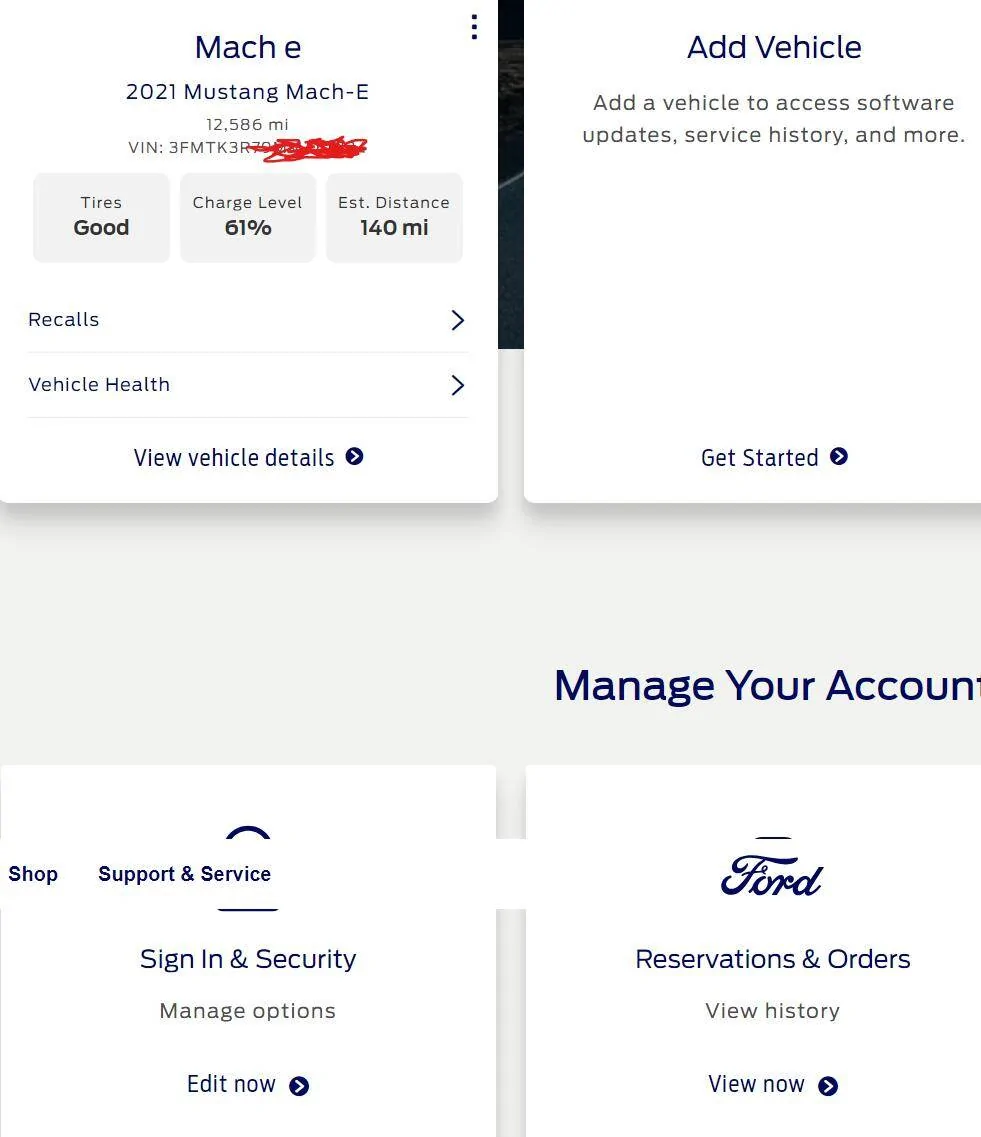

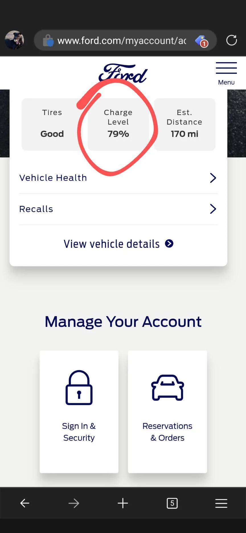

I have determined that this image displays the HVSOC and not the LV SOC Might I have a different version of Ford.com Dashboard?
Are you sure? Does the % match the FordPass app?
Still 12V reading for me.

I just deleted my last message. After updating my ford.com website, it no longer matched my fordpass app. You are correct it does display LV soc. My bad and my apologies.

That's fully misleading. I assumed that was HV battery also. I wonder how many questions Ford support has answered when laypeople ask why this number doesn't match charge level in Ford's app.
To their credit, how could the UI be clearer here? "Low Voltage battery charge"? Laypeople have no idea there are 2 separate batteries in the car. Plus, that's a lot of text to put in that small box on the website.

My assumption is that they were supposed to display estimated miles to empty, just like they do on the vehicle dashboard page. In other words, enjoy this defect until it's corrected!

Yeah, it's sort of a happy accident right now with all the OTAs going out until they eventually fix it (probably after the Holidays). For the first time, people are able to monitor their 12V status without special tools and use that information to intelligently charge their battery up enough to get OTAs to install. The theme I'm seeing is a lot of people had no idea how low their 12V battery actually was and how long it takes to charge up. Stuff I've been saying forever, but people finally get to see it for themselves.
We are pushing to have 12V SoC % permanently added somewhere like in FordPass.
