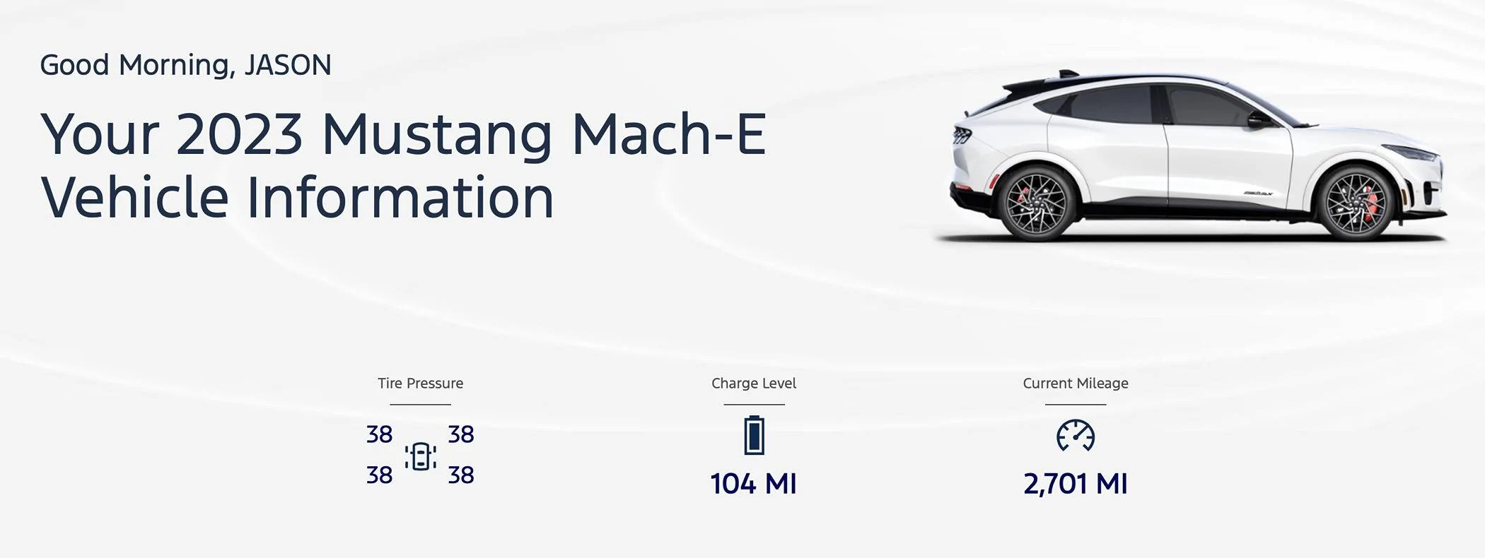

Jamers99
Jason
Mar 4, 2024
Tampa, FL
2023 Mustang Mach E GT
So how can I check the voltage level on my 12v battery. All I see it this.
Ford Mustang Mach-E How To Get Failed OTAs To Install Image 3-13-24 at 9.57 AM
