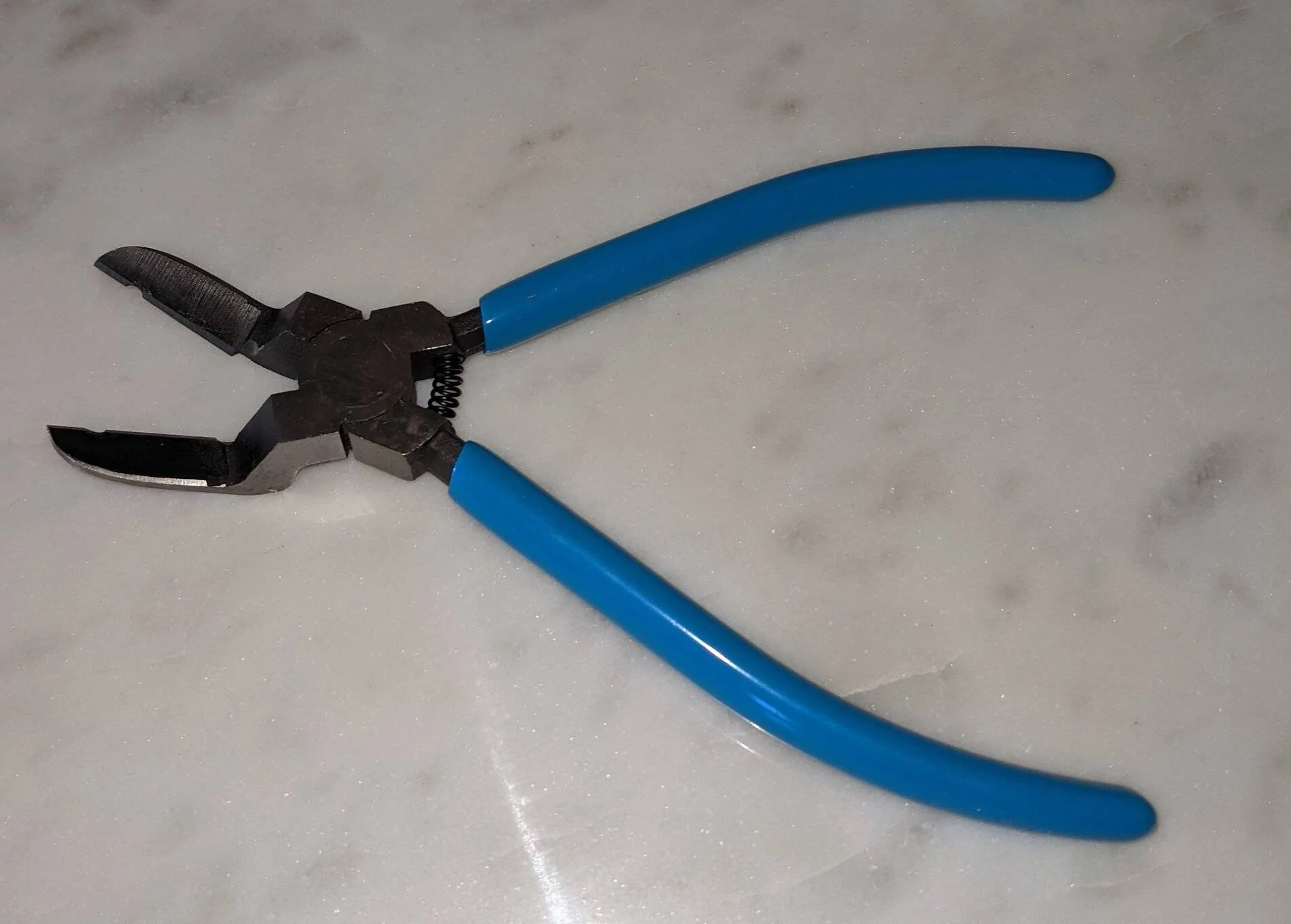

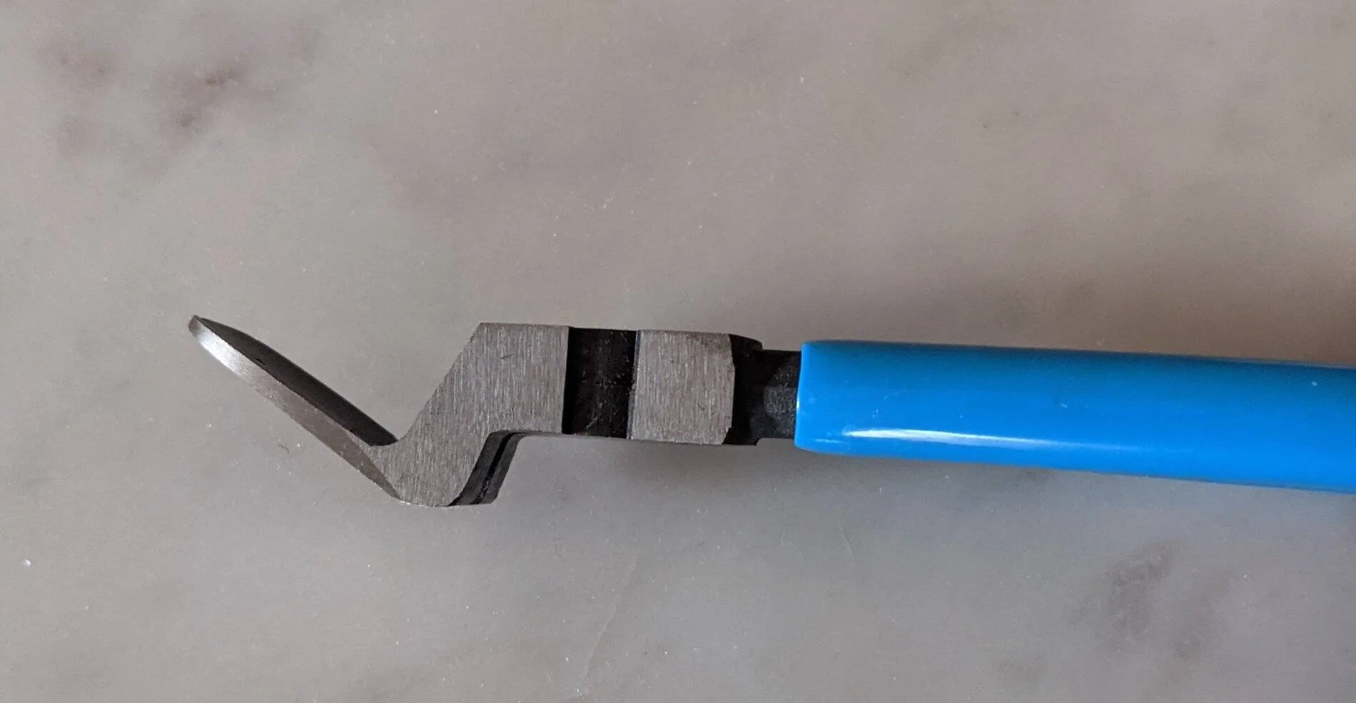

takes about ten minutes....
using a pair of stubby 'regular' screwdrivers and pliers, or an 'auto-fastener' tool to minimize damage to the (fairly soft plastic) fasteners.
You can re-install the fasteners, or get some new ones at a hardware store, to plug the holes. Or leave the extra drain holes and put some foam or Astroturf (my favorite) in the bottom of the frunk to keep cargo from sliding around and clunking when you are out there Drifting.... ;)
I used one of these "Push Pin Pliers" (bought at my local auto parts store) and it works like a charm.
