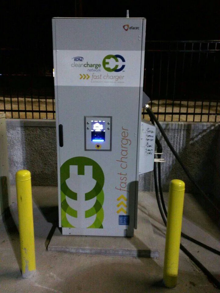

Ok, you’re correct, some of them are compatible (and this is my 4th ev, I’m a LONG time ChargePoint customer, as they are the most common ones here in KC, and I used them fairly frequently with my i3), but others simply won’t connect, like the one off 119th in Olathe (while the one a couple miles south at the Harley dealership works fine). I talked that chargepoint and they said they would require an upgrade.
Update from the other thread about the Kansas City ChargePoints. Looks like it's a known problem with the decade-old efacec chargers (pictured above)...
Yep, that’s what they look like.
https://www.macheforum.com/site/thr...e-odyssey-with-memes.4301/page-12#post-163190
Ford has released an update which resolved this issue
TSB 21-2190 Illuminated Powertrain Malfunction (Wrench) Indicator With DTCs - HV Battery Not Charging At Level 3 DC Fast Charging Station/EVSE | Ford Mustang Mach-E Forum - MachEforum.com
