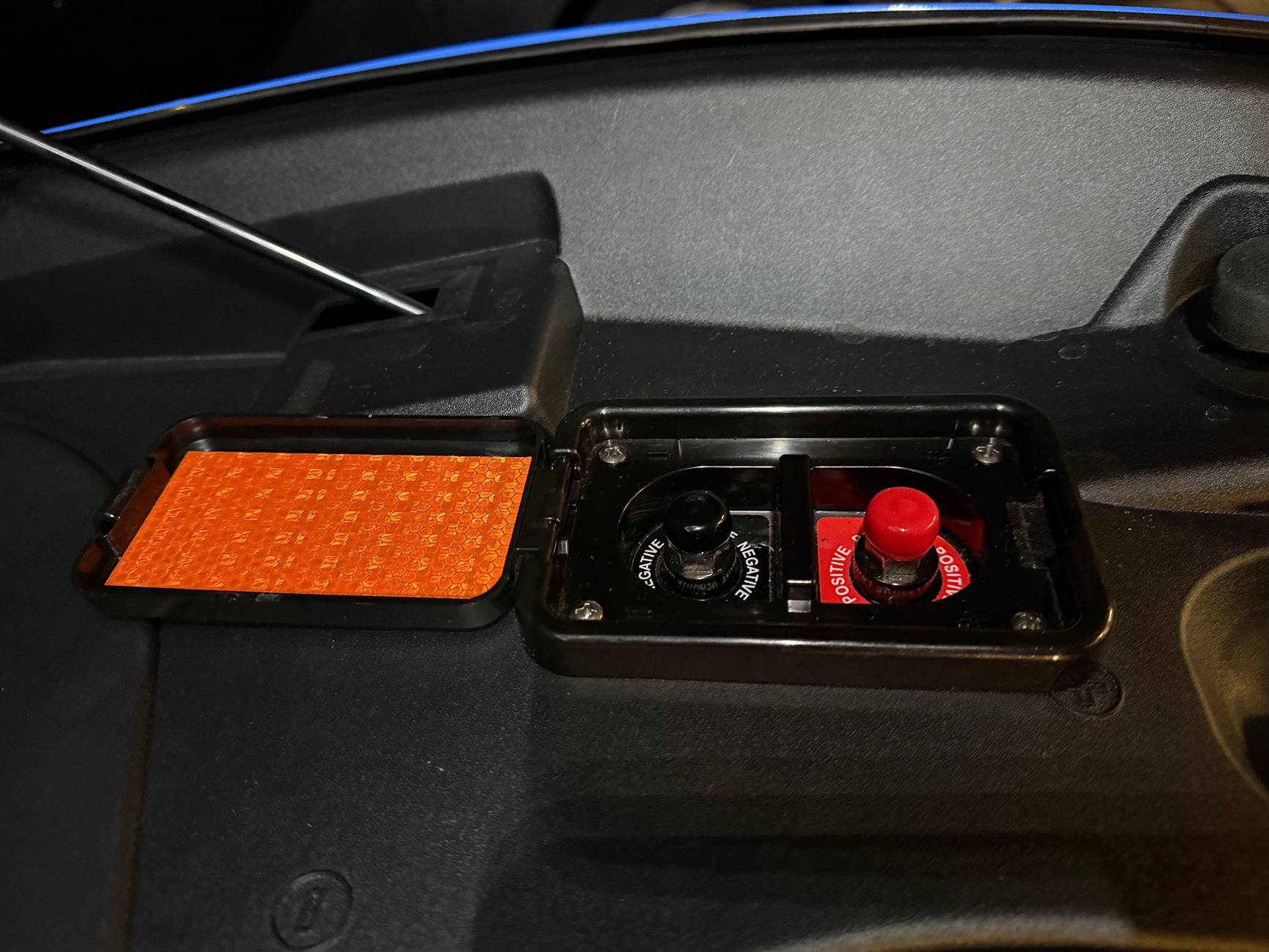

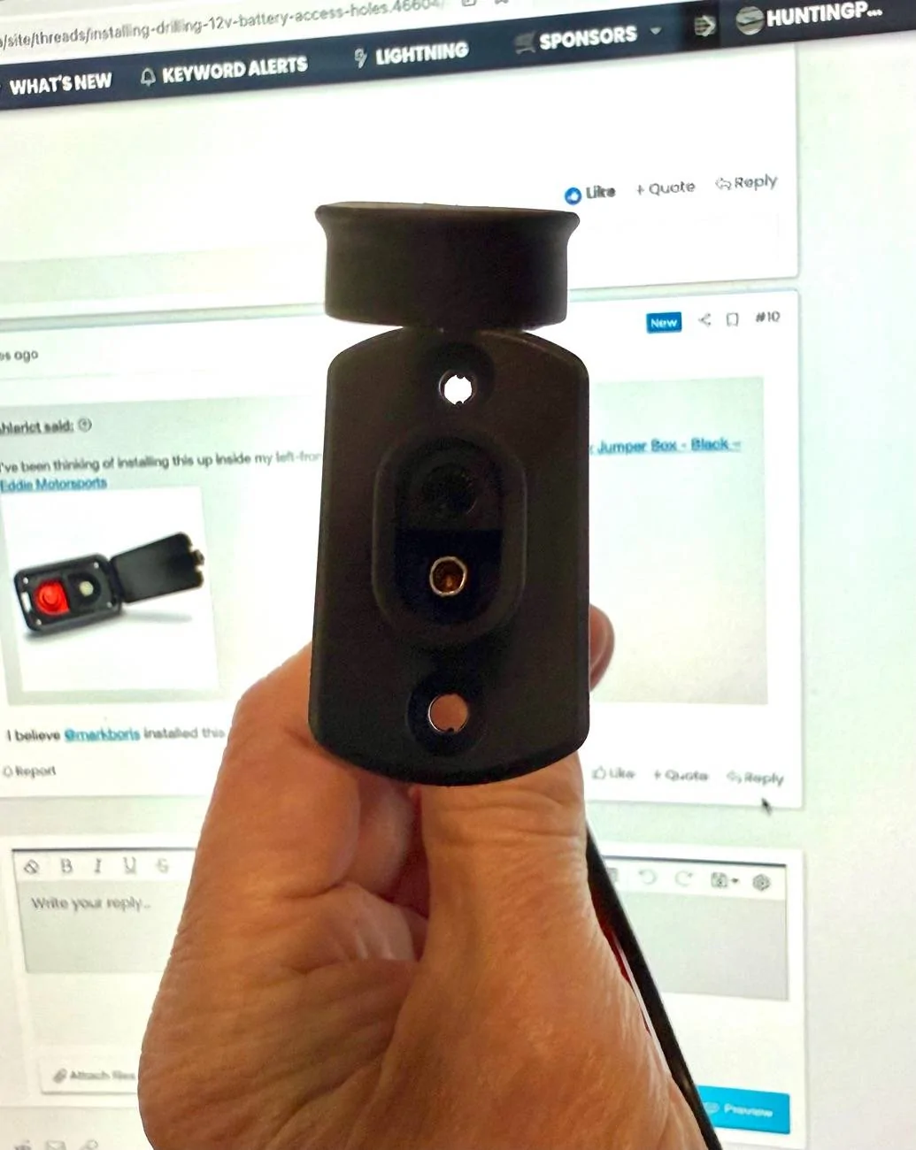

Naah, that’s too big to install in the charge port area. Mark installed one of these for his low current battery maintainer. ??
EDIT: I should note that I have been a lazy dog and this thing is just sitting around here. ??
That’s why I said “or similar”. ?

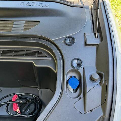

I second using the template. It positions the holes slightly off center of terminals but in a better position to see the -/+ signs. This is the second Mach-e that I do this to and it turned out perfect. You can hardly tell that holes exist. The holes are 2.5” and wide enough to connect the charger clamps and shut the hood (which is important to me cause I park in a high rise building garage).
here’s the link to the template:
https://www.macheforum.com/site/thr...point-access-battery-access.10976/post-290201

I notice the Ford techs use the LVB access holes I installed during the 10K mile checks. Glad it makes their job easier. I didn't remove the panel when I cut my holes. I drilled 2 1/2" holes and used these seals.

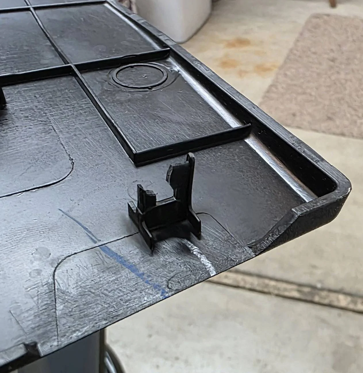

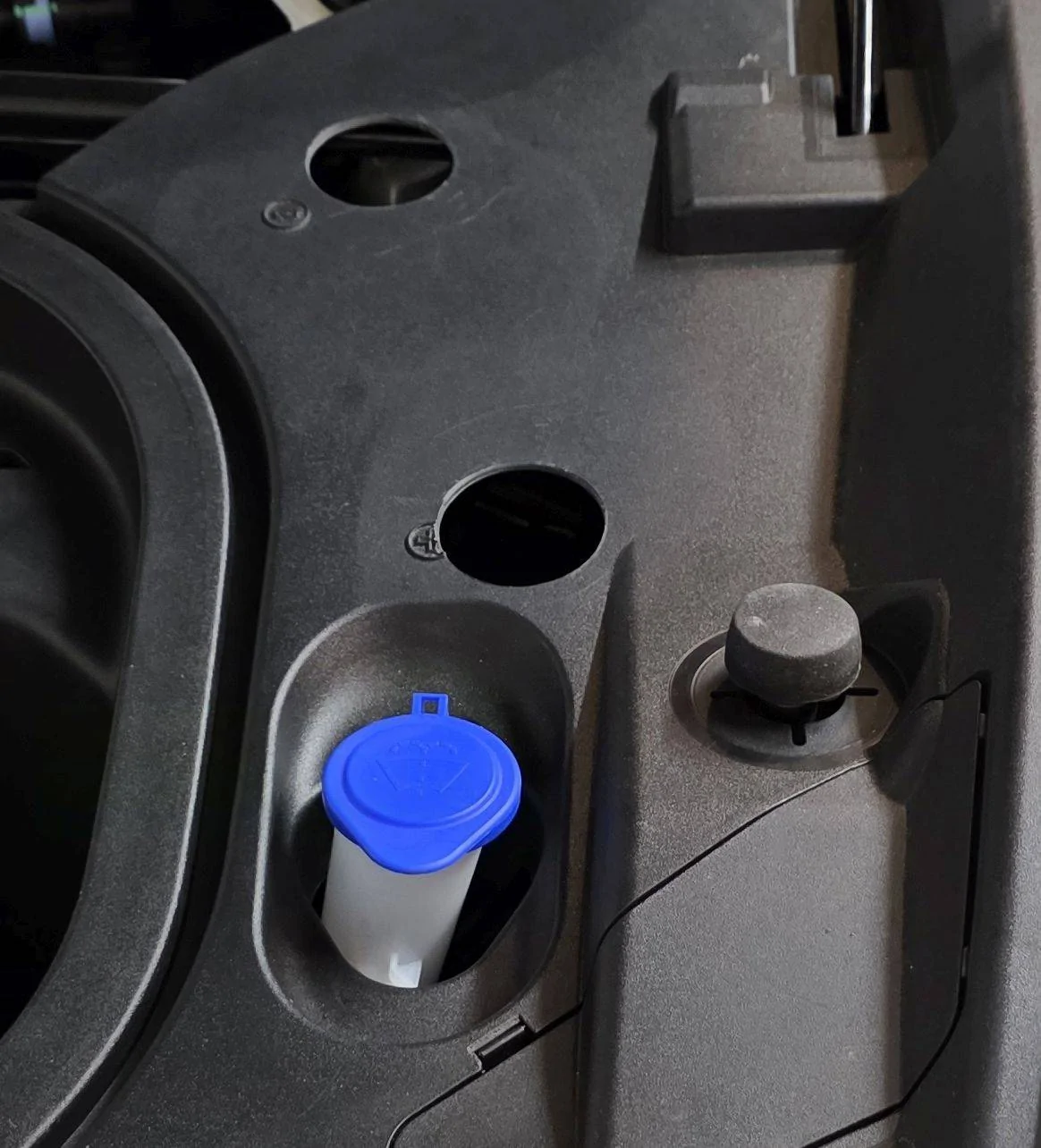

Well I finally got around to drilling access holes for my 12V battery access terminals. Having previously installed a BT battery monitor on the 12V battery, I had already learned how to remove the plastic covers by watching this totally unrealistic YouTube video (it's just a short clip to show how unrealistic it is, it's not the full video).
So I forged ahead with cover removals but of course this time it didn't go as well...I broke one of the end clips on the top cover. I not only irretrievably lost the clip down its mating hole but I tore the clip mount all to shreds. (photos) Maybe I unknowingly damaged/weakened it during prior removal? Welp, nothing I could do about it, so...
Continuing on I cut out 2-inch holes directly over each remote battery terminal (photos) and plugged them with these covers from Amazon. The color and texture of the plugs look like an exact match to the color/texture of the cover they're installed on, and they fit well and hold firm but are easy to remove.
Finishing up, I re-installed the top cover back in place without the missing clip, it seems OK. My only concern is I don't know what's down there and I just hope that loose clip doesn't find its way into some module or ???

you will be fine without the clip.... it's probably sitting in the belly pan

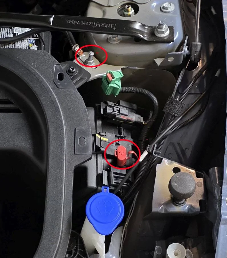

BTW, you REALLY should add a third hole over the HV disconnect now that you have the process down.
