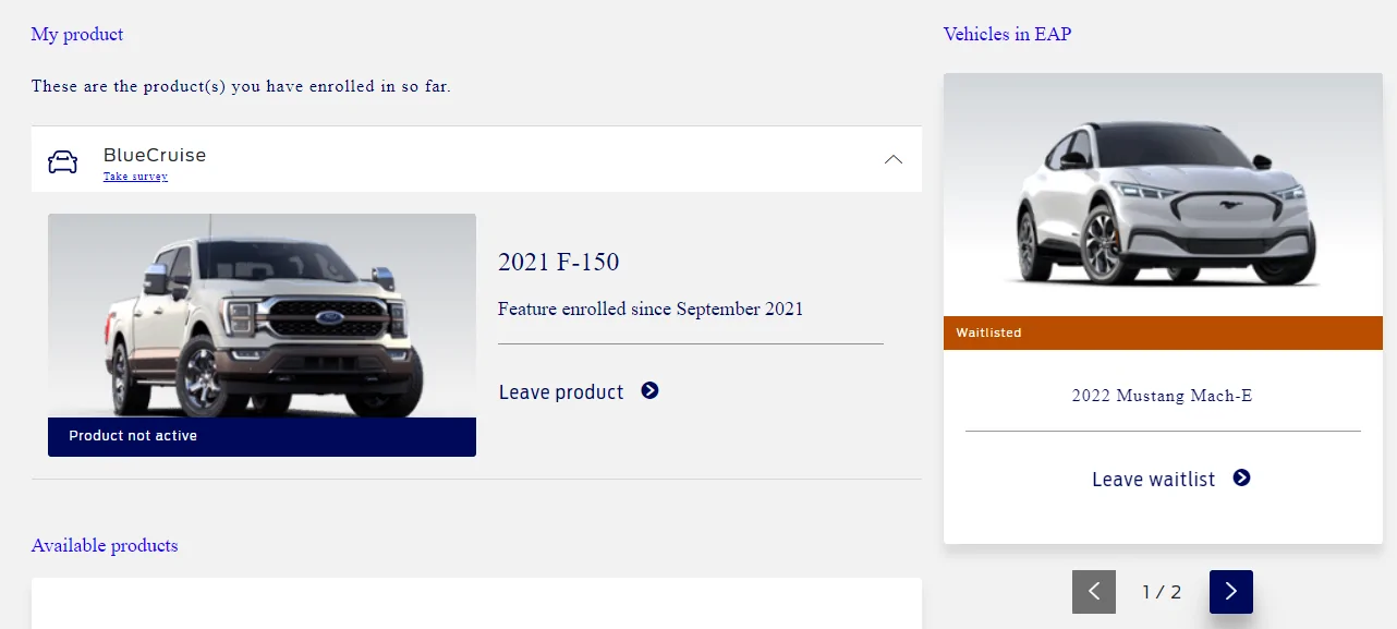

Hadn't heard of this feature until just now but the results are hilarious. I decided to check whether I was enrolled in EA like I assumed I was but looks like it is per vehicle, not the person on the account. So I had to join the waitlist for the MME.
Ford Mustang Mach-E Intelligent Range now being enabled on Early Access Program Mach-E 1662496405389
Anyway seeing these reports I would not enroll my wife's car in it because it might freak her out. In our MME (ER RWD) the GOM miles is generally %SOC x 3 so I could always compare to that in my head but she's not going to be doing that. I'll just monitor this thread as entertainment and get updates.
