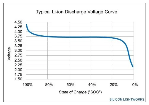

Ultimately the question what to charge to depends on if you plan on keeping the vehicle. The performance falls off at lower states of charge. Given the ~5% walled off upper limit, 90% is acceptable as that's closer to 86%. If you plan on keeping the car, 25-85% will provide the best long-term health. Every few months a 100% charge is good to top balance the pack. This graphic shows how a top balance is beneficial in bringing all cells back to capacity. Without an active balancer that can move charge between cells, any cell that's got a small variation in resistance can over time end up under utilized skewing the SOC at lower charge states. The curve is quite flat and cells can show similar voltages, but have much less capacity left in them. When top balancing, the BMS basically connects the higher voltage cells to a resistor that just bleeds away their charge while the other cells continue to receive energy.
Ford has loads of data on this and I'm surprised that they don't already prompt those who use lower charge thresholds to top balance on occasion.
