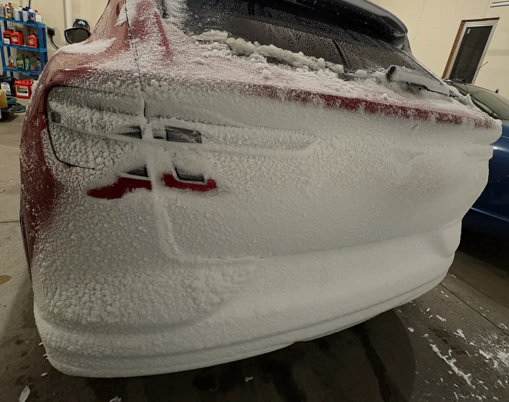

You are making me cold just looking at that. :wink:
