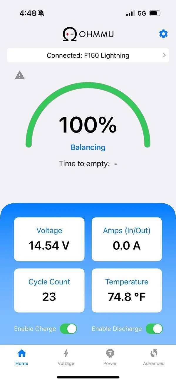

My experience with the Ohmmu battery is different than this. Have one in the MME and one in the Lightning.

Est. 3 months on Lightning, 1.5 months on MME.
Pulled the trigger when others have reported 1.5 years on the battery on the lightning board.
Wanted:
- Deep cycle capabilities afforded by lithium
- Blue tooth monitoring of amps, volts, SOC
- Ability to turn off the battery without a wrench (wife cannot do that if needed, but can navigate the app).
So I’m early on the adoption curve.

No codes since battery installed.
Has not prevented the lightning from starting a power draw at midnight occasionally. That will normally result in the power draw screen with the SOC dropping below 50%.
When you install the battery:
1) Update the battery firmware via app
2) Set the battery profile to the vehicle you installed it in (MME or Lightning) via app
3) When battery is fully charged (you should do this before install), reset the Ford BMS using methods you can google up:
- Accessory on
- Flash brights 5 times
- Press brakes 3 times
- Wait for battery icon to flash
- Accessory off
