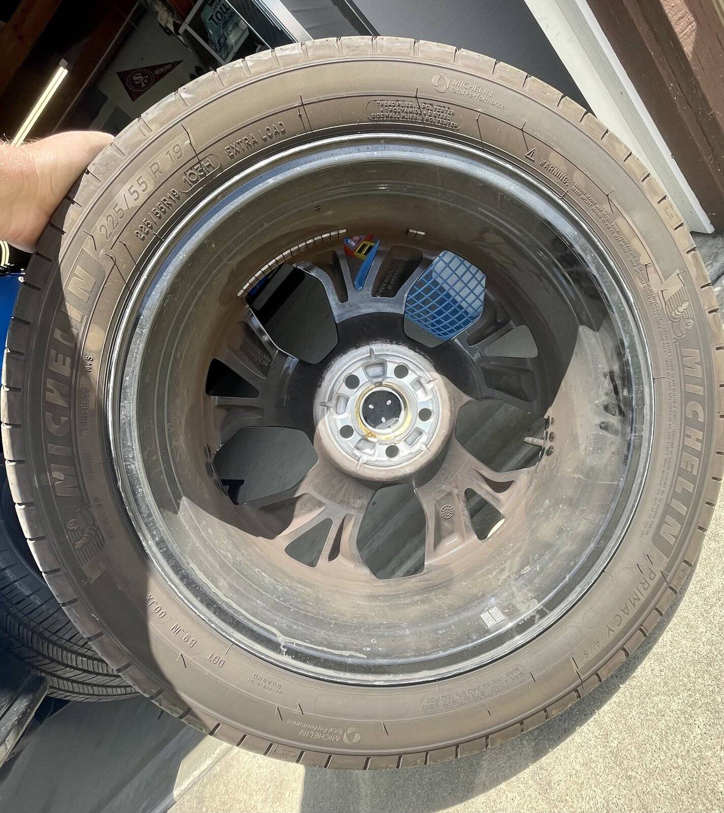

This is what the inside of my wheel looked like at 6200 miles. Lots of excuses for why I never really got the inside clean but clearly I saw a lot of brake dust on the front wheels after 6200 miles...

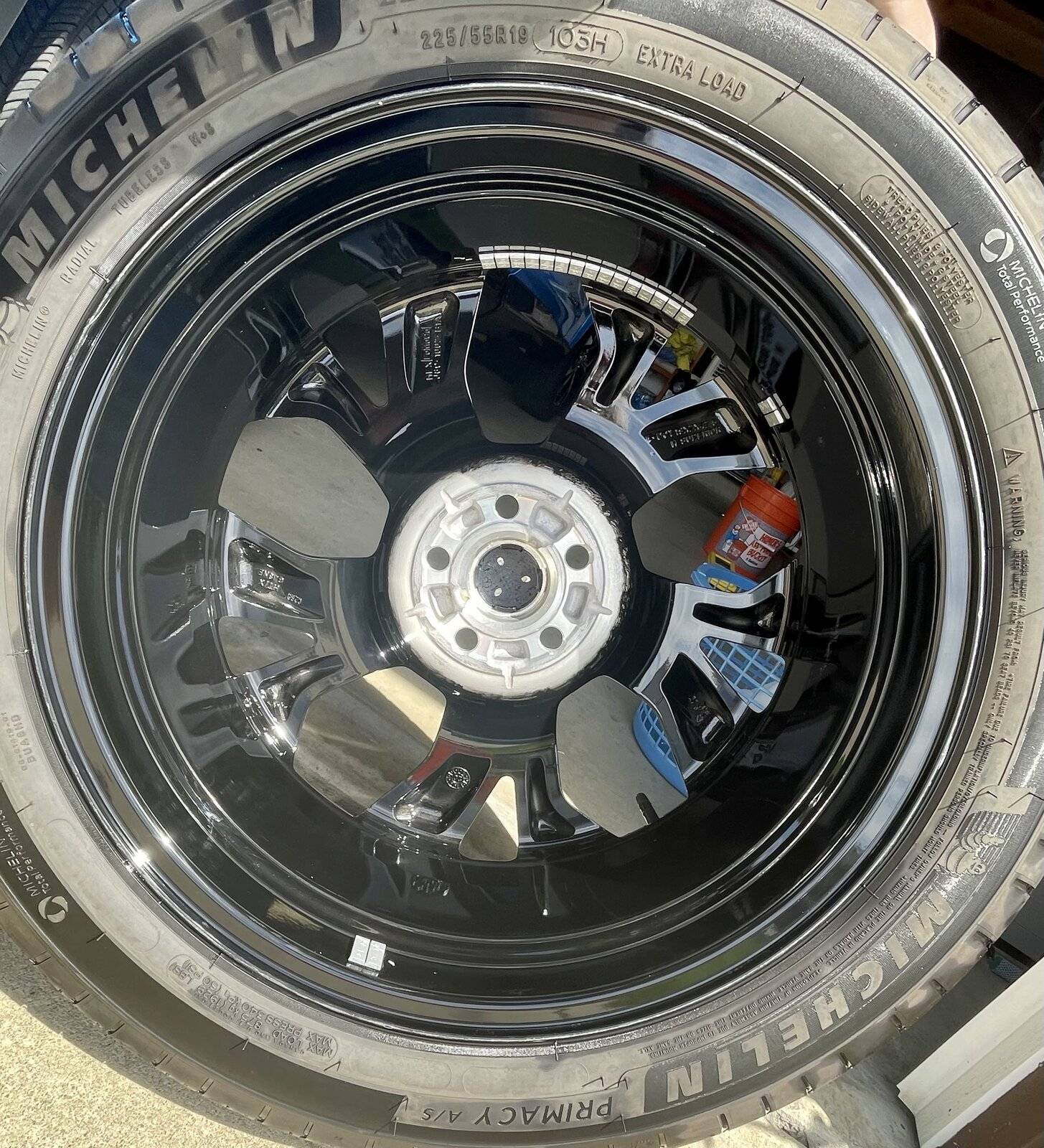

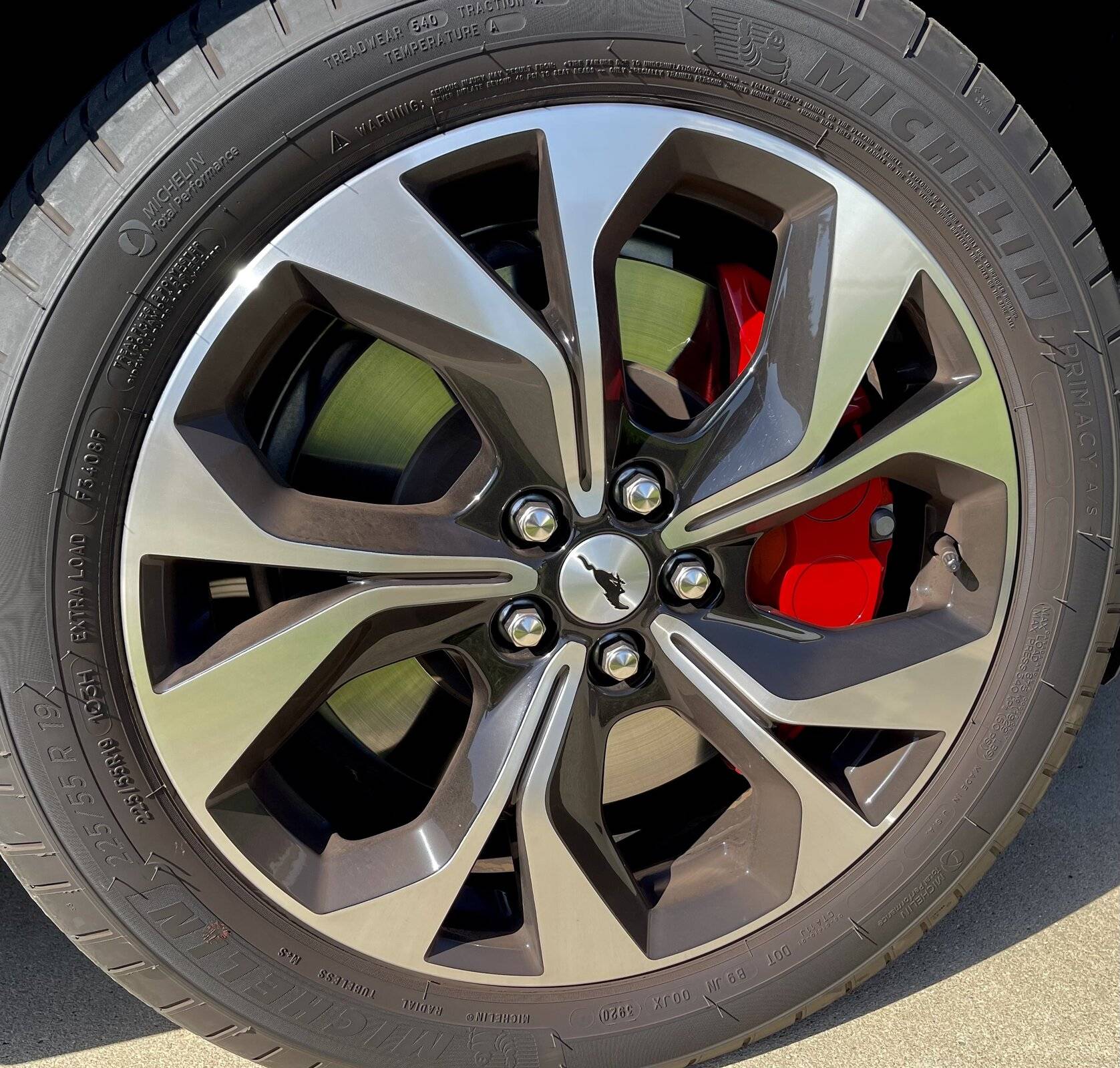

All cleaned for before a very long road trip to TX...
Ford Mustang Mach-E Mach-E Brake Pressure Data for Each Drive Mode IMG_0124
After a 3200 mostly highway trip to TX and back...
Ford Mustang Mach-E Mach-E Brake Pressure Data for Each Drive Mode IMG_0163
Around town I use 1PD on the highway I usually turn it off and I can say with good certainty that on the I-10 to TX and back I didn't have to use the brakes all that much.

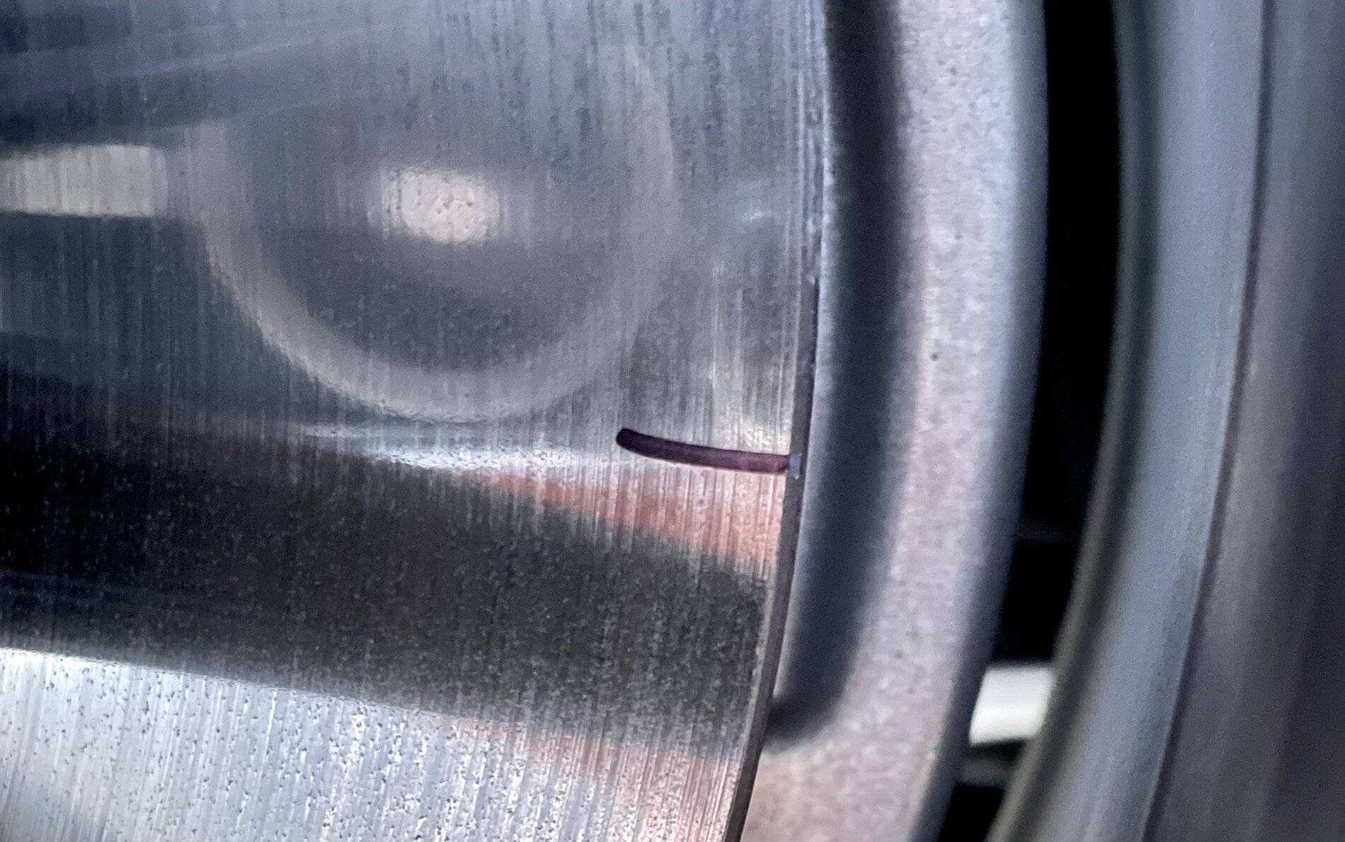

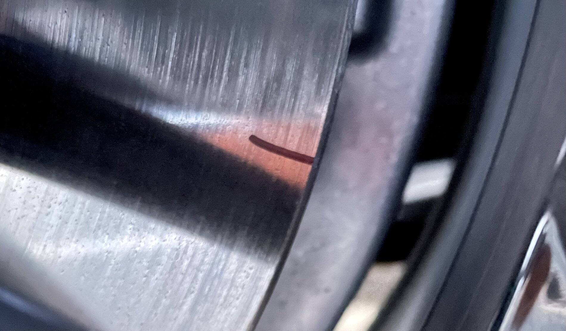

First, the sharpie test. I put a sharpie stripe on my rotor, and then did two 1PD runs up to ~60mph, and then let off the pedal completely and let the car slow me to a complete stop. One in Engage, and a 2nd in Unbridled. I came to a complete stop each time, and I did not touch the brake pedal.
The sharpie mark stayed intact through both runs. However, after doing a friction brake test the mark disappeared almost completely (as expected). After driving 10 miles home after the test, the mark is still just barely visible, it seemed my friction test was the main thing scrubbing it off.
Before:

After 2 runs:
Ford Mustang Mach-E Mach-E Brake Pressure Data for Each Drive Mode 2E0B7E6C-66AD-470D-A7A3-3D9E01AF83B4
From what @Mach-Lee said from the FDRS tests, I was listening closely and I could hear the friction brake come on after coming to a stop (but it didn’t rub my mark off because the vehicle was already stopped). I did NOT hear the parking pawl, but I did hear it when switching to P after the tests.

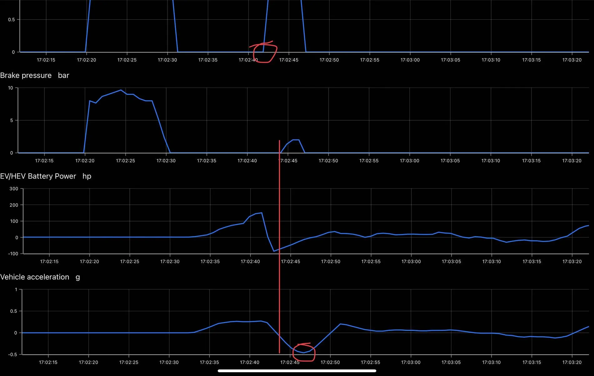

In another run, I was going about 50mph, and slowed down by applying the brake pedal. I gradually increased the pressure on the pedal until the friction brakes came on. Interestingly, as I approached 100kW of regen, that is when the brakes engaged. I was waiting for it, but I could definitely hear and feel the brakes coming in - it does not feel the same as regen. It also coincided with the brake pressure PID increasing.
See the below screenshot - the top line got a bit cut off, but it is the Brake Light Switch, so that tells you when I started depressing the brake pedal. You can see regen power increasing on the Power line, and as regen gets to 100kW and my acceleration drops to -0.2g, the friction brakes come in, pressure goes up, and my acceleration drops to nearly -0.5g. This was not a panic stop, just a firm slow-down.
Ford Mustang Mach-E Mach-E Brake Pressure Data for Each Drive Mode B906FA7F-663E-430C-8482-480AA5297308
From all this, I’m still standing by my original claim that 1PD does not use the friction brakes, unless you are already stopped (as confirmed by @Mach-Lee and @breeves002), or unless traction control, collision avoidance, or some other system is taking over (still needs some testing).
