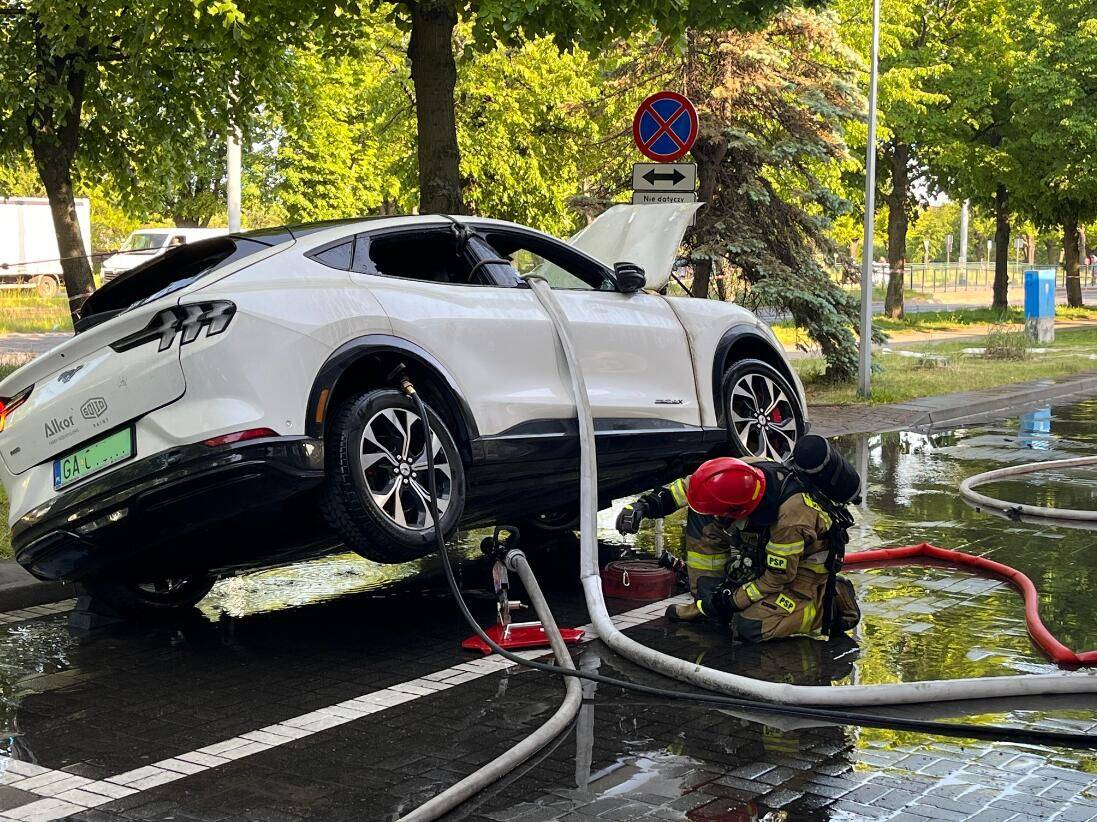

Well, if it wasn't the battery than I don't know what could have burnt like this.
Source: https://strazacki.pl/akcje/foto-szczegoly-wczorajszego-pozaru-samochodu-elektrycznego-w-gdansku

Whether or not it was the battery, they definitely were taking all the proper procedures
True, and you’d expect nothing less of them, whilst they’re not able, equipped or are given sufficient time to forensically investigate the cause of fires, they are amazing committed professionals keeping us safe in this world!
God bless them for doing something I’m not brave or strong enough to do.

electrical fires are best extinguished with foam/chemical spray to cut off oxygen.... using water is generally not effective as they rarely have enough volume.
with the flames coming out the back initially..... maybe the motor, or a bad connector ?
This is actually not true.
Battery fires are NOT electrical fires. They are thermal runaway events which generate heat. Covering it with foam isn’t going to stop a runaway event. It needs massive amounts of water.
I absolutely love this firematic setup. Looks like some speciality equipment and they knew exactly what to do and was hitting it from multiple angles
