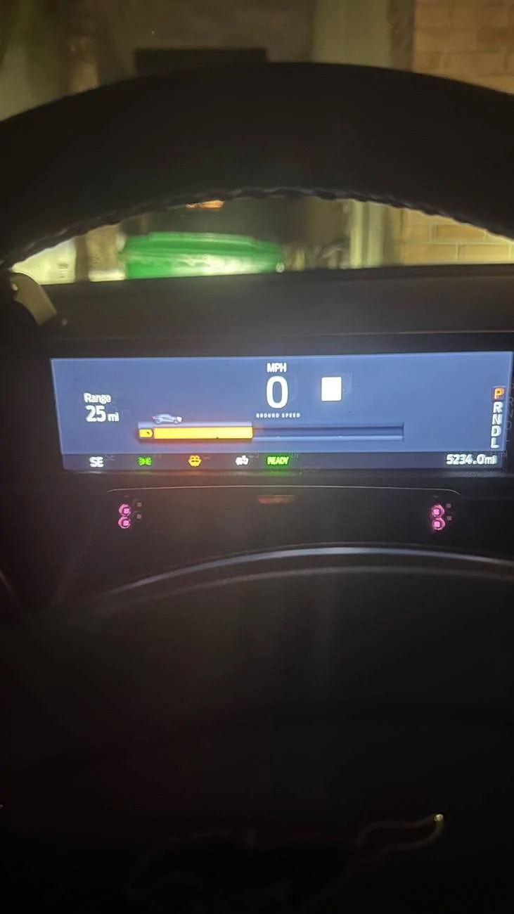

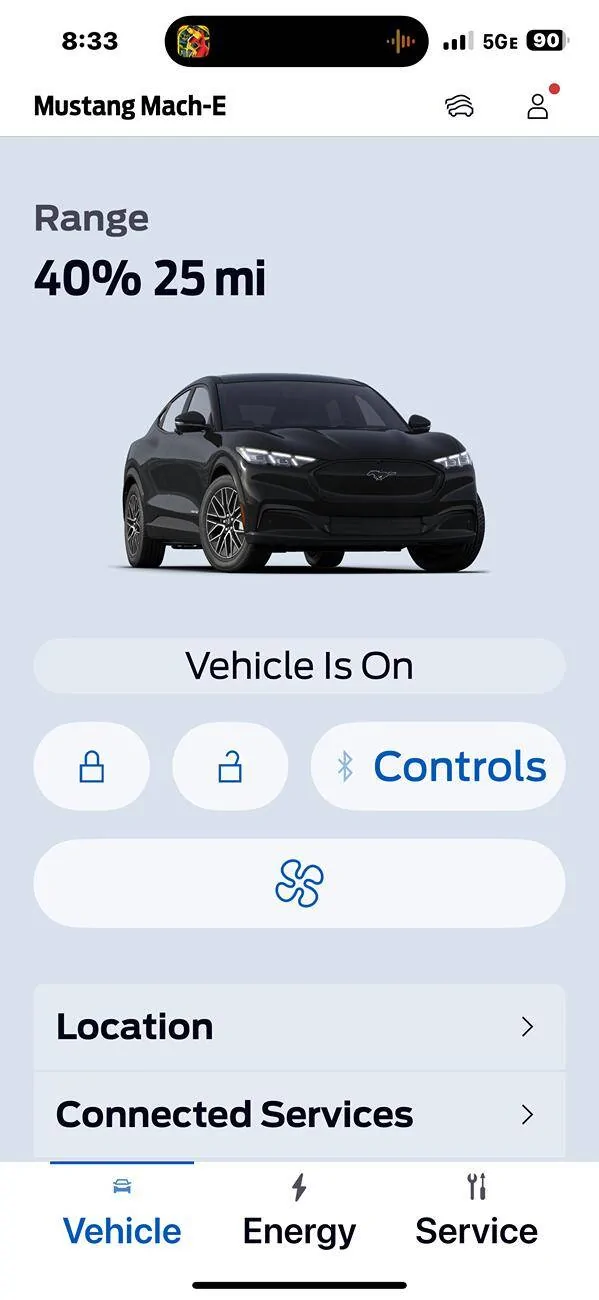

Let me add to that that it will still display for example 65% charge but only 49 miles available when only minutes before it showed 65% charge with 156 miles available.
Which battery do you have? Standard or extended? And when was the last time you charged to 100%?

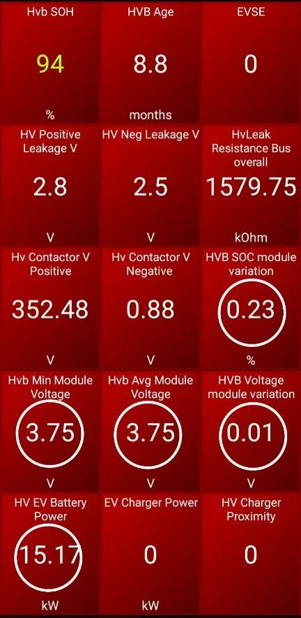

If you have Carscanner, can you go to the dashboard pictured below?
Capture a screenshot at some SOC when the car is behaving normally.
And then capture the screen, hopefully at a similar SOC, but with the GOM being out-of-whack, so to speak.
Ford Mustang Mach-E Mach-E. discharging 20250118_155704
I'd be really curious what the circled values would be.

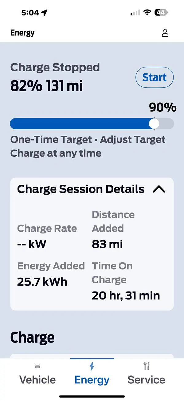

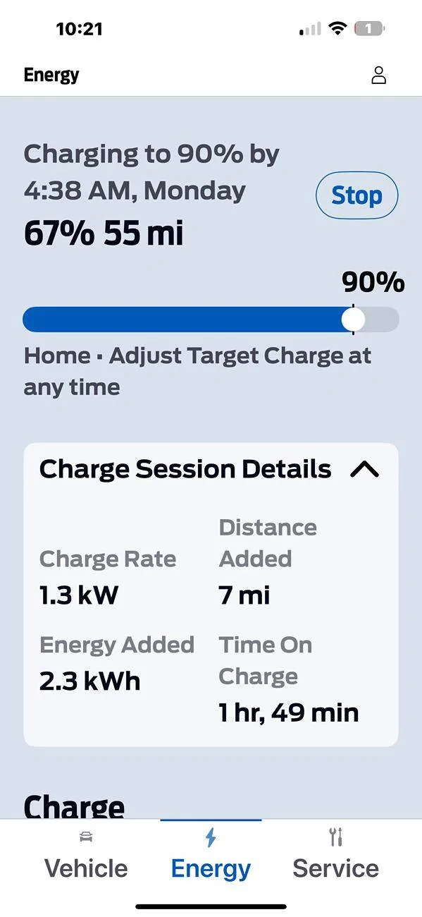

Yesterday when I dropped from 159 miles down to 55 at 67 % I charged it till just now and these two pictures are below
If you look at the Carscanner information in white circles, those values are not going to be reflected anywhere inside the car, or in FordPass.
What I'm curious about is how much deviation in voltage there is between HVB modules. If the deviation is miniscule, then at least you could relax that your issue isn't a HVB cell failure.

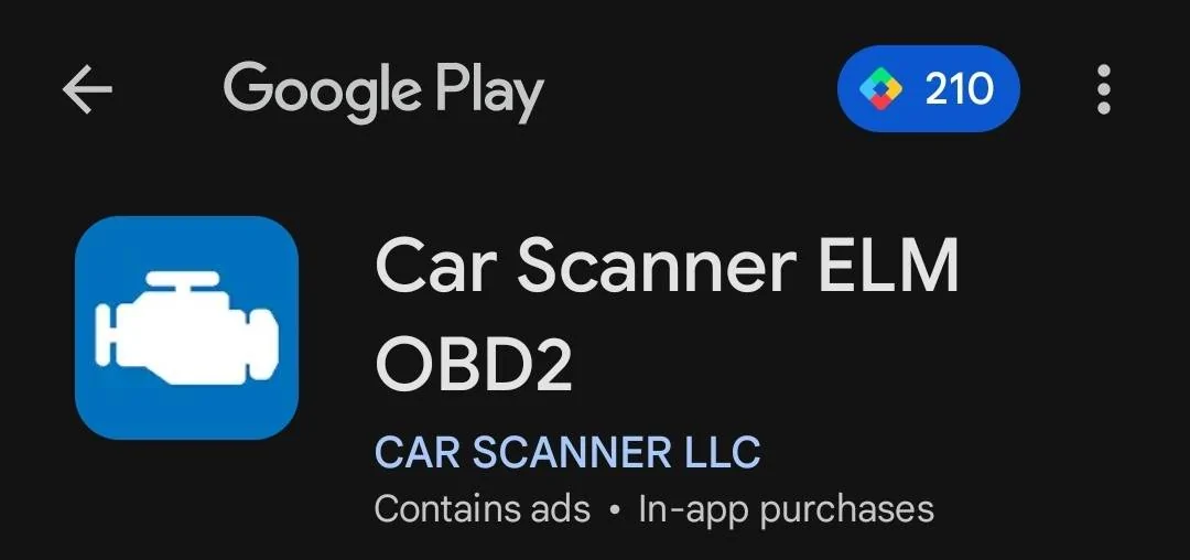

Carscanner is an app for smartphones.
And has a rather robust set of dashboards for the Mach-E, reconfigured.
