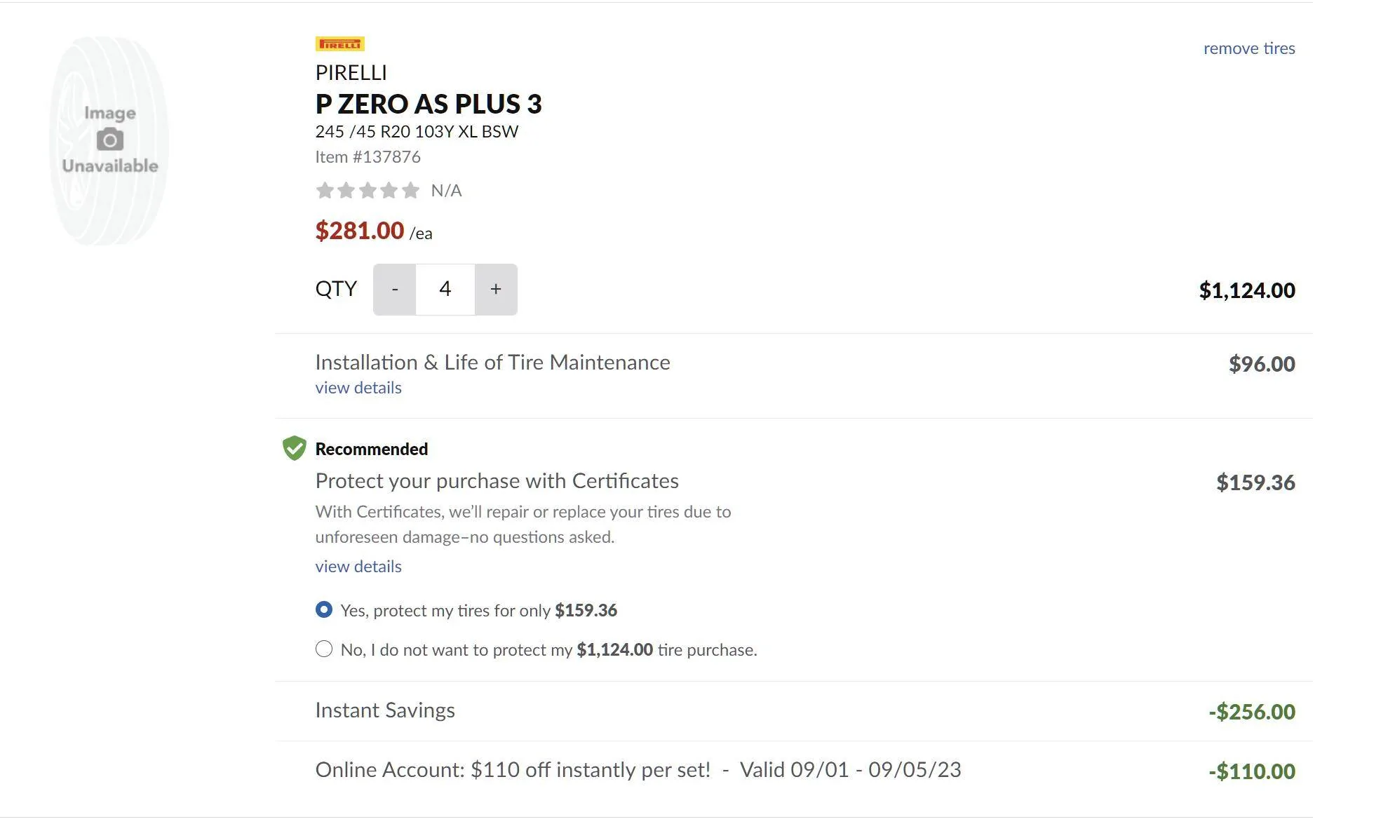

OP should take the tires to a Pirelli dealer.
It's interesting that people complain about the soft rubber of the P Zero's, when the entire purpose of the tire is to adhere to the road to get the extra HP that the GTPE provides without slipping. By default, that means a sticky, soft tire. That is the sole reason that these tires are on the GTPEs.
When I saw the video of the Ford guy with Leno discussing the tires as they drove, I knew it was going to a very low mileage tire, no surprise there.

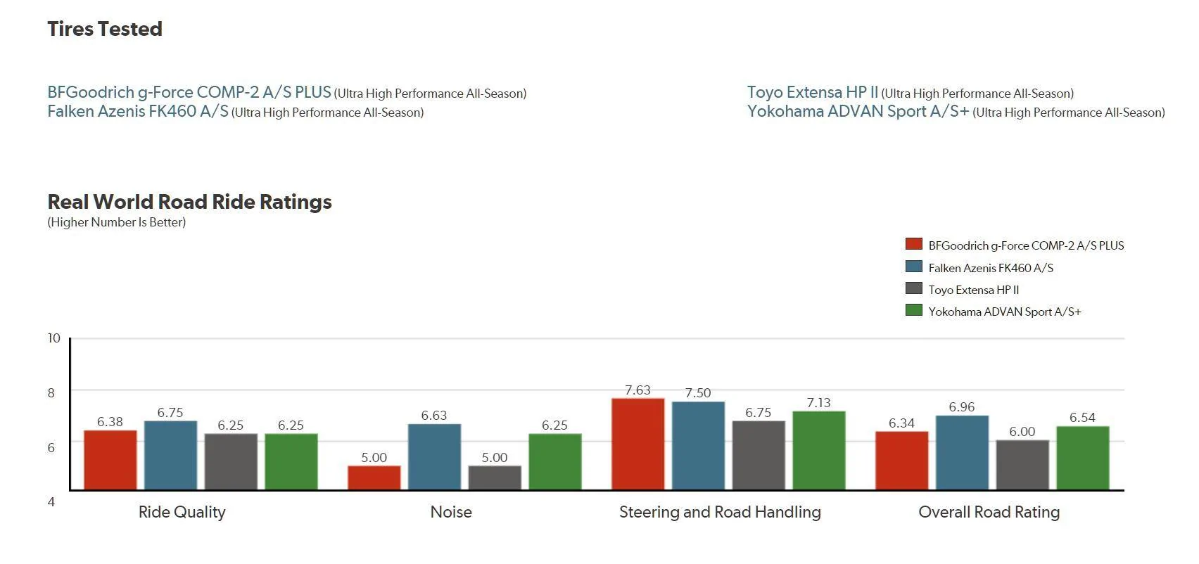

Interesting. may I ask why?
Comparative testing from tirerack has it bottom of the list of a B to C tier UHP A/S tire group.
Main complaints are comparative noise, handling, and wet grip. From tread pattern features it looks like it would be terrible in the snow. Discount customer reviews have it rated a 2.2 out of 5. (rated considerably better on tirerack owners but I trust their professional reviewers' opinion much more so than biased owners)
From all observations it appears to be a tire that would excel in a market vacuum with no alternatives at a similar price point.

Eh, the actual hard numbers look pretty decent, I mean the ones that aren’t somewhat subjective. The Toyos thus far seem good to me. Again, that is also my subjective bias. Ride quality is nice, and they seem more quiet than the OEMs.

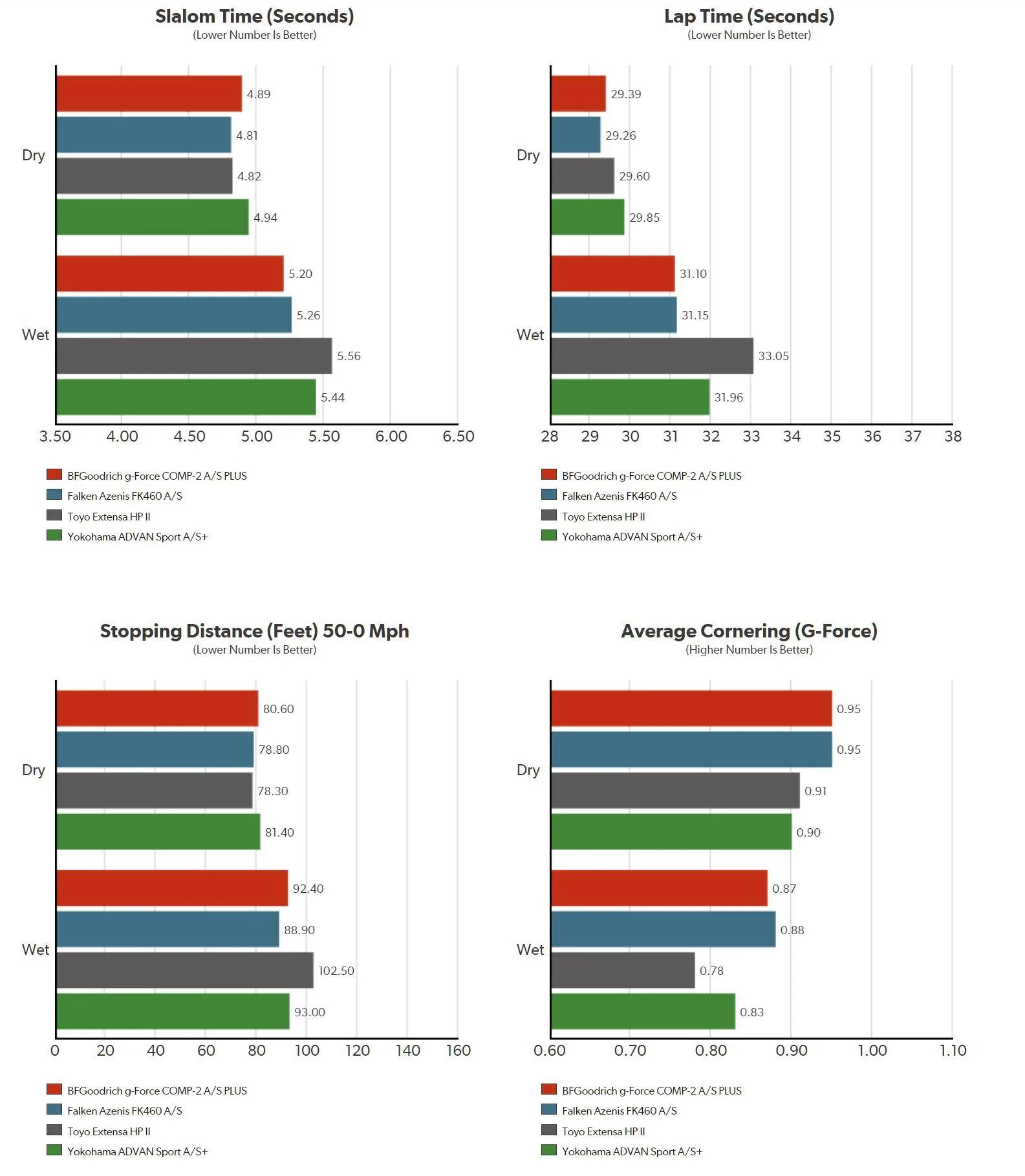

Are we looking at different numbers? In the dry, its straight line stopping distance was the only area it beat out the others with pretty close results all around. Not really a compelling argument either way there...that's a toss a coin....except when you get to cornering grip. Then you're looking at a .4g drop. That's pretty big....and you'll notice the understeer compared to others. So from my perspective that's an L in the dry numbers.
But then you get to the wet. Not even close. Slower Slalom, different category lap time, atrocious stopping distance and downright pathetic cornering grip.
I'm sorry but there's no way in hell I'd look at these number and be like...yeah I'd buy those. I'm glad you're happy with them...but going back to my other statement, I'd pick probably 10+ other tires first because they are just going to be a better tire in most categories.
In this group of tires I'd be going with the Falken FK460's. Those look very strong...and pricing is very good on em too.

Here's a very timely and great video that highlights what I think are probably the best options out there. Pricing wise there's a big discount on the Pirelli PZero AS Plus 3 that is making them cheaper by a couple hundred over the Falken 460A/S, for example. ~1100 vs ~1300. With the current pricing, if I were to buy tires today, I'd buy the Pzero AS Plus 3 from discount.

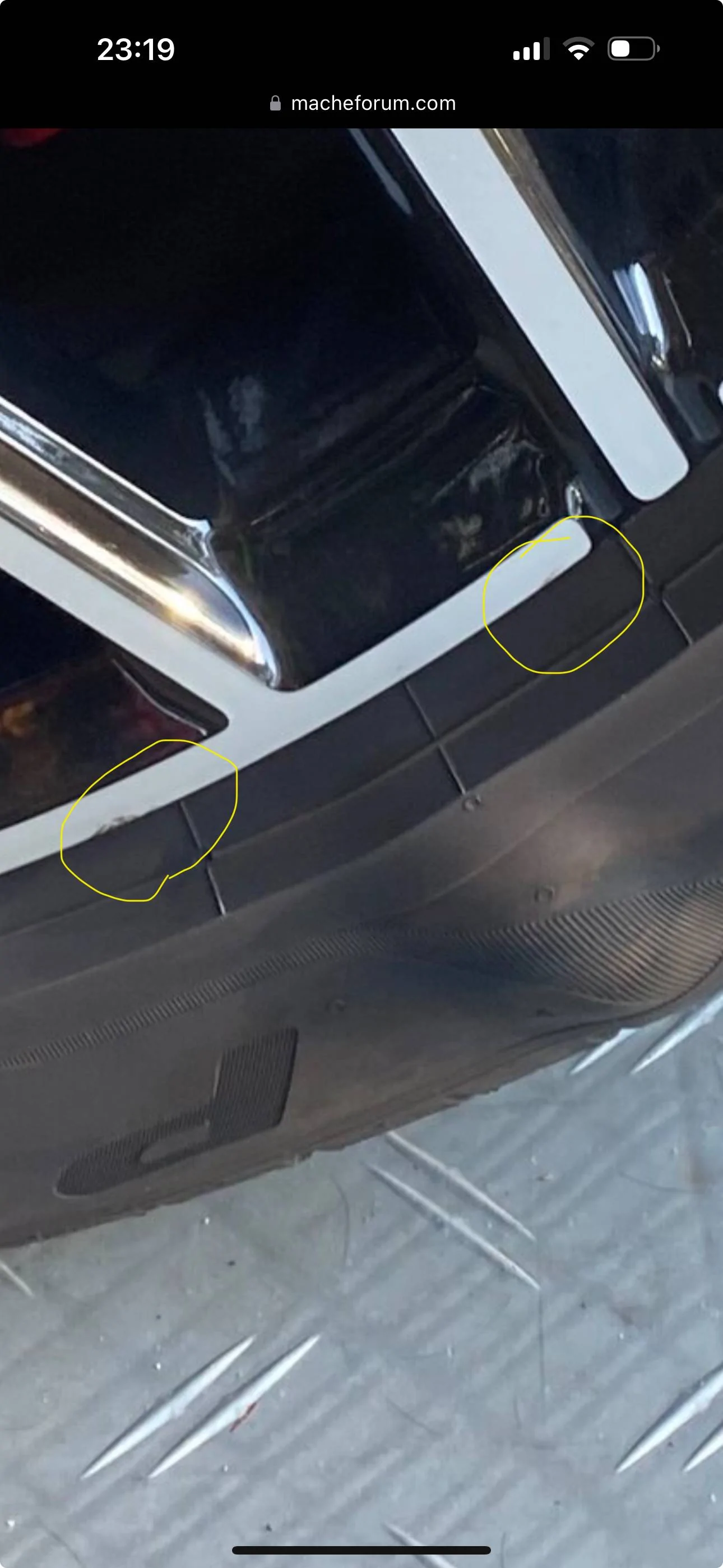

It’s definitely impact damage, there’s rubber transfer on the wheel rim in two places.
Therefore, I’d recommend not to drive until replaced if not already done, that bleb could blow at any time with disastrous consequences, is illegal and I’d have the 4-wheel alignment properly checked - track/toe, caster, camber, KPI/SAI, thrust angle, setback - misalignment could be a symptom of damage which needs new parts or more likely just adjustments if possible.
Running with misaligned wheels comes at a cost penalty in premature tyre wear and economy/range.
