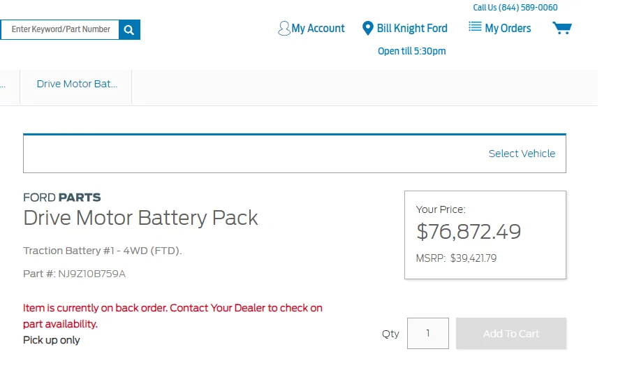

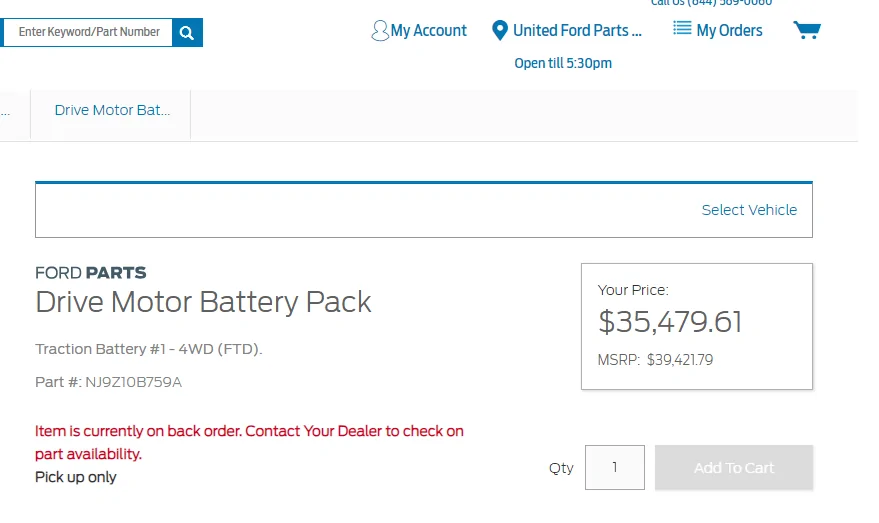

You can look that part number up on Ford's parts website and look at the cost of the part at each dealer. They set their own pricing. One dealer near me has a near 100% markup over MSRP on all their parts. While another dealer has them under MSRP.
so that dealer probably prices it that high so literally no one will go to them for a battery replacement.

We loved our 2021 Mach E. About a month ago I ran over a small median when making a turn. A couple of weeks later we got the Powertrain Malfunction/Reduced power alert, but the car seemed to work fine. Took the car to the dealer last week and they found batter acid on the back side of the battery pack and said the car was not drivable. The dealer quoted $63,000 (the line item cost of a new battery pack) to replace the battery. No labor cost (thanks) because the car needs the HVJB recalls so the battery needs to be dropped anyway. Crazy. Needless to say, we had to take the market value of the car from our insurance company. Not really strong data, but the insurance adjuster said he only had to total one other electric car for non-collision damage and it was a Mach E. Loved the car, but I don't think I am buying another one.

Thanks - I talked to Ford and its clear the dealer does not want to deal with it. Ford's stance is the dealer can charge whatever they like for the battery pack. Weirdly, the dealer that quoted me in writing at $61,789 for the battery pack has the battery pack below MSRP at $35,479 online.
Finally got the insurance pictures. The bottom cover of the battery definitely has some impact and the insurance company decided to total the car. I am not clear there is any damage that is preventing the batteries from working. There is no liquid leaking from the battery pack. Apparently, the tech was worried about acid leaking because he saw paint peeling on the rear panel of the battery pack (huh). The batteries are functioning fine and still at 85% charge.
Either way, I can't drive the car on the road if the insurance company totals it so I am kind of stuck :(. Not sure, I can get insurance on the car, if the insurance company thinks the car is undrivable.
