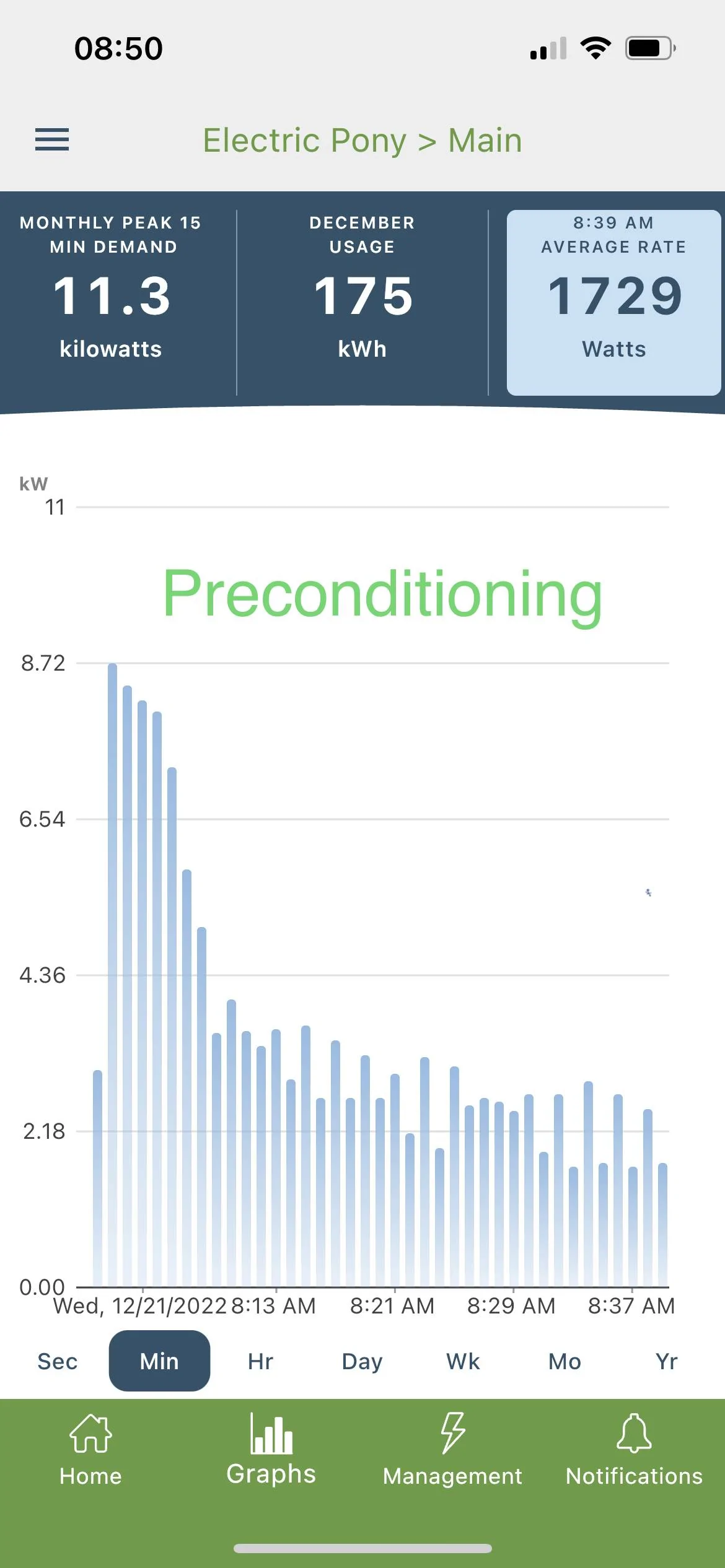

I preconditioned for the first time yesterday, set up for an 8:30 departure, battery was at 59 deg, cabin was toasty, and got my cabin nice and toasty. Temps were mild compared to you guys, it was about 28 deg F outside, 40 deg F in the garage. My EVSE said it took 44 min, and 2.53 kWh. At my rate of $0.1134, it cost $0.29 to do this. Well worth the price of preconditioning!

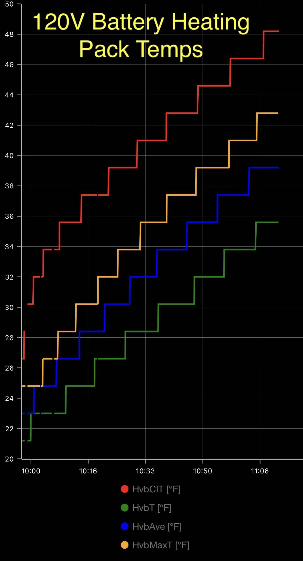

Today's tests are regarding 120V battery heating and preconditioning.
120V Battery Heating:
I plugged in 120V while already at my 85% charge limit, and battery heating began. However the coolant heater was limited to only 1.1 kW instead of the normal 6 kW. As a result, the battery heated very SLOWLY. It took 1 hr 15 min for the battery to heat from -6ÂşC (21ÂşF) to 2ÂşC (36ÂşF) a rate of only 6.4ÂşC (11.5ÂşF) per hour. Power used from the wall was 1.55 kWh. The EVSE did not kick in right away, it was about 15 minutes after battery heating began.
Ford Mustang Mach-E Mach-Lee's Mach-E Cold Weather Testing [Taking Requests] IMG_1473
Ford Mustang Mach-E Mach-Lee's Mach-E Cold Weather Testing [Taking Requests] IMG_1474
The displayed SoC did not change from 85%, but the exact SoC declined very slightly. It's clear it was doing it's best to avoid draining any energy from the pack while battery heating, which is why the heater was limited to only 1.1 kW.
Findings:
  • The battery will be heated as needed to stay above 0ÂşC (must be at or above charge target) while plugged into a 120V EVSE
  • The heater will operate at only 1 kW (equal to wall input) so the pack isn't drained.
  • 120V pack heating is very SLOW, about 6ÂşC per hour.
  • 120V pack heating setpoint of 2-3ÂşC is lower than 240V (5ÂşC).
Conclusions:
  • Plugging in if 120V is available is worthwhile in the cold to maintain pack temp
    • Works like an ICE block heater
    • Battery must be finished charging before it will heat
  • Heating up a very cold pack with 120V will take a long time, 2-3 hours.
    • L1 charging may take several additional hours in the winter due to heating needs
    • ALWAYS PLUG IN upon arrival to provide enough time for heating and charging
  • 1 kW may not be enough to keep the pack warm in extreme cold conditions
  • Plugging into a 240V EVSE provides 6x more battery heating power and is strongly recommended for extreme cold climates over 120V.
So in summary, the Mach-E will maintain the battery temp above freezing if plugged into 120V, but it heats VERY SLOWLY, 6x slower than L2. As a result battery heating alone can take HOURS to accomplish, so plan to plug in all the time if using 120V. Preconditioning will be next.

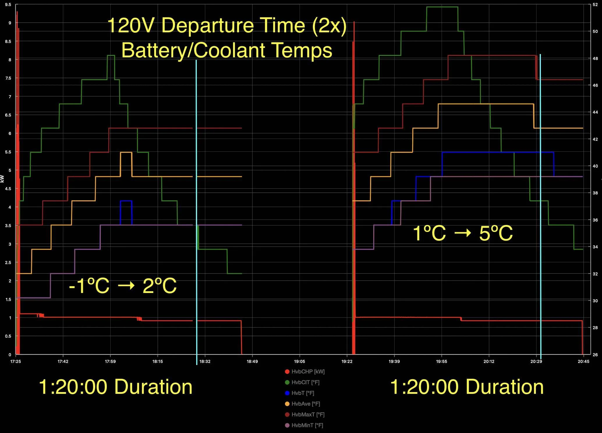

120V Departure Time Preconditioning:
While still plugged into 120V at my 85% charge limit, I ended up setting two departure times (DTs) in a row, one at 18:30 and one at 20:30, cabin temperature Medium. On all the graphs, the light blue vertical lines represent the departure times as a reference mark. During both departure times, heater power was limited to only 1 kW (same as 120V input power) compared to the usual 5-6 kW, so performance was slow. Both departure times lasted a total of 80 minutes. It's clear departure times are meant to only use energy from the wall rather than taking any energy from the pack. The temporal structure of a departure time program is as follows:
  1. Heat battery pack (35 min)
  2. Heat cabin (30 min)
  3. Departure time
  4. Continue to heat cabin (15 min)
The preceding heating times vary depending on how cold it is outside (longer when colder). My garage temp was about 21ÂşF.

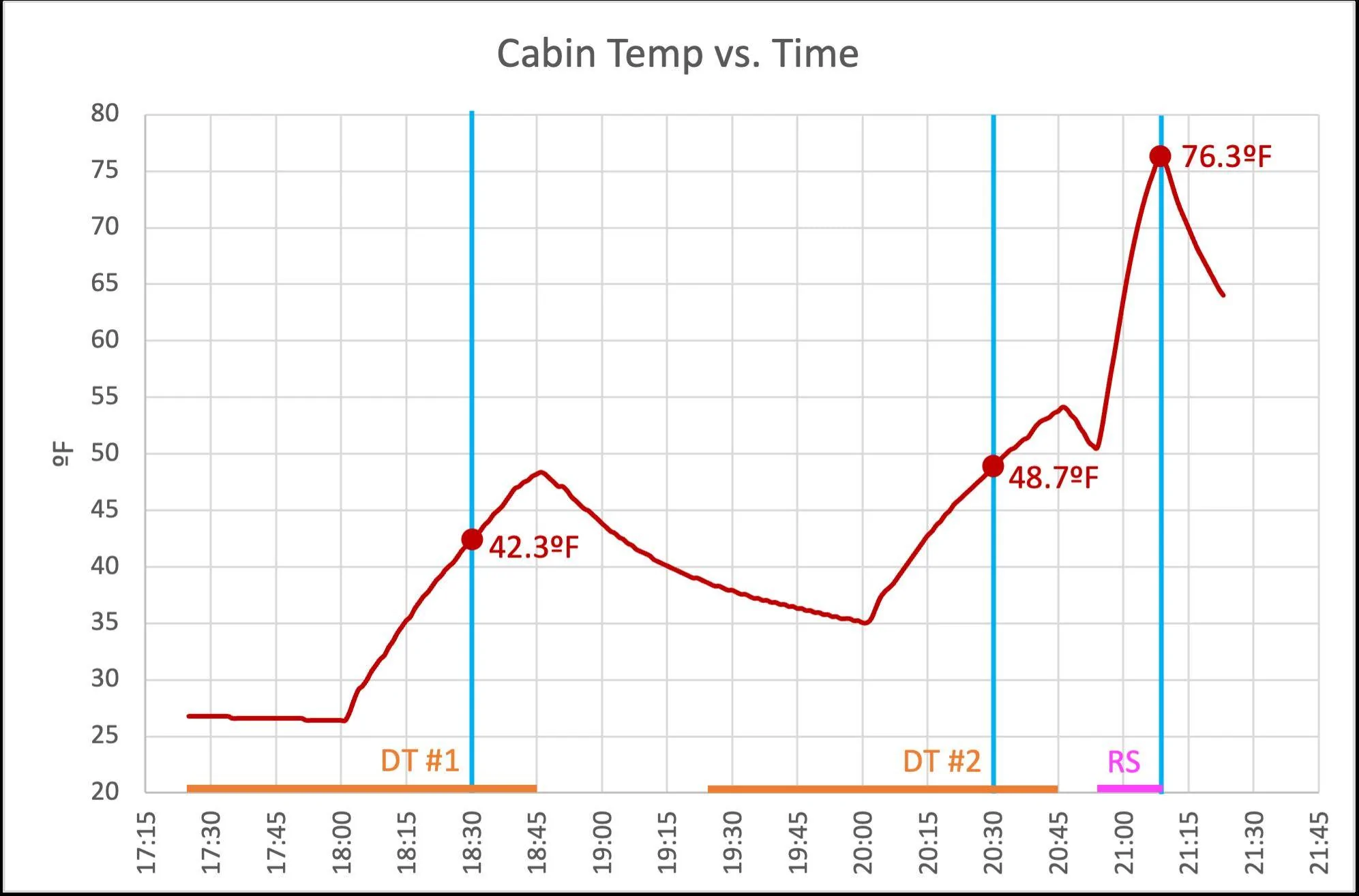

First let's look at cabin temperature performance:
Ford Mustang Mach-E Mach-Lee's Mach-E Cold Weather Testing [Taking Requests] Departure Time Tem
Remember the battery pack is being heated for the first 35 minutes of the DT, so the cabin temperature does not increase until midway through the DT periods (marked in orange). As you can see, the cabin temperature only reached 42ÂşF at the first 120V departure time, and only 48ÂşF during the second DT. That's not very warm as a result of the 1 kW heater limitation. The cabin continues to heat for 15 minutes after the DT before turning off. For comparison, I performed a 15 min remote start (RS) immediately after DT #2 lapsed. This time full heater power was used, and you can see the difference in the speed of the temp rise, eventually reaching 76ÂşF before timing out. Whereas the departure times did not really deplete the battery, the 15 min remote start drained the battery by 1% to 84%. The remote start required 40 minutes of L1 charging afterwards to return to 85%.
Now let's look at battery heating during 120V DTs:
Ford Mustang Mach-E Mach-Lee's Mach-E Cold Weather Testing [Taking Requests] Screen Shot 2022-12-25 at 12.43.21 AM
Again, light blue lines mark the set departure times. Red line is the coolant heater power, you can see that's flat at about 1 kW during the entire DT. The green line is the pack coolant inlet temp (CIT), you can see that rising the first ~30 min of the DT as the pack heats. CIT then starts decreasing when heating switches to to the cabin. Just like the previous test, pack heating performance was very poor at only 1 kW. During the first DT pack temp only increased 3ÂşC, 4ÂşC during the second DT. It seems the first DT wasn't long enough to get the pack warmed to 5ÂşC, so it appears to be running into a maximum time constraint.
Next let's look at energy use:
Ford Mustang Mach-E Mach-Lee's Mach-E Cold Weather Testing [Taking Requests] Screen Shot 2022-12-25 at 12.46.16 AM
Same red line for heater power. EVSE input is the blue line, you can see that's barely higher than the heater power. Green is the battery power, positive values indicate discharge. A small amount of power was being drawn from the pack at times, with a larger peak around the departure time. I think this is the heated seats and steering wheel turning on. There are also some exterior running light loads that come in as well. The heated seats run full blast for 10 minutes, before dropping down to a lower power.

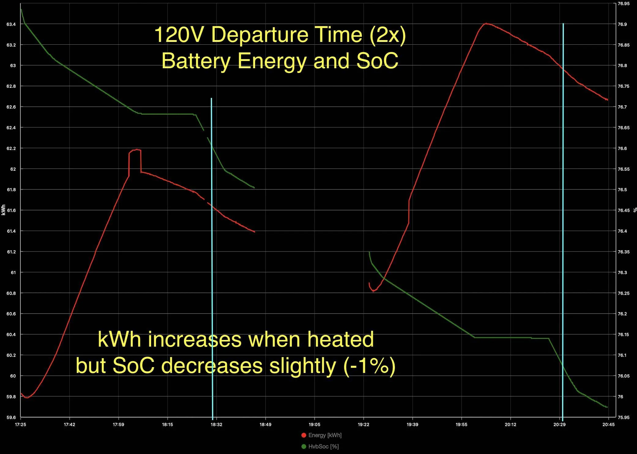

Last let's look at total battery SoC and energy:
Ford Mustang Mach-E Mach-Lee's Mach-E Cold Weather Testing [Taking Requests] Screen Shot 2022-12-25 at 12.47.23 AM
This is somewhat interesting and is a good illustration of why heating the pack helps range. The red line is the estimated total pack energy (kWh) from the BMS, the green line is the the exact SoC. You can see that when heating the pack, the SoC actually goes down 1% while the total energy goes up 3.5 kWh. How does the pack energy go up if the SoC is dropping? The pack holds more energy when warm, and more energy can also be extracted while warm, which explains the trends. Heating the pack does not give you free energy, it just unlocks more available energy that's already in the pack.
If I go back and include the data from the previous test:
  • Pack temp increased 11ÂşC (-6Âş C to 5ÂşC)
  • Pack energy increased 6 kWh (57.4 to 63.4 kWh)
  • Range increased 12 miles
If you extrapolate that to a full winter pack warmup (-15ÂşC to 15ÂşC) the effective range increase for warming a cold pack could be up to 40 miles. You will also have a higher power limit (less gray jail bars) and acceleration with a warm pack.
Findings:
  • 120V departure time preconditioning DOES heat the pack, albeit VERY SLOWLY
  • Departure times do not deplete pack energy
  • Heater limited to 1 kW on 120V
  • Battery heats up only 3-4ÂşC per 120V departure time
    • Will not be fully warmed in one cycle
  • Cabin warms up only 15ÂşF per 120V departure time
    • Cabin may not be warm enough
  • Remote start heats up the cabin much faster than 120V departure times
    • Uses full heater power and depletes the pack slightly
    • Does not heat the battery
Conclusions:
  • 120V departure times DO heat the battery, but barely
  • 1kW is not enough power to heat the pack or the cabin in a reasonable amount of time
  • The cabin and pack are not fully warmed up after a 120V DT
  • A remote start (or two) right after a 120V DT seems to be a good strategy to get the cabin fully warm
    • Set the Departure Time 30 mins before you leave, remote start 15 mins before you leave
  • Due to poor 120V heating performance, a 240V EVSE is strongly recommended for winter climates so you get full-power heating.
  • Setting a 120V DT is better than nothing, but not by much.
If you use 120V charging, remember to ALWAYS PLUG IN to keep the battery warm in the cold. You need as much time plugged in as you can get.
