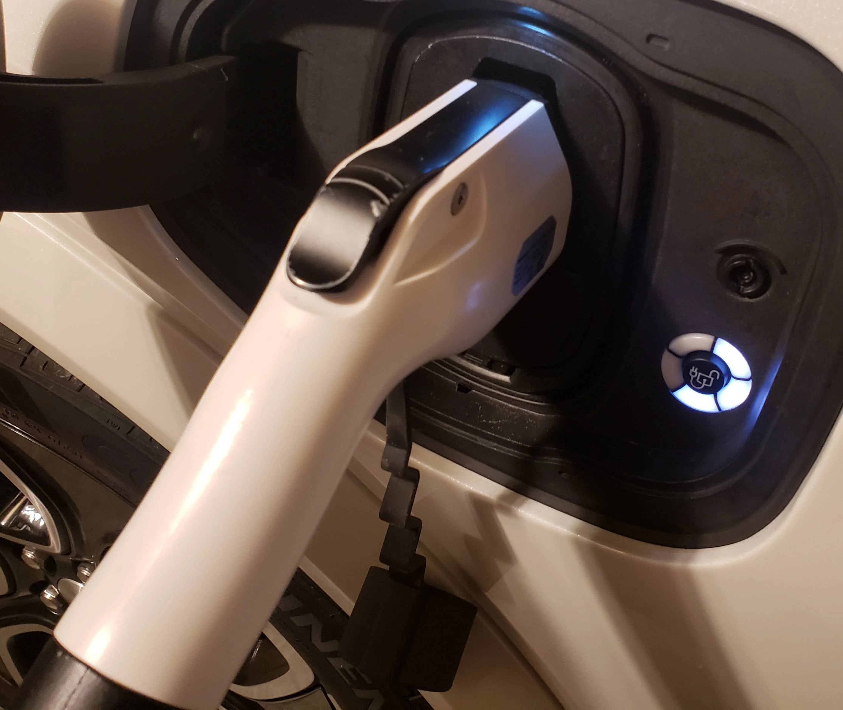

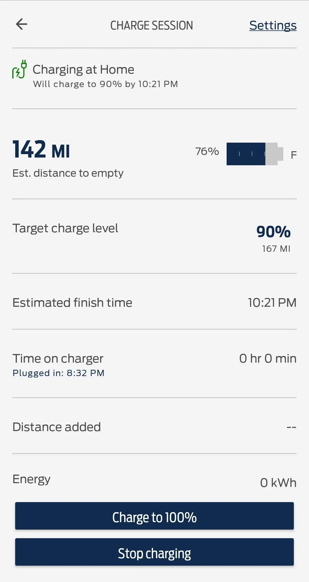

So I just tested this and it does not work. I plugged in and the car started charging. I opened FP and pressed "Stop charging":
Ford Mustang Mach-E Mach-Lee's Mach-E Cold Weather Testing [Taking Requests] Screenshot_20221226-203357_FordPass
The car actually did stop charging and the charging LEDs turned from blue to white:
Ford Mustang Mach-E Mach-Lee's Mach-E Cold Weather Testing [Taking Requests] 20221226_203713
So cool! But it only lasted about 10 seconds, and the car resumed charging as normal. What is the point of the Stop Charging button if it only temporarily stops the charge? Rhetorical question.
Anyway, sorry for this misdirection. I thought it would work.

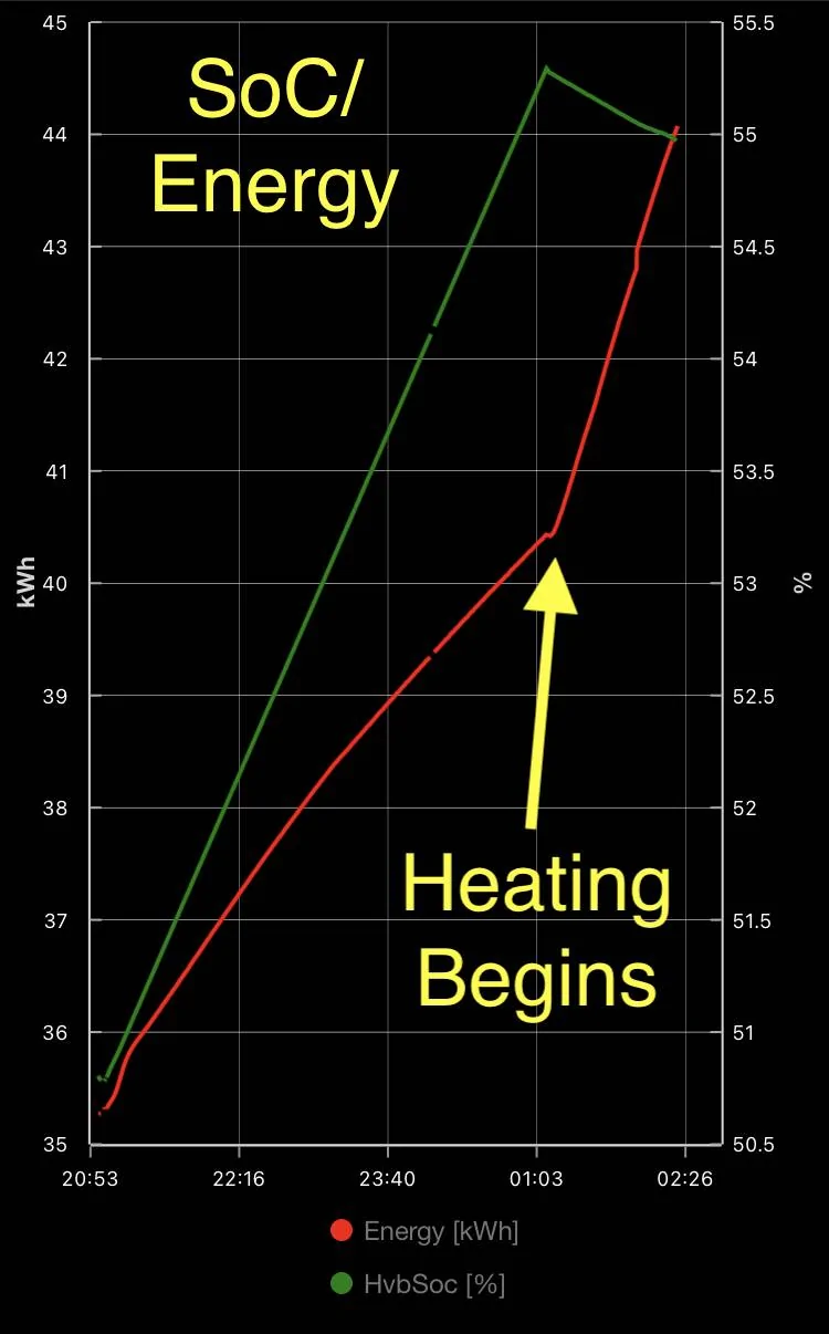

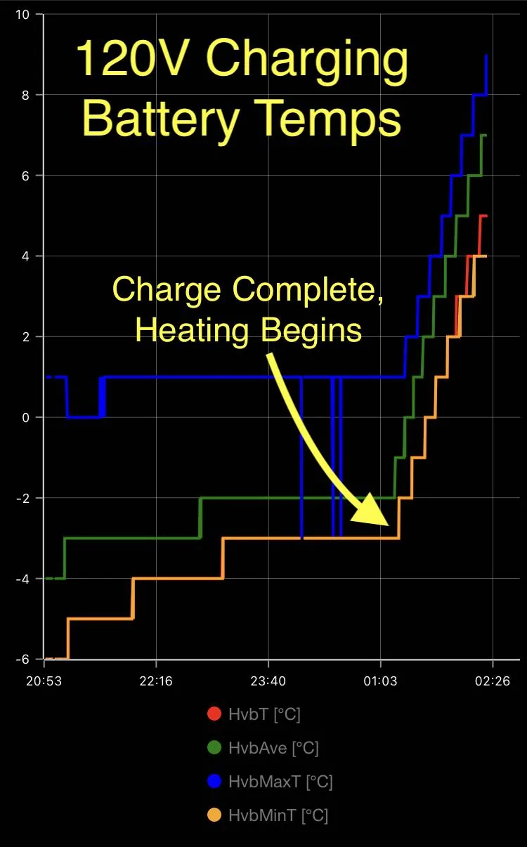

120V Charging/Heating Test
L1 charged with the battery at -6ºC. Battery charged for about 4 hours without increasing in temperature much. As soon as the target SoC was reached, the coolant heater started at 1 kW and heated the pack up from -3ºC to 5ºC, which took about 75 minutes. The EVSE input was constant at 1.1 kW the entire period.
The battery will not heat on 120V until charging has finished.
Ford Mustang Mach-E Mach-Lee's Mach-E Cold Weather Testing [Taking Requests] IMG_B7A29F39DF99-1
Ford Mustang Mach-E Mach-Lee's Mach-E Cold Weather Testing [Taking Requests] IMG_266BEE4A28EB-1

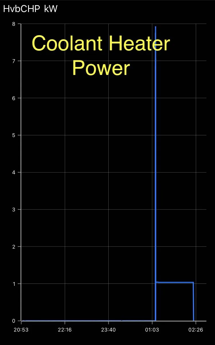

Coolant heater always runs at 1 kW while plugged into 120V instead of 5-6 kW. The only exception is remote start, which allows full output with corresponding battery drain.
Ford Mustang Mach-E Mach-Lee's Mach-E Cold Weather Testing [Taking Requests] IMG_6EFA65E68B60-1
This is kinda interesting, you can see the battery energy increase from charging, and then from heating at 1 kW. The slope while heating is a lot steeper even though the power input is the same, this shows how effective heating can be for increasing pack energy. The SoC goes down slightly since the pack can actually hold more energy when warm.
Summary:
  • When using a Level 1 (120V) EVSE, the pack will charge first, and then heat.
  • When using a Level 2 (240V) EVSE, the pack will heat first, and then charge.
Conclusions:
  • The Mach-E prioritizes charging on 120V, and will only heat the pack after the charge target is reached.
    • This behavior is the opposite of 240V charging.
  • If you use 120V charging, make sure you give the car enough plug time so it can heat up the battery at the end of the charge cycle. Allow an extra hour or two for heating.
  • Setting a lowered charge limit that can be accomplished overnight may be beneficial so the pack is heated before the next drive.
    • If the charge limit is not reached, the battery will not be heated. Avoid endless charging.
    • Lowering the charge limit below current SoC can force a switch from charging to battery heating on 120V.
    • Recommend you allow charging 24/7 on 120V, and set a reasonable limit in the 70-90% range.
