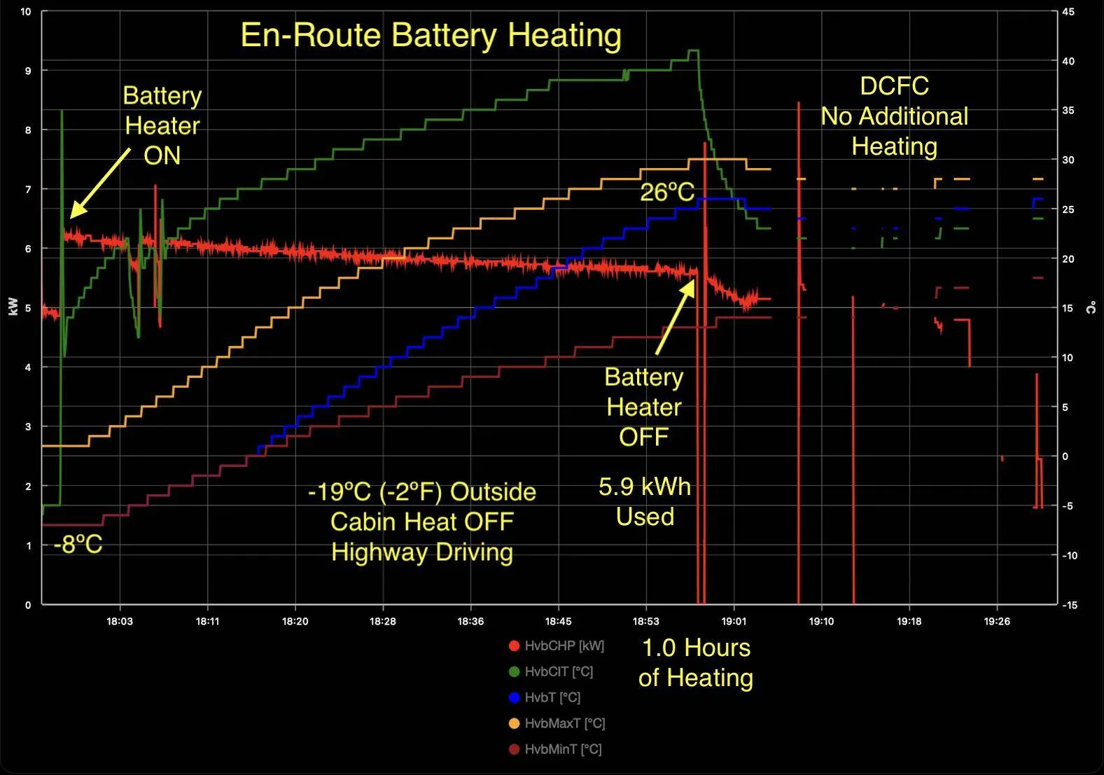

So let's take a look at the temperature graph:
Focus on the blue line which is the main pack temp. In 61 minutes it went from -8ÂșC (18ÂșF) to 26ÂșC (79ÂșF). The heater output started at 6.2 kW and gradually declined to 5.6 kW (this is the PTC effect as the coolant return temp increases). Keep in mind this graph really represents the fastest you could possibly heat the battery in these conditions, the amount of heat available with the HVAC on simultaneously will be quite a bit less. If the HVAC was on at the same time, pack heating likely would have taken two hours and would have run into a wall before reaching 26ÂșC. Perhaps it would have only reached 5ÂșC. This is why it was disabled due to limited heat reserve. I will need to wait for a warmer day to test battery preconditioning while the cabin heat is still active, but the rate of heating will be significantly less.

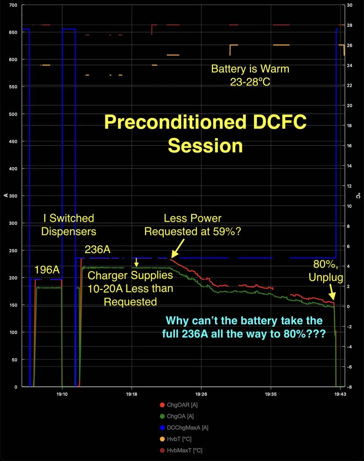

Now let's look at the DCFC session at a 150 kW EA station I reached shortly after battery heating finished:
Temp was down to about -20ÂșC/-4ÂșF when I pulled in. A lot of the chargers were displaying a "power reduced" message. I chose one not displaying the message, and activated with Plug & Charge. However I immediately noticed a 196A max current limitation (blue line), much less than the 350A these stations should be capable of. I wasn't happy with only 62 kW, so I decided to try a different dispenser. This one allowed up to 236A which was an improvement, but still slower than it should be. Not sure how much the cold affects these things. The car was correctly asking for full amperage (red line) at first, but the stations always supply (green line) 10-20 amps less than requested for some reason.
After reaching about 59%, the car decided to start requesting less current from the charger, you can see the red request line start decreasing. This is frustrating because the battery is warm enough and perfectly capable of handling the full 236A all the way up to at least 75-80% SoC. Ford has this weird charging strategy where they set the remainder of the charge curve based on the initial rate. Almost like it's a percentage of the initial rate. This means if you use a slower charging station, it will slow you down that much more for the rest of the curve based on the initial speed. This is totally not necessary, there should be a calculated maximum rate at each % SoC based on the battery temps. When using a slower DCFC station (<80 kW), it should be pegged at maximum output the whole way to 75-80%. At only 218A, no part of the battery should be getting that hot so I just don't see the need to throttle it. Ford should work on this strategy because they are needlessly reducing the charging speeds at lower power DCFC stations.
During the DCFC session, the battery was not heated any more by the PTC heater. I shut HVAC off to make sure, nothing happened. I've seen some cases where it heats more than 26ÂșC after starting a session, the decision to heat more must be tied to the charging power available. In this case heating more wasn't necessary for the speeds I was charging at. Temp increased from 23ÂșC to 26ÂșC on its own during the session (yellow trace at the top).
Findings:
  • Battery took 1 hour to heat from -8ÂșC to 26ÂșC using full 6 kW heater output (34ÂșC/hr)
  • Battery heat capacity is 0.18 kWh/ÂșC or 630 kJ/ÂșC
  • Preconditioning starts as soon as a DC station within 30 km is selected in the Ford nav
  • There is no time limit on battery heating as long as you remain within 30 km of the station
  • There is a 26ÂșC upper temp limit
  • En-route preconditioning will not occur at extreme cold temps unless you turn off HVAC
  • Many EA stations operate with significantly degraded performance
  • EA stations output 10-20 amps less than requested by the car
  • Additional heating above 26ÂșC while DCFCing is not always commanded
  • Ford throttles back the charge rate unnecessarily at lower-amperage DC stations
Conclusions:
  • The Mach-E needs a dedicated 5 kW battery heater that is not shared with the cabin.
  • Battery temp increase will be limited with only a 30 km range limit.
    • I think this limit should be increased to 60-120 km to give enough time.
  • EA stations are in varying states of disrepair
  • Ford should fix unnecessary throttling of low-amp DC stations and allow full current up to 75-80%. The current limit at 50-75% should not be affected by the initial station amperage unless using a high amperage (300+) station.

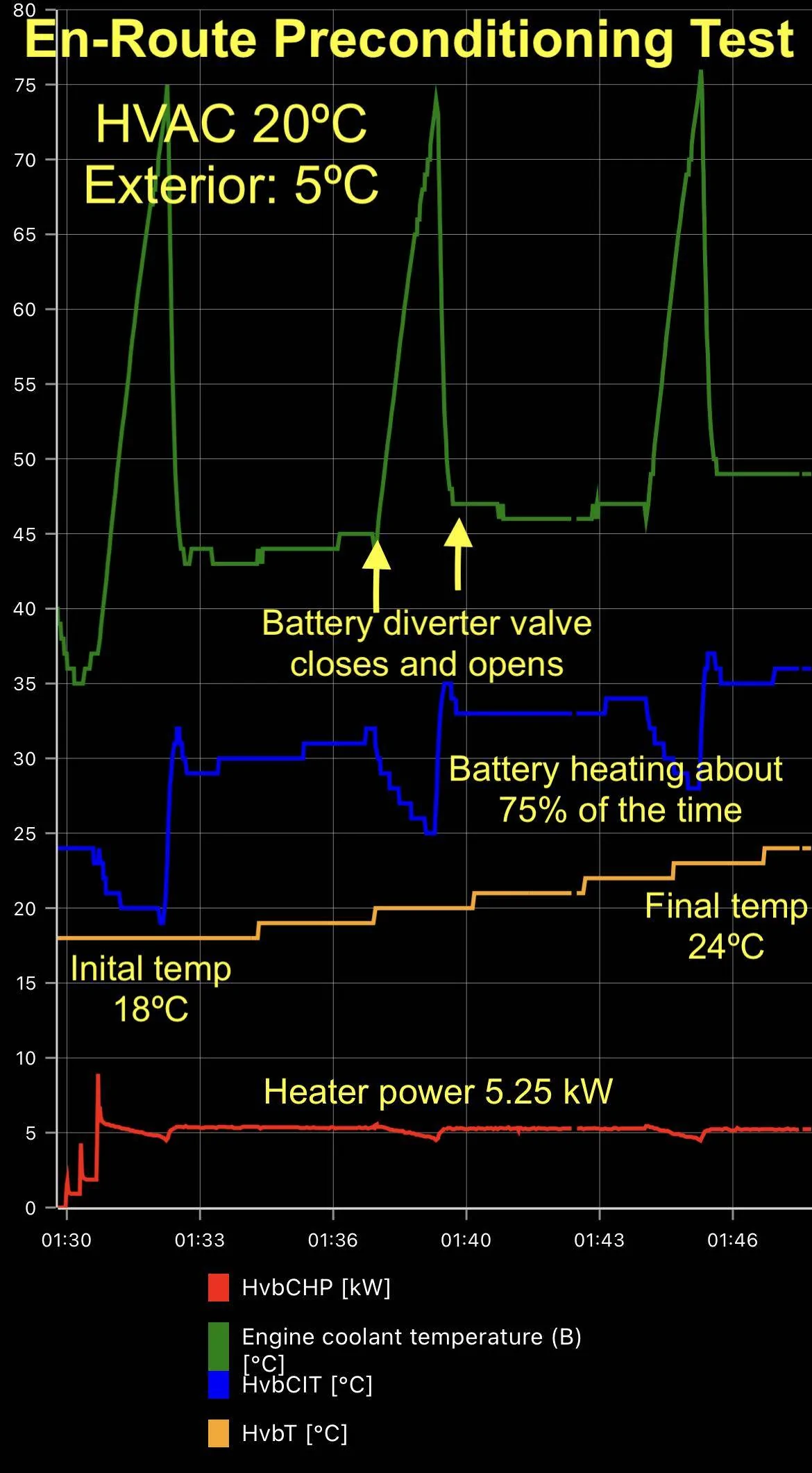

Warmer En-Route Preconditioning Test
Exterior temp: 5ÂșC (41ÂșF)
Starting battery temp: 10ÂșC (50ÂșF)
I've been waiting for warmer temps to do another preconditioning test. Unlike previous tests, this time there should be an adequate heat reserve, so I wanted to test it with HVAC on, which is more typical of how most people would use it. Also the battery was somewhat warm to begin with, which again is more typical.
Test 1 result: +8ÂșC battery temp increase (10ÂșC to 18ÂșC). FAIL. Not warm enough for proper DCFC.
75 MPH / 15 minutes
For test 1, I drove towards the DCFC station on the interstate at 75 MPH, set in the Ford nav. At first I had my HVAC set to my usual 68ÂșF AUTO 2 setting. However I had trouble getting the heating to initiate, so I had to drop my HVAC to 60ÂșF. Heating starts 18.6 miles out, so total preconditioning time was only 15 minutes. The temp only reached 18ÂșC when I arrived at the charger, which failed to meet the target of 26ÂșC. In other words, I only made it 50% of the way to the temperature target. I've said this many times now, but the 30 km geofence before heating starts is too short. It needs to start at least 80 km out from the charger to get good results.
Another thing I observed is the battery heating shut off upon arrival. If there is a delay plugging in (such as waiting in line or finding a working charger) your battery will no longer be heating. It should keep heating the battery until you plug in or leave. This is really annoying because you'd have to park far away from the charger if you wanted to keep heating the battery while waiting.
Graph was pretty boring for this one, heater pegged at 5.5 kW the whole time.
Test 2 result: +6ÂșC battery temp increase (18ÂșC to 24ÂșC). FAIL. Close, but even slower warming.
60 MPH / 19 minutes
For test 2, I drove outside the 30 km geofence then turned around. This time I took a route with slower highways with 55 MPH speed limits. The first test was a "fast" test, this should be a "slow" test to simulate driving on smaller highways to a DCFC. I also left the HVAC on at 68ÂșF this time to see what it could do while still providing adequate cabin heat. This time, even though it had about 20% more time, it heated the battery 25% less than the first test because of the higher climate setting of 68ÂșF. I also consider this a fail. I would need a 80 km geofence to have enough time to heat 10ÂșC to 26ÂșC in these conditions with cabin heat on.
Ford Mustang Mach-E Mach-Lee's Mach-E Cold Weather Testing [Taking Requests] IMG_1832
Looking at this graph, we can see the coolant temps at the top. The battery diverter valve is opening and closing to switch the battery in and out of the heater loop. The battery is switched out to recover the coolant temp going to the heater core (green) so the cabin stays warm enough. This lasts about 90 seconds before the battery is switched back in (loop temp drops due to large thermal load). The duty cycle for battery heating was about 75%, the other 25% of the time was spent exclusively heating the cabin. Last we can see there is about a 13ÂșC coolant temp drop after passing through the heater core.
Summary:
  • Even with reasonable above-freezing temps, enroute preconditioning failed to bring the battery up to an adequate minimum temperature for DCFC in time.
  • The 30 km geofence is still much too short! Suggest 80-100 km.
    • Going longer is not a concern because the heater will shut off when warm enough. Won't cause excess range depletion.
  • The 26ÂșC target temp is also a little low, I would like to see 30ÂșC minimum on arrival.
  • Battery heating shut off upon arrival. It should keep going until you plug in or leave.
  • New HVAC software did well, maintained cabin humidity around 31% and no fogging observed.
