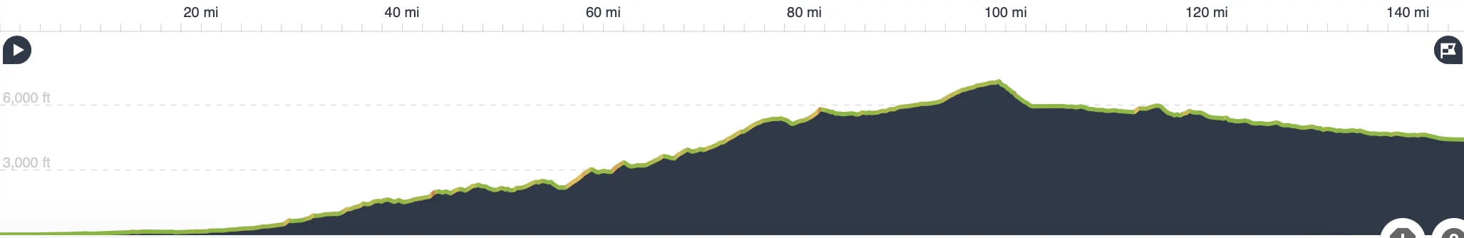

I typically drive from Sacramento, CA to Reno, NV through the Donner Pass :eek: and am a bit concerned about the MME's ability to make it on a single trip during the winter ('21 Prem ER AWD, stock 19" wheels & CrossClimate tires). Thus far I've used my ICE vehicle for the trip but am keen to give the MME a shot next season.
The distance is 140 miles total.
Route goes from sea level to +7000 feet over 100 miles, then (thankfully) descends to 4600 feet for the remaining 40 miles, all on I-80. Temperatures in the harshest part of the season are 10-20 degrees Fahrenheit with snow falling. I'd like to run the cabin heater at 70 degrees.
When there are chain controls (only required on big rigs and 2WD cars), speeds drop to sub 35 mph for a chunk of the climb but let's assume 72 mph for the drive.
There are two typical scenarios:
  • Scenario 1: no chain controls, 72 mph for the drive.
  • Scenario 2: chain controls (only required on big rigs and 2WD cars), speeds drop to sub 35 mph for a chunk of the climb. Drive can take 4-5 hours, meaning the cabin heater will be on much longer but the car will be going much slower.
Do these conditions in either of these scenarios stretch the car's ability to make it?
I've done a similar trip in one drive with no stops (because I was anxious to get home), but it was 209 miles on interstate 40 from Needles, CA (~460 feet elevation) to Flagstaff, AZ (~7300 feet elevation) in the winter, through a snowstorm. My state of charge was 100% at the start and 13% at the end. I have the CR-1 AWD rather than the Premium.
Good data point for me (also have CR1 AWD). I frequently do a 155 mi trip from sea level to 7800 ft. In the summer I go from 100% to 35%, but I haven't tried in winter. You didn't lose as much range in a snowstorm as I would have expected.

I tend to stay around 70-73 mph in good weather on the freeway (and it started as good weather in Needles). In storms, I drop speeds appropriate for the weather. At 35-55 mph, the weather has far less impact than one might expect.
Also, I tend not to use the cabin heating as I always bring a jacket, warm socks, etc., with me during winter trips and I use them. I did use the seat and steering heaters.
