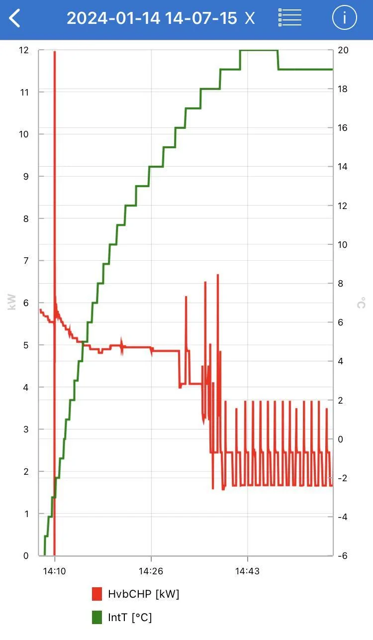

Overnight Unplugged Test
Decided to test what happens to the battery temperature and heat if you park outside overnight in very cold conditions. Overnight temps were below 0ÂșF, but when I started the test everything had warmed up to about 0ÂșF/-18ÂșC.
Starting conditions:
Wind: NW 11 mph
Outdoor temp: 0ÂșF/-18ÂșC
Battery temp: 0ÂșF/-18ÂșC
Cabin temp: 14ÂșF/-10ÂșC
I manually started the car (no remote start) with my normal HVAC settings (68ÂșF/20ÂșC AUTO 2), disabled auto shutdown timer, and let it sit for 90 minutes to see how the cabin and battery would warm up.
The cabin reached set point after about 35 minutes. The heater throttled back at that point, afterwards using an average of about 2 kW. The battery was not heated whatsoever and remained at -18ÂșC with HVAC on. Vent temps were about 110ÂșF (warm).
Ford Mustang Mach-E Mach-Lee's Mach-E Cold Weather Testing [Taking Requests] IMG_1986

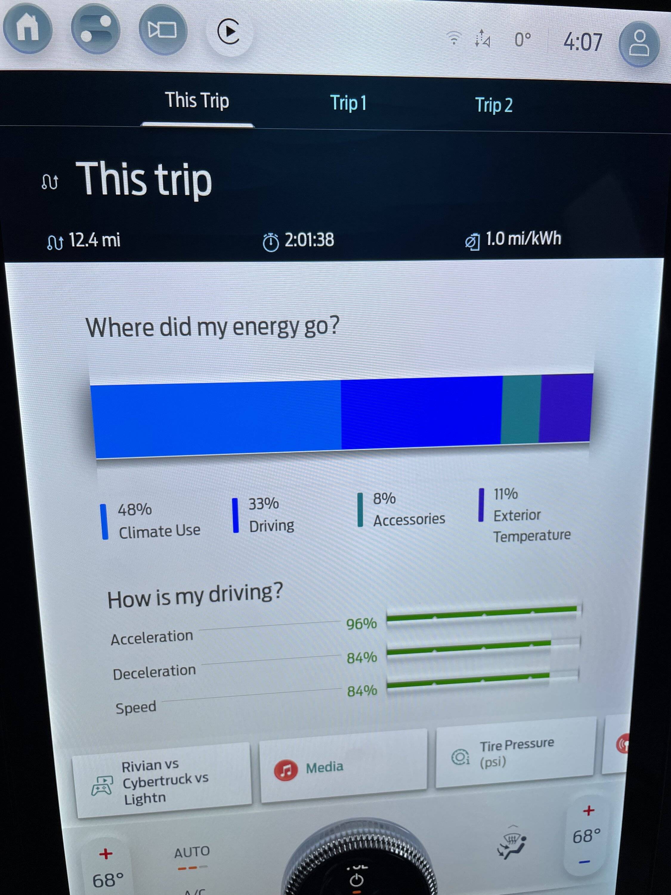

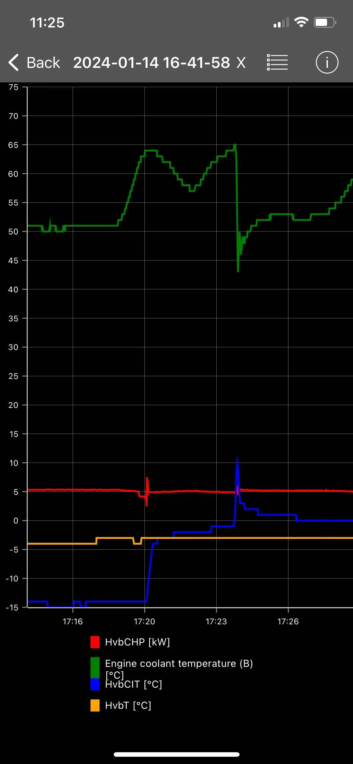

Next I decided to drive the car to see if anything would happen to the battery temp. At -18ÂșC battery temp, the regen limit is 30 kW (less than half of normal), which is shockingly high. I'm surprised they even allow any regen at these extreme battery temps. It will use up the whole 30 kW and blend friction braking so you still stop at the same rate with 1PD. I saw some pretty crazy voltage drops, I got the battery all the way down to 300V under 400A load at 75% SoC. That's like a 50 volt drop. Battery isn't happy. The battery temp increased a couple degrees from ohmic heating, but again no battery heating was observed. There was a jump in regen limit of 43 kW once -15ÂșC was reached. I ended the drive with -14ÂșC battery temp.
Ford Mustang Mach-E Mach-Lee's Mach-E Cold Weather Testing [Taking Requests] IMG_2559
As you can see at the top, cabin temp was maintained at 20ÂșC with ~100ÂșF vent temps. Heater output was close to full power (4-5 kW).
Next I parked the car and turned off HVAC, which finally allowed battery heating to initiate! That went for 35 mins, and battery heating was terminated at -7ÂșC. The battery eventually topped out at -5ÂșC, which brought the regen limit up to 68 kW.
Ford Mustang Mach-E Mach-Lee's Mach-E Cold Weather Testing [Taking Requests] IMG_2560
Another interesting finding is the 12V battery only gained 3% SoC with the car on for an hour:
Ford Mustang Mach-E Mach-Lee's Mach-E Cold Weather Testing [Taking Requests] IMG_2561

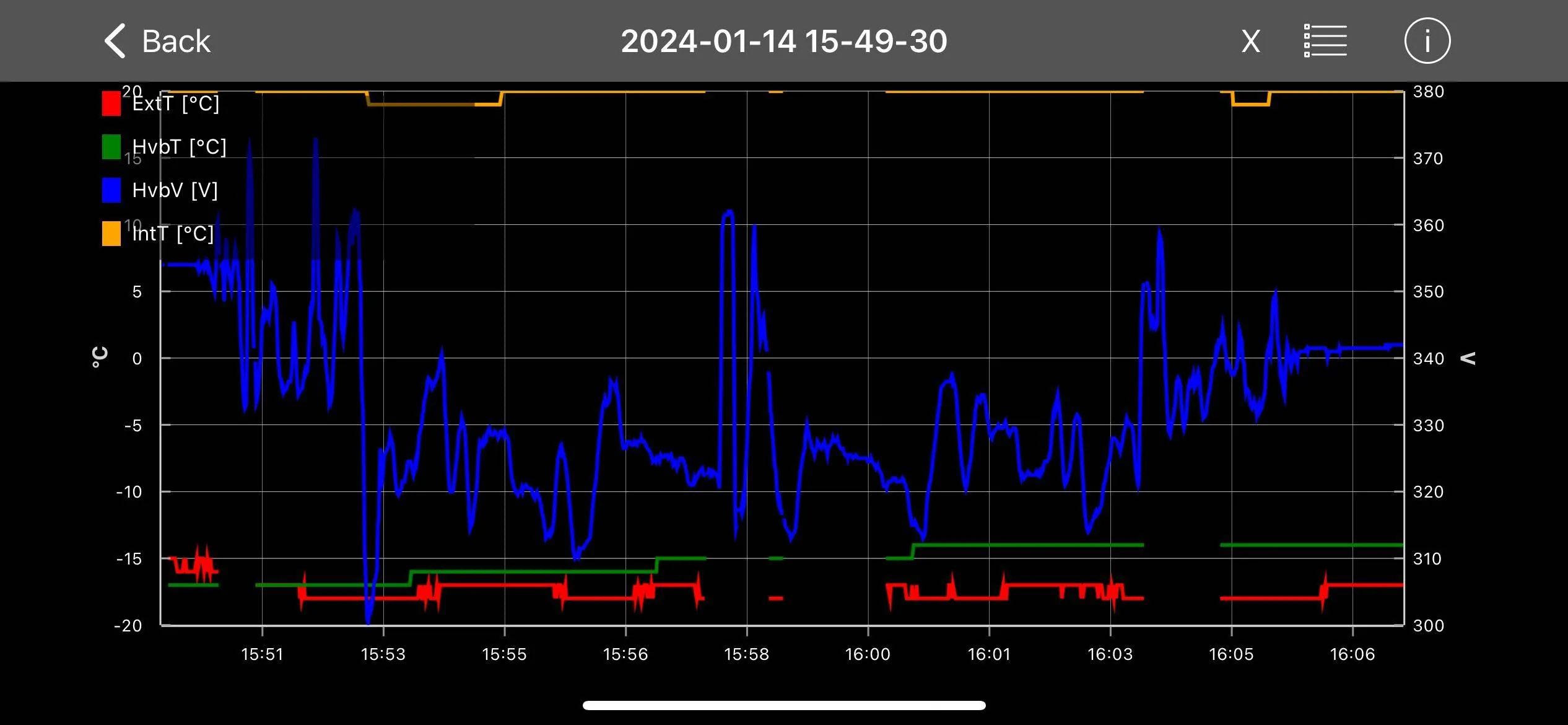

I decided to do another 75 MPH drive to see if the battery would cool off or heat more. In short, not much happened. Again, the battery was not heated and increased only a couple degrees from the amp draw. Went from -5ÂșC to -3ÂșC. Cabin temp was still good, heater operating at max 5 kW output, exterior temp still around 0ÂșF.
Now I haven't mentioned the fogging much, but it was mostly okay. Most of the fogging episodes resolved in less than a minute without user intervention. Which shows the HVAC strategy is conserving maximum heat. When I'm on the interstate at high speed I don't really get any fogging, it's all outside air. However when you slow down and exit the interstate or make a turn at an intersection, that's when you suddenly get fogging shortly afterwards. Clearly it's related to vehicle speed. But during one of these fogging episodes, something interesting happened and the battery actually heated for a short time:
Ford Mustang Mach-E Mach-Lee's Mach-E Cold Weather Testing [Taking Requests] IMG_2562
The top green line is the coolant output temp before the heater core. You can see it was stable, but then started increasing, this was when the fresh air damper was closed (warmer return air allowed the loop temps to rise). When 64ÂșC was reached, the diverter valve opened to send coolant to the battery, but only for a brief moment. Coincidentally, at this same time I felt a sudden burst of cabin heat, which must have been because the outside air had closed. I also happened to place a phone call at this same time (17:22), which drops the blower speed. The coolant temp began to rise again, hit 64ÂșC, and the diverter valve opened again. This one lasted for a couple seconds and dropped the loop temp before switching back. The battery did not increase in temperature from these short bursts.
All this tells me the PCM still wanted to heat the battery pack warmer than -3ÂșC while driving, but it couldn't because there wasn't enough heater output available.

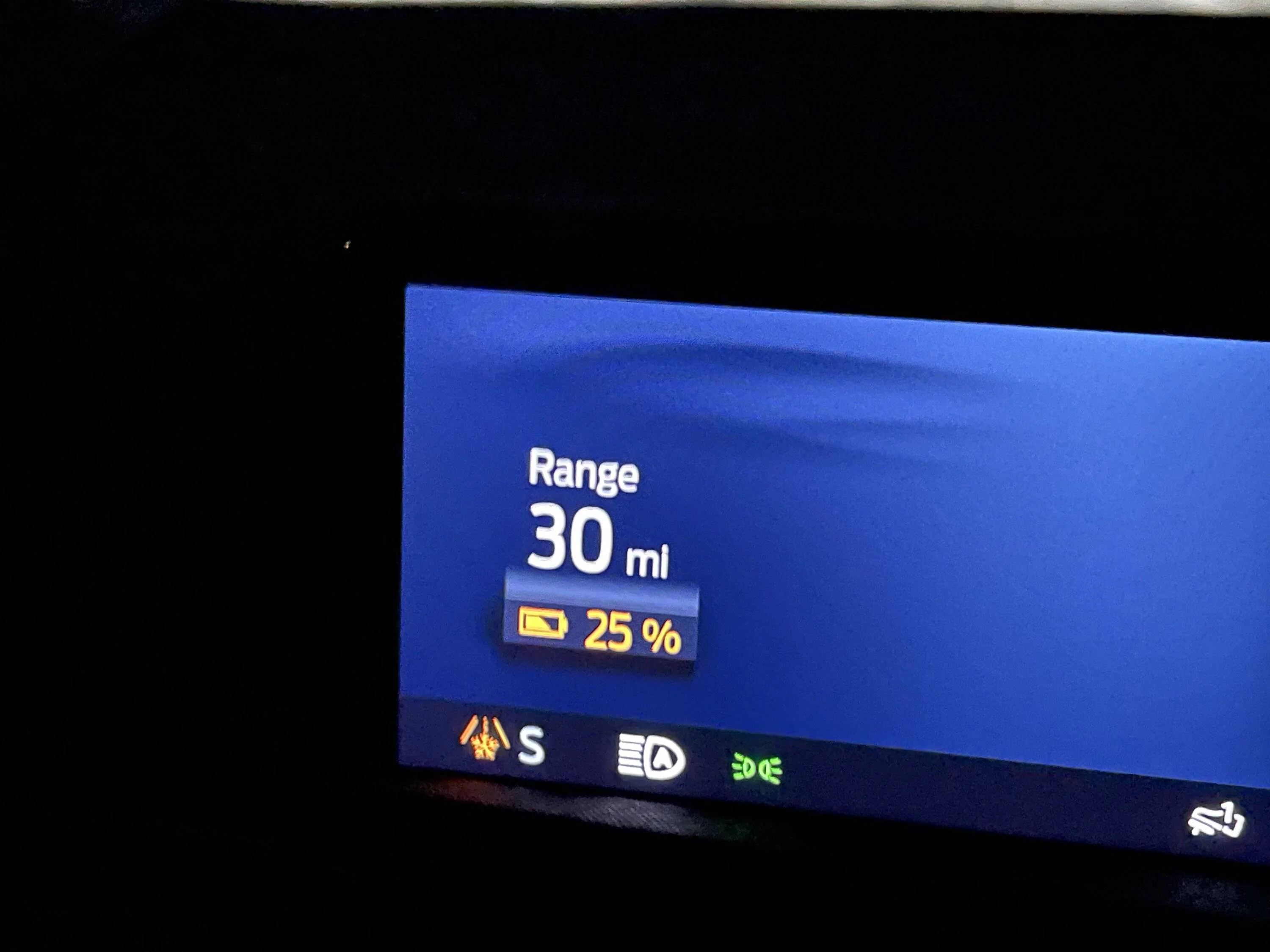

At this point I ended my tests, and was greeted with some pretty hilarious efficiency displays for my trouble (the car sat a long time with the heater running):
Ford Mustang Mach-E Mach-Lee's Mach-E Cold Weather Testing [Taking Requests] IMG_2556
Next key cycle the GOM tanked:
Ford Mustang Mach-E Mach-Lee's Mach-E Cold Weather Testing [Taking Requests] IMG_2557

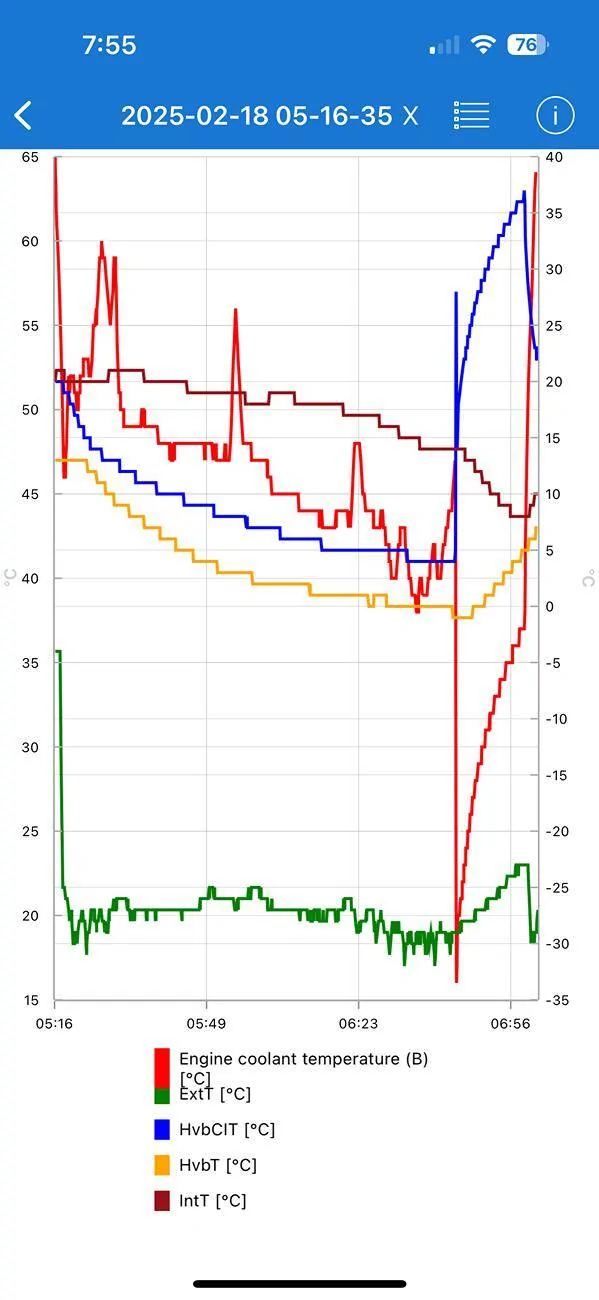

We had some more very cold weather here (-20ÂșF or about -30ÂșC), so I decided to do another test to see where things stand with latest software in 2025. I also insulated all the heater hoses to see how that worked.
Wind: NW 5 mph
Outdoor temp: -17ÂșF/-27ÂșC
Battery temp: 55ÂșF/13ÂșC
Cabin temp: 68ÂșF/20ÂșC
Battery SoC: 80%
I started with a departure time, so the battery and cabin was warmed up. The battery had already cooled off to about 8ÂșC at the departure time, so I had to manually warm it up again to 13ÂșC. I wish Ford's strategy would heat the battery up more during departure times (to at least 15ÂșC), we need all the heat we can get. I remember older software targeting 15ÂșC instead of 12ÂșC.
Outside temp varied, but was about -16 to -22ÂșF (-27 to -30ÂșC). I did my usual loop, about 90 miles with mostly interstate speeds (75 MPH).
Ford Mustang Mach-E Mach-Lee's Mach-E Cold Weather Testing [Taking Requests] IMG_0491
Battery Heating
The latest software will automatically try to heat the battery to keep it warm in extreme cold temps, which is an improvement over older software. The battery was being heated basically the entire drive, but as you can see from the graph, despite the heating the battery temp still cooled off. As I've written about in the past, there is extreme heat loss through the bottom of the battery pack (probably approaching 4 kW or 12,000 BTU/hr of heat loss) due to lack of insulation. The battery temp went from +13ÂșC to -1ÂșC in little more than an hour. Insulating the heater hoses did not have much of an effect on the rate of battery heat loss, most of the heat is lost through bottom surface of the battery pack, and to some extent the sides and top of the pack. There just isn't enough total heat output available to keep both the cabin and battery fully warm at -20ÂșF, which would require more like 9 kW of total heat output.
A critical battery temp of 2ÂșC was reached in less than an hour of driving, which I'll discuss in the next section.
Cabin Temperature
Setting: 68ÂșF/20ÂșF AUTO 1
The cabin started out nice and warm from the departure time before the trek into the frozen tundra. Vent temps were 90ÂșF or more. During the drive the cabin temp gradually cooled off, but there was an increased rate of cooling at the end of the drive, and things started to get a little cold towards the second half of the drive. I was wearing a parka, but you start to feel just cold air blowing around. In particular, I've found that the feeling of warmth in the cabin is closely related to a Car Scanner parameter called Engine coolant temperature (B). This is the temperature of the coolant as it exits the PTC heater right before the cabin heater core. So the warmer that is, the more heat you will have. In particular, when ECT B drops below about 50ÂșC, that's when I start to feel cabin heat becoming more limited. By 45ÂșC, you feel only a little heat, and by 40ÂșC, you have essentially no heat output anymore. At the end, vent temps were less than 65ÂșF and the cabin was about 57ÂșF.
Cabin heat is related to battery temperature, since the battery pack is switched into the heating loop at these temps. I have noticed that when the battery pack temperature drops below 3ÂșC, battery heating becomes more prioritized. This means the vent temps will start to drop to less than 80ÂșF once the pack cools off to 2ÂșC. If the battery pack is not warmed up above 2ÂșC for your drive, you will be cold.
Overall with the insulated heater hoses, ceramic tint, and insulated roof glass, I'd say the car has enough heat and is comfortable down to about -15ÂșF (-26ÂșC), whereas with no mods it lost heat around -4ÂșF (-20ÂșC), provided the battery starts out warm.
Fogging
Fogging at extreme cold temps has been a problem in the past. Despite the cold temps, my drive was mostly fog free with the latest HVAC software. For whatever reasons, the strategy likes to close off the outside air when you slow down below about 40 MPH, which can generate some fogging. You'll notice the fogging when you get off the interstate or after slowing down to make a turn. Usually it's pretty brief and will clear itself after about 30 seconds if you wait. I did not have to use defrost at all (beware, using defrost can cool down the cabin). Other than the odd vehicle speed dependency, I'd say the latest HVAC software is doing the best it can to prevent and manage fogging.

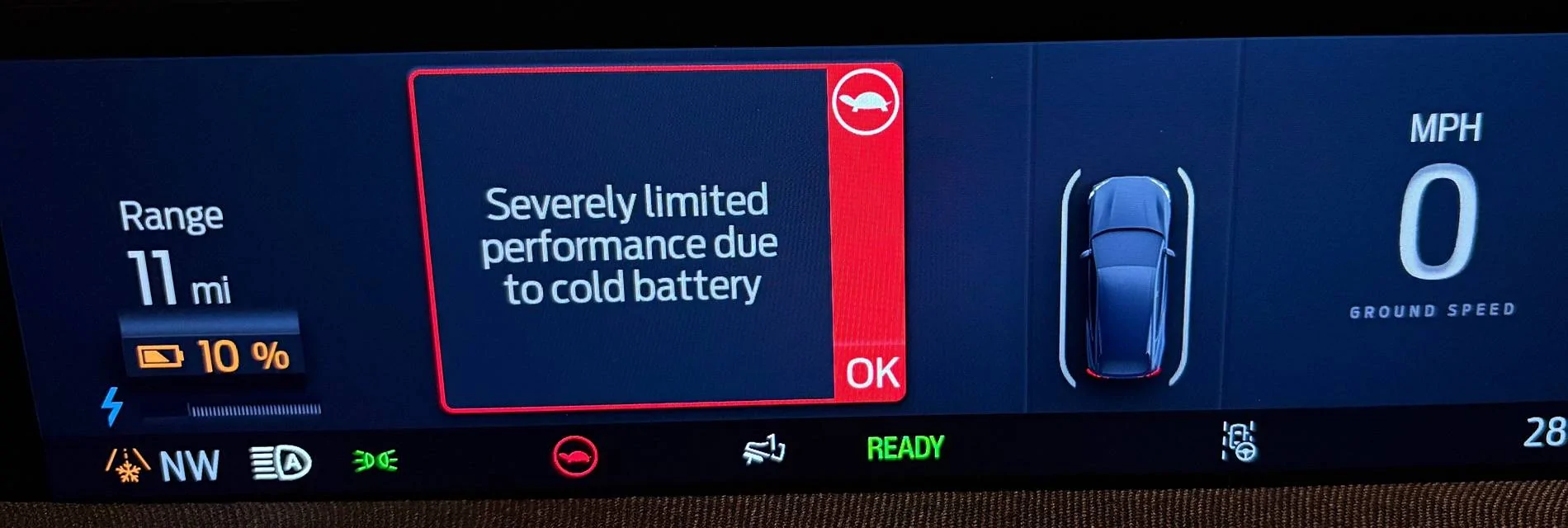

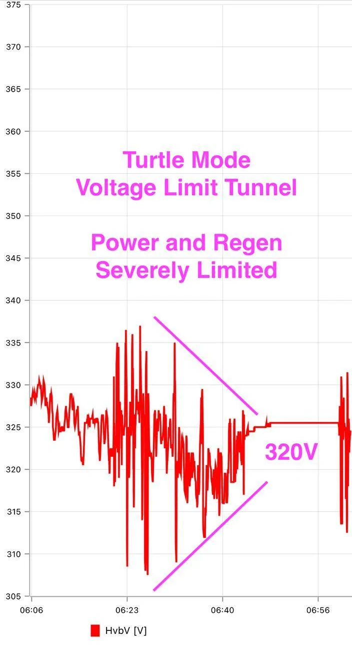

Turtle Mode
Ford Mustang Mach-E Mach-Lee's Mach-E Cold Weather Testing [Taking Requests] IMG_0486
As expected yellow turtle mode kicked in with around 13% battery left with 0ÂșC battery temperature. Red turtle followed shortly after with 10% battery left. As discussed in the turtle mode topic, motor power is extremely limited (less than 25 horsepower) and the vehicle could not accelerate to highway speeds anymore. With red turtle active, I tried my mitigation strategy of shutting off HVAC for 15 minutes. This used about 2% battery, but the motor power output significantly improved from 25 horsepower to 120 horsepower afterwards. The battery warmed up from -1ÂșC to 5ÂșC during the HVAC off period. The mitigation strategy was successful at restoring motor power and will allow you to continue to your designation with only 2% less battery.
Ford Mustang Mach-E Mach-Lee's Mach-E Cold Weather Testing [Taking Requests] IMG_0492
I've discussed this in the other topic, but turtle mode is excessive overkill battery protection. Battery science does not say discharge needs to be limited to the degree it is. They are keeping battery voltage in a very narrow tunnel around 320V or about 3.4V per cell with 10-15% SoC, which is extremely conservative. Discharge should be allowed down to 300V (3.2V/cell) or less at low SoC to provide a safe power output. A tweak to the software could still accomplish their goal of limiting voltage sag while still providing a safe amount of motor power. Turtle mode needs an engineering review that should balance occupant safety concerns with battery lifespan concerns. NHTSA/CCMTA may need to get involved here. Other EVs don't do this to the extent Ford does.
Findings
  • Average efficiency was 1.8 mi/kWh, extrapolated range of about 130 miles at 100%
  • Battery was not fully warmed with a departure time, cools during cabin heating before vehicle is driven.
  • The latest software does a good job optimizing cabin heat and fogging.
  • Battery is switched into the heater loop at cold temps to minimize battery cooling off.
  • Cabin heat is related to battery temperature, heat becomes less when battery gets colder.
  • Insulating the heater hoses has a small effect on warmth, probably only a couple extra degrees of heat. May not be worth the time it takes.
  • Cabin will not stay warm when the temp is -20ÂșF.
  • Turtle mode is still in the software and drastically reduces power output for seemingly no good reason.
  • Shutting off HVAC for 15 minutes in turtle mode allows the battery to warm up and power to be restored (turtle mode goes away)
    • Uses only 2% battery
Conclusions
  • Warming up the battery in extreme cold conditions becomes critical for heat and safe operation. Plugging in to 240V and using departure times is necessary.
  • Departure times may not adequately heat the battery in extreme cold conditions, more time should be given to reach a higher temperature of >15ÂșC (or overshoot) due to greater heat loss before vehicle is driven.
  • Keeping the battery above 2ÂșC is critical for cabin heat and avoiding turtle mode.
  • Operation below -13ÂșF/-25ÂșC is not recommended, heat will be limited and cabin will gradually become colder.
  • Insulating heater hoses only prove a slight improvement in cabin heat and battery temperature. The battery itself is more important.
  • Turtle mode is an aggressively unsafe battery protection strategy and needs to be changed
  • Plan stops for 20% battery or more in extreme cold and always use a departure time to avoid turtle mode problems
  • Shutting HVAC off for 15 minutes is a successful turtle mode mitigation strategy that restores motor power and acceleration with minimal battery loss.
I should note that 2023.5 models and later have the added ability to keep the battery warm using motor waste heat while driving. I feel this would dramatically reduce battery temperature loss, but may not completely eliminate it. Cabin heat output would be better as a result. There would still be a lot of heat loss through the pack. Battery insulation would be highly desirable in these conditions.

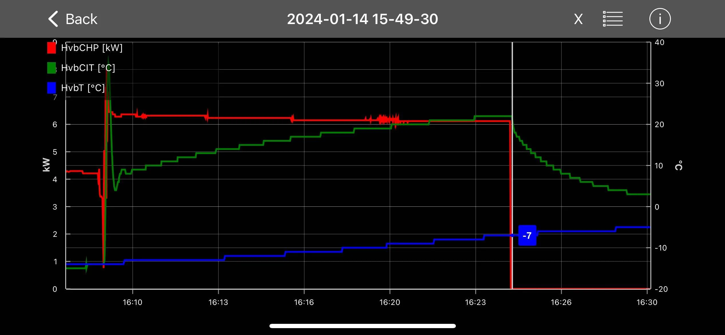

So let's take a look at the temperature graph:
Focus on the blue line which is the main pack temp. In 61 minutes it went from -8ÂșC (18ÂșF) to 26ÂșC (79ÂșF). The heater output started at 6.2 kW and gradually declined to 5.6 kW (this is the PTC effect as the coolant return temp increases). Keep in mind this graph really represents the fastest you could possibly heat the battery in these conditions, the amount of heat available with the HVAC on simultaneously will be quite a bit less. If the HVAC was on at the same time, pack heating likely would have taken two hours and would have run into a wall before reaching 26ÂșC. Perhaps it would have only reached 5ÂșC. This is why it was disabled due to limited heat reserve. I will need to wait for a warmer day to test battery preconditioning while the cabin heat is still active, but the rate of heating will be significantly less.
Now let's look at the DCFC session at a 150 kW EA station I reached shortly after battery heating finished:
Temp was down to about -20ÂșC/-4ÂșF when I pulled in. A lot of the chargers were displaying a "power reduced" message. I chose one not displaying the message, and activated with Plug & Charge. However I immediately noticed a 196A max current limitation (blue line), much less than the 350A these stations should be capable of. I wasn't happy with only 62 kW, so I decided to try a different dispenser. This one allowed up to 236A which was an improvement, but still slower than it should be. Not sure how much the cold affects these things. The car was correctly asking for full amperage (red line) at first, but the stations always supply (green line) 10-20 amps less than requested for some reason.
After reaching about 59%, the car decided to start requesting less current from the charger, you can see the red request line start decreasing. This is frustrating because the battery is warm enough and perfectly capable of handling the full 236A all the way up to at least 75-80% SoC. Ford has this weird charging strategy where they set the remainder of the charge curve based on the initial rate. Almost like it's a percentage of the initial rate. This means if you use a slower charging station, it will slow you down that much more for the rest of the curve based on the initial speed. This is totally not necessary, there should be a calculated maximum rate at each % SoC based on the battery temps. When using a slower DCFC station (<80 kW), it should be pegged at maximum output the whole way to 75-80%. At only 218A, no part of the battery should be getting that hot so I just don't see the need to throttle it. Ford should work on this strategy because they are needlessly reducing the charging speeds at lower power DCFC stations.
During the DCFC session, the battery was not heated any more by the PTC heater. I shut HVAC off to make sure, nothing happened. I've seen some cases where it heats more than 26ÂșC after starting a session, the decision to heat more must be tied to the charging power available. In this case heating more wasn't necessary for the speeds I was charging at. Temp increased from 23ÂșC to 26ÂșC on its own during the session (yellow trace at the top).
Findings:
  • Battery took 1 hour to heat from -8ÂșC to 26ÂșC using full 6 kW heater output (34ÂșC/hr)
  • Battery heat capacity is 0.18 kWh/ÂșC or 630 kJ/ÂșC
  • Preconditioning starts as soon as a DC station within 30 km is selected in the Ford nav
  • There is no time limit on battery heating as long as you remain within 30 km of the station
  • There is a 26ÂșC upper temp limit
  • En-route preconditioning will not occur at extreme cold temps unless you turn off HVAC
  • Many EA stations operate with significantly degraded performance
  • EA stations output 10-20 amps less than requested by the car
  • Additional heating above 26ÂșC while DCFCing is not always commanded
  • Ford throttles back the charge rate unnecessarily at lower-amperage DC stations
Conclusions:
  • The Mach-E needs a dedicated 5 kW battery heater that is not shared with the cabin.
  • Battery temp increase will be limited with only a 30 km range limit.
    • I think this limit should be increased to 60-120 km to give enough time.
  • EA stations are in varying states of disrepair
  • Ford should fix unnecessary throttling of low-amp DC stations and allow full current up to 75-80%. The current limit at 50-75% should not be affected by the initial station amperage unless using a high amperage (300+) station.
