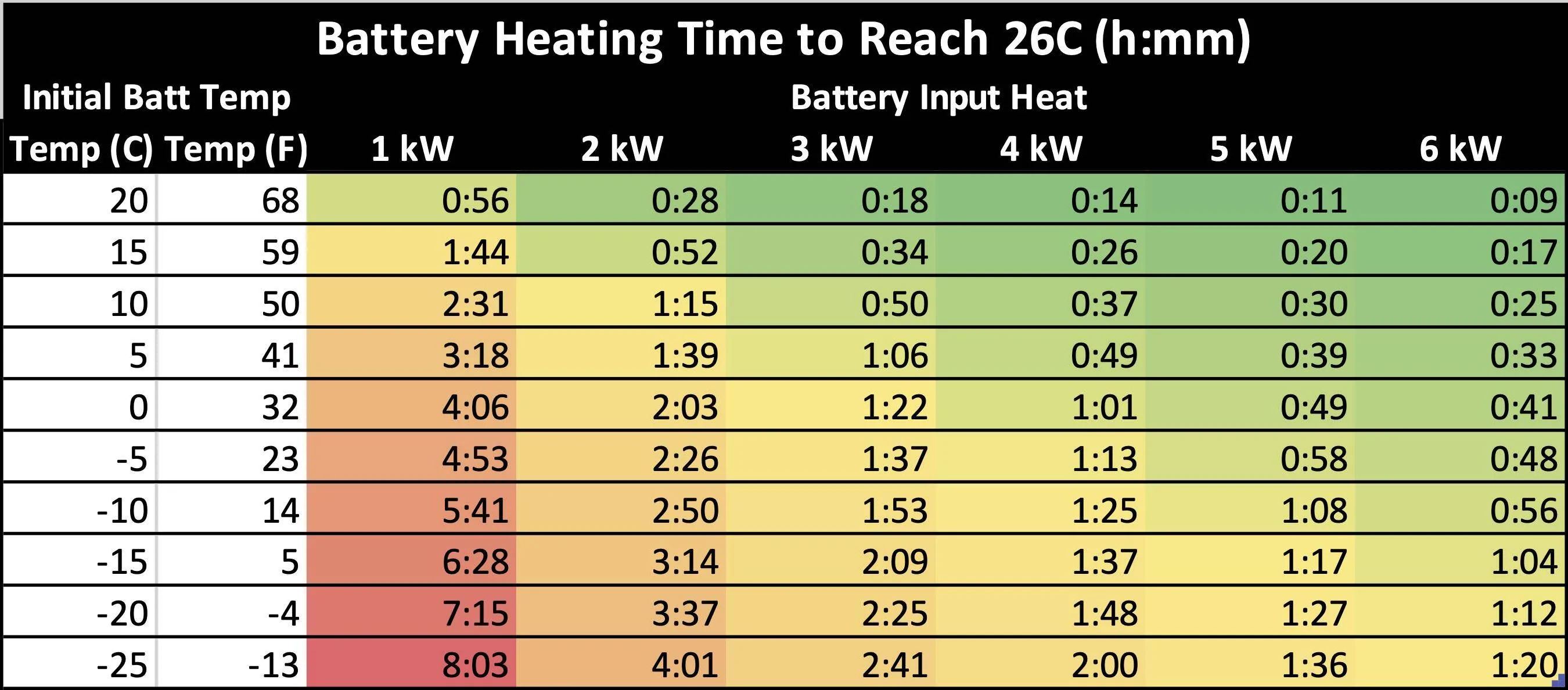

To go with the above post, I wanted to add this chart that provides the amount of time it would take to heat up the battery from various starting temps and input heat:
Ford Mustang Mach-E Mach-Lee's Mach-E Cold Weather Testing [Taking Requests] DCFC Heating Tim
Based on +38ÂșC/hr rate
Those times are hours and minutes, not minutes and seconds. Keep in mind that while using cabin heat (which shares the same heater), the amount of heat available for pack heating will be limited to around 1-4 kW depending on the outside temp (less when colder). For example, if the pack starts at 5ÂșC and you only have 2 kW of extra heat available, it will take 1 hour 39 minutes for it to warm up to DCFC temp while driving.
Now let's consider if you're driving 75 MPH / 121 kph on the interstate towards a DC fast station. The heating activates at only 30 km out. If you do the math, it will only run for about 15 minutes at interstate speed. Now look at that table and see in how many scenarios will the heating require less than 0:15? This is why the Mach-E needs a dedicated battery heater (so it runs in the last column), and why 30 km is peanuts in terms of time. The median time in this chart is 75 minutes. If we wanted the battery to heat that long, a range threshold of 150 km should be used. If the battery has been recently DC fast charged at a previous stop, perhaps it's cooled down to 15ÂșC and starting at around 80 km would be needed. It almost always requires a lot longer than 30 km to heat. Because of the large differences in times, the range threshold needs to be set intelligently based on the battery temp. I know this first version of en-route preconditioning was probably somewhat makeshift to introduce the feature, but hopefully we get something more efficacious by next winter.

Thanks for this!
I'm pretty impressed that Ford can keep the battery on a nearly linear 38ÂșC/hr warming rate for so long. For non-forced radiative cooling the cooling rate of a warm object at temperature T (in Kelvins) radiating to an environment T0 is dependent on (T-T0)^4. For forced cooling (i.e., wind blowing across the object), there's this radiative component as well as an additional forced component.

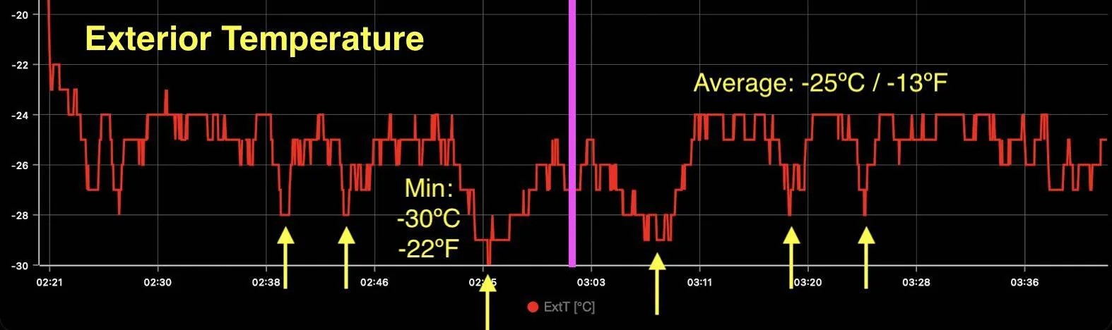

I took my usual 89.3 mi route, out and back (highway and 75 MPH on the interstate). At the halfway point where I turned around (magenta line on graphs), I removed the Reflectix and watched the effect on cabin temps. So first half of the test is with Reflectix, second half is without. First let's look at exterior temps:
Ford Mustang Mach-E Mach-Lee's Mach-E Cold Weather Testing [Taking Requests] Exterior Tem
The local weather stations were reporting about -15ÂșF at the time, so I think the sensor in the Mach-E for that data might be a little warmer than reality. I found it interesting you can see the symmetrical pattern of dips (yellow arrows) which are the valleys I drove through, they collect the sinking cold air and can be dramatically colder, and you can feel it. Takeaway message is the exterior temps were extremely similar during both halves of the trip. Now let's look at cabin temps:

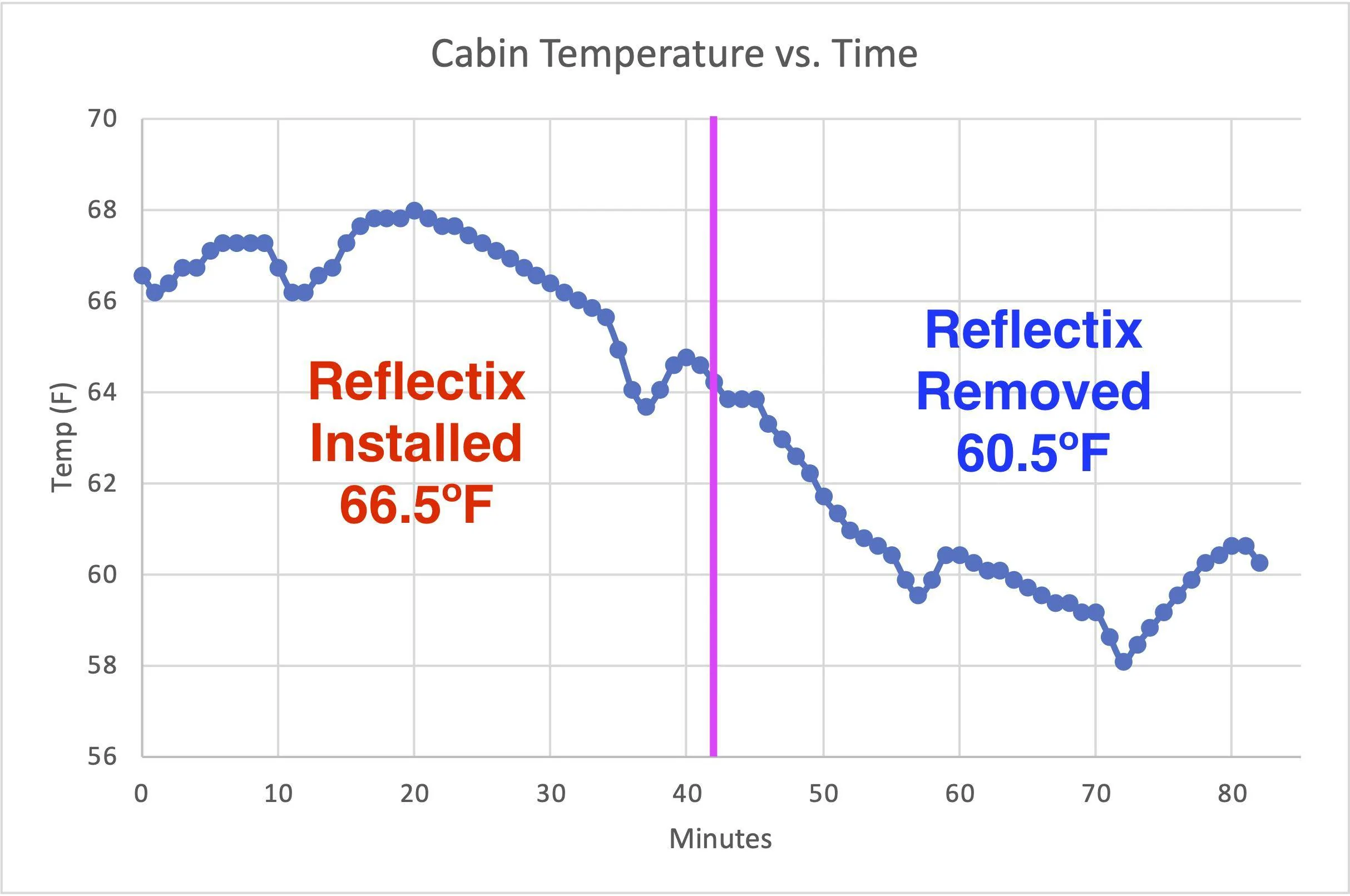

Ford Mustang Mach-E Mach-Lee's Mach-E Cold Weather Testing [Taking Requests] Reflectix Cabin Tem
HVAC set to 68ÂșF AUTO 2. This temp sensor was on the passenger seat at about chest height. During the first half, I felt mostly warm and comfortable. No draft under the seat. Vent temps were about 85ÂșF. Only when I was in the valley with -20ÂșF temps near the turnaround did I start to feel like I was getting too cold.
While turning around, I pulled the Reflectix down. IMMEDIATE COLD DRAFT on my head. In less than 5 minutes, my ankles and legs started to get uncomfortably cold due to the cold air pooling at the floor. There was now a cold draft coming from under the seat. Vent temps dropped about 15Âș to 70ÂșF. I was also monitoring the surface temp of a blanket (low thermal mass radiative telltale) on my front seat with my infrared temp gun. Before it was about 64ÂșF, after the Reflectix was removed I saw the blanket reading get down to 46ÂșF! It probably had a cold draft falling on it just like my head. In the graph above, you can see the immediate drop in temp right after removing, and the overall cooling trend during the second half. It wasn't until I got off the interstate and slowed down did the cabin temp start to recover some at the end. The dips in the graph are when the HVAC strategy closed off the fresh air, that changes the airflow pattern such the sensor actually got colder. The windows also fogged up some during those dips.

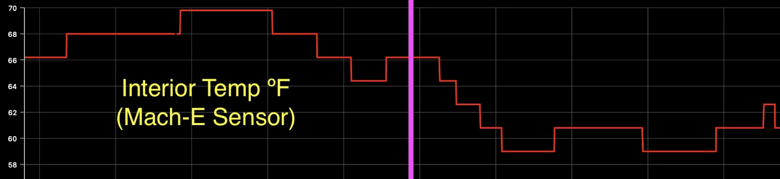

Ford Mustang Mach-E Mach-Lee's Mach-E Cold Weather Testing [Taking Requests] Interior Tem
This was the interior temp sensor above the rear mirror. This one registers about a 8ÂșF temp drop after Reflectix removal.
So my subjective view is putting in the Reflectix make a HUGE DIFFERENCE in comfort at these temps. Depending on the metric, I saw a 6-10ÂșF drop in average cabin temps. It honestly felt worse than that though. The drafts created by the cold glass overhead changed the temperature distribution in the cabin dramatically and created cold spots. If I would have put a temp sensor near the floor, I'm guessing it would have registered a 20ÂșF drop or more like the blanket did. Last, let's look at the battery temps like usual:

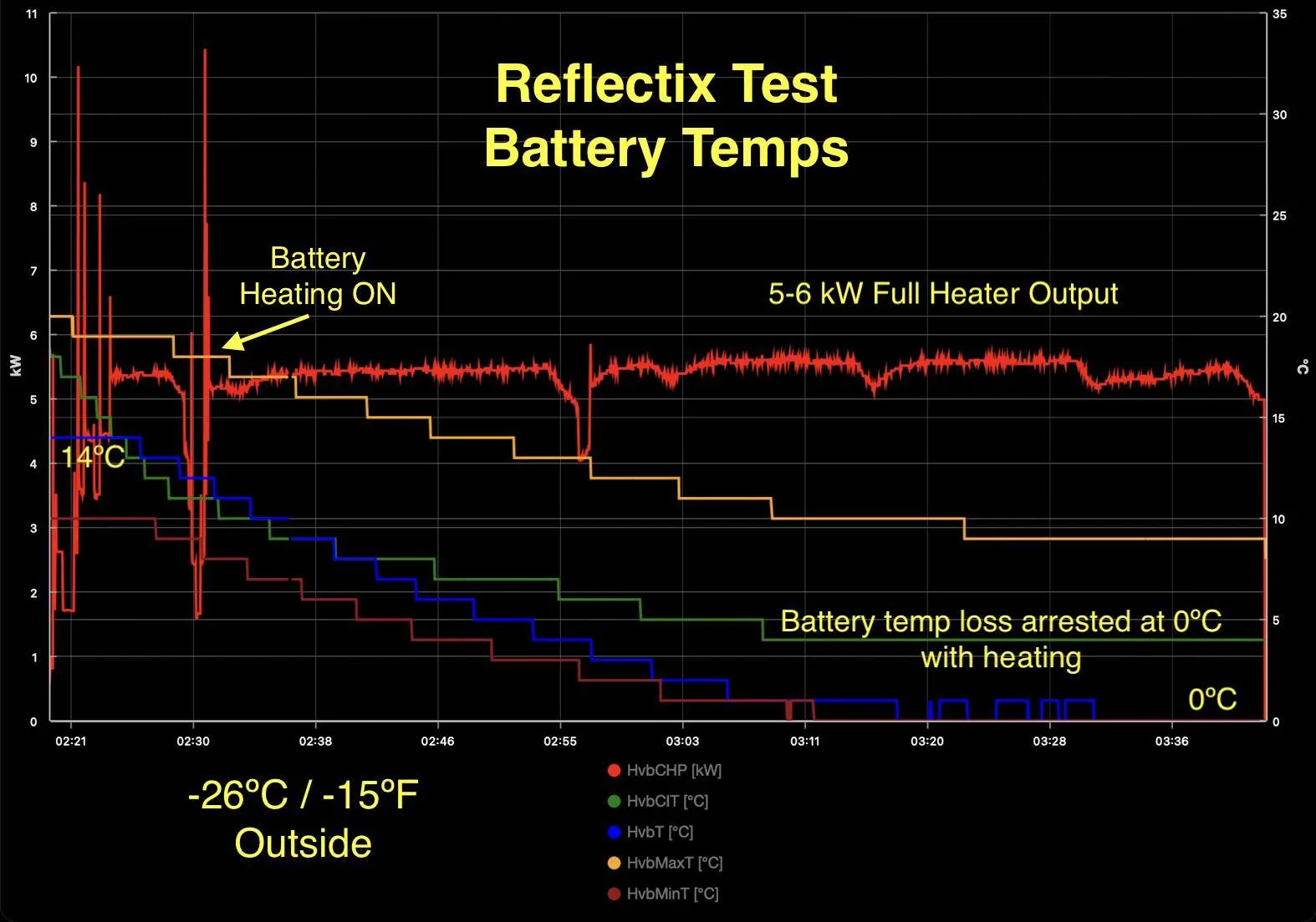

Ford Mustang Mach-E Mach-Lee's Mach-E Cold Weather Testing [Taking Requests] Reflextix Battery Temps
Looking at the inlet temp, the battery was being HEATED for most of the trip. It still cooled off though, the heater just slowed down the loss and arrested the battery temp right at 0ÂșC. Overall, the battery went from 14ÂșC to 0ÂșC. Because the of the extreme cold, the cabin is taking most of the heat. The battery is probably only getting about a 1 kW or less of heat, just enough to keep it around freezing.
