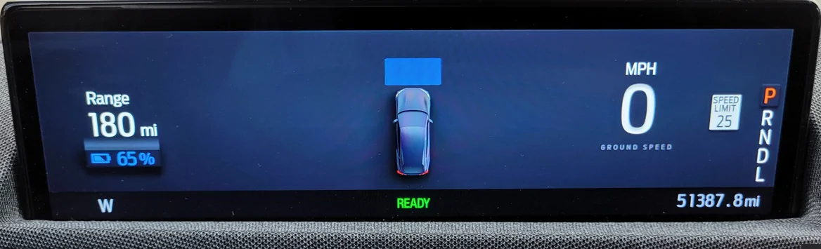

Wow. 5 whole weeks in a row where the car charged correctly every night! I think that might be a record! I guess Darren was right.....my car DOES get better over time! Progress. ?
Old streak ended. New one starts tomorrow (hopefully).
