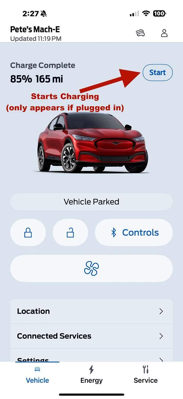

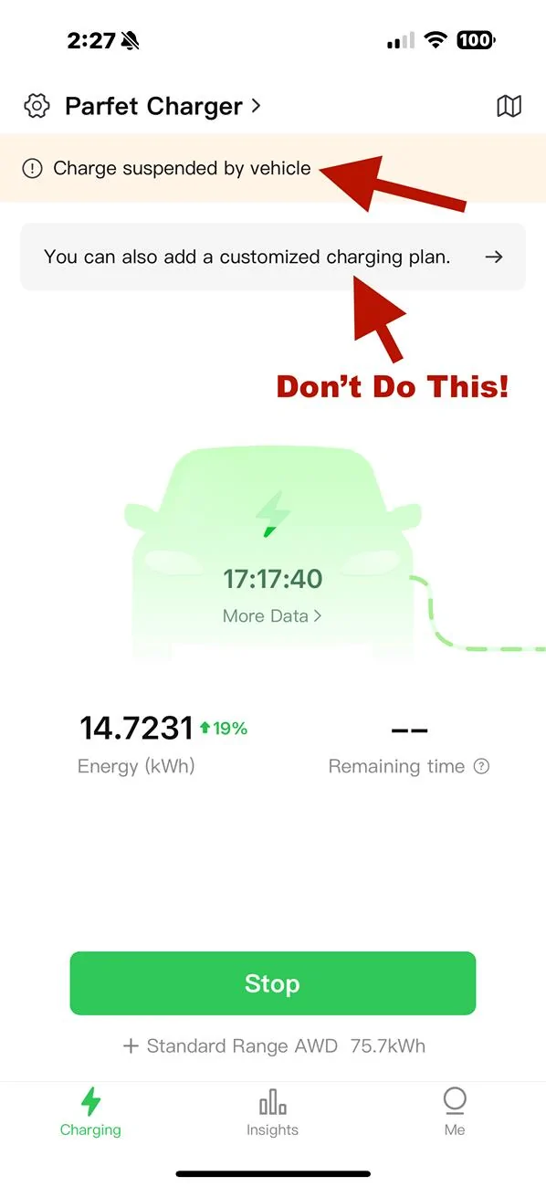

If this helps with any confusion, here are some screen shots from my phone. In the Autel app, make sure you don't have any charge schedules configured for the charger itself, since the car can handle the charge schedule itself (and allow manual overriding of the schedule). If you have a schedule set for the Autel, and you're not in your scheduled time, you can't override it with the Ford Pass app.
So I have my Autel set up with no "charging plan", so no RFID cards, etc. And it will try to charge the car any time I plug it in, and then the car overrides that with its own schedule (you can see the "Charge suspended by vehicle" notice in my Autel app, and that happened because it hit the car's target charge value for my home charger (which is currently set to 85%).
Then you see in the Ford Pass app that it is showing "Charge Complete" because it hit the target charge configured for my home charger. But since my car is still plugged in, I have the "Start" button available. If I hit that button now, it would start charging my car, even though it is currently outside my configured charging window that I set up in the car (since my power is cheaper at night than during the day).
Hope that helps!
Hope that helps!
Thanks that is helpful. I shot myself in the foot again by trying to set up my wife's phone as well as mine. Now I cannot access it by bluetooth because my wife's phone has taken priority, and she is not home. I will get this all sorted. It seems to be about the same level of difficulty as I had setting up the garage door opener. I have no idea why that finally is working after I spent a couple of hours repeating the process. Suddenly one of the buttons finally took the setting, and then the other two followed suit. I had that same issue 12 years ago when I set up "Homelink" on the Subaru I just gave to my son and his wife.
