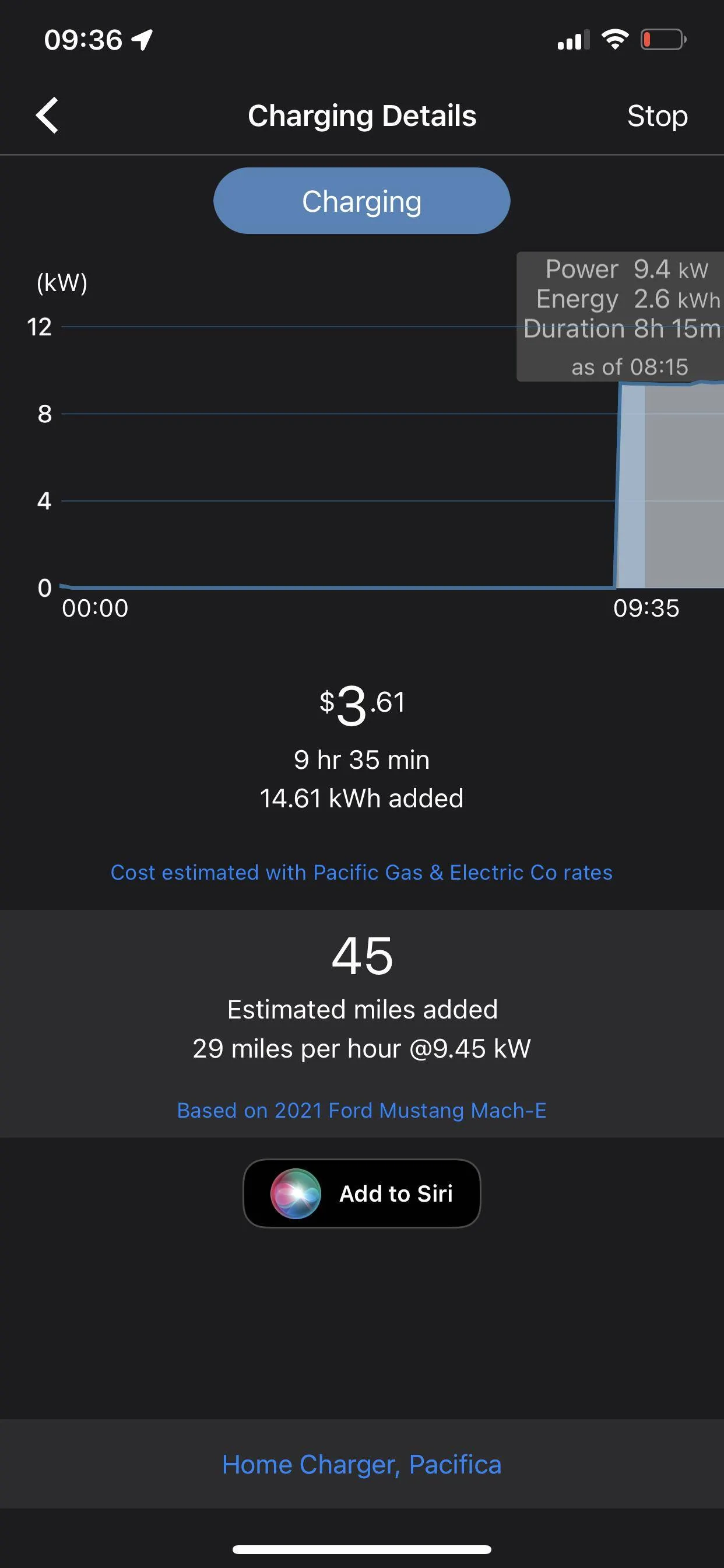

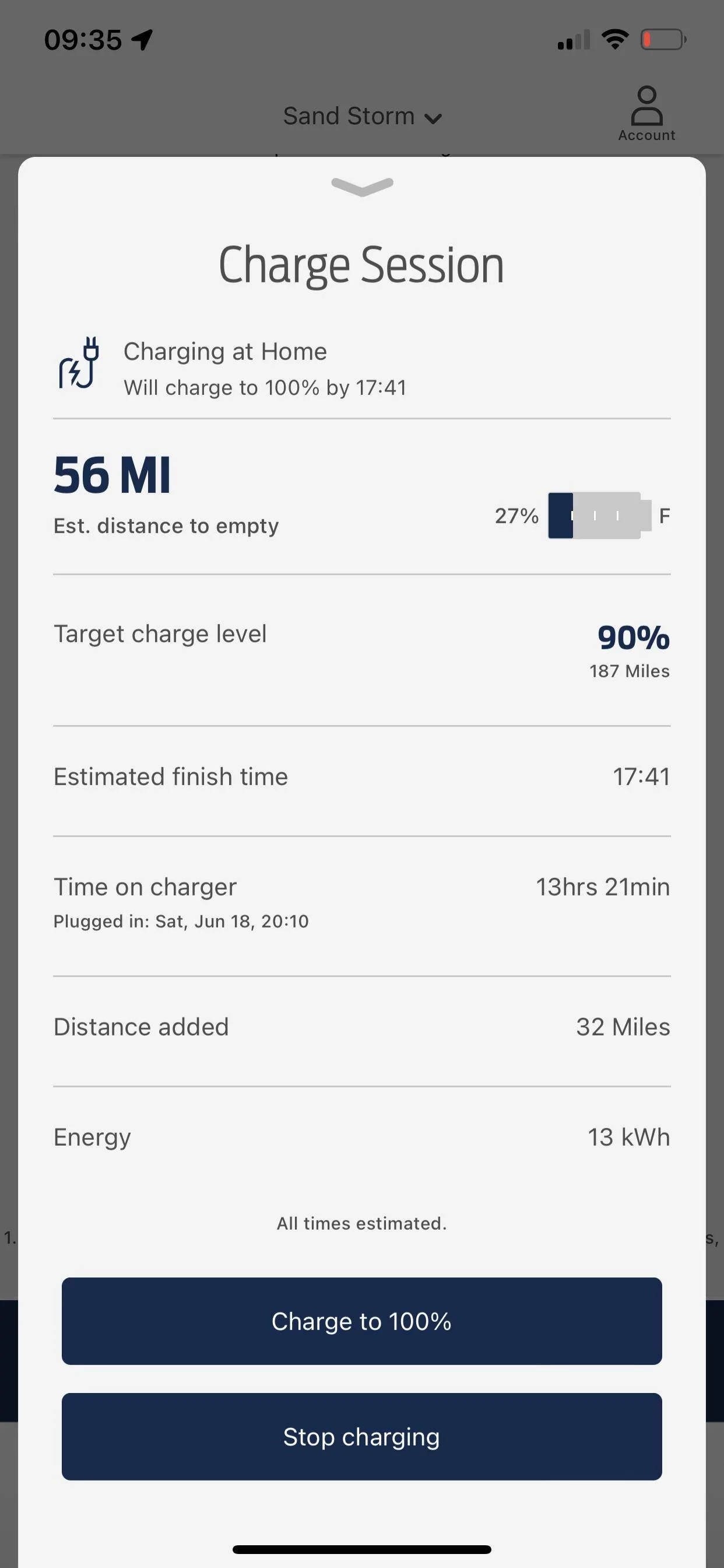

I woke up to this issue as well. First time and I’ve had the mach e since February and I have not changed any charge settings. My automatic updates are on Tuesday so I don’t think that would cause any issue. When I looked at my chargepoint app, it shows my mach e starting the charge at exactly 8 am this morning even though I plugged it in at 8pm last night.
same thing happened to me last night, but unplugging and resetting the the charger fixed everything
