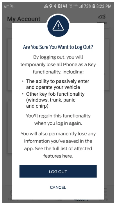

So, I have to make sure FordPass isn't running so it doesn't drain my battery, my phone will stay connected to SYNC and PaaK doen't conlict with my fob. At first, I was just opening up my settings in my phone, going to app management, find FordPass and Force Close it. Then I found a "Log Out" button in one of the screens so I tried logging out instead of force closing and I got this screen. It says I will permanently lose any information I have saved in the app and a can see a full list (but no link is given).
Do you guys thinks that logging out of FordPass caused my car NOT to charge overnight?
I doubt it, although that might depend on how you set the charge schedule. Did you do it in FordPass, or on the car screen? I would expect it shouldn't matter (that they would sync with each other), but who knows. I always set my charge schedule in the car, not the app. Had a problem with it not working once, but the rest of the time it's charged at the scheduled time.
I am running the FordPass app, but don't have PAAK set up.
I guess you could find out. After you log out of the app, go to the car and see if the charge schedule is still set.

I logged into ForPass last night and forgot to log out and woke up to a charged car. I am logged out now so we will see what happens tonight.....

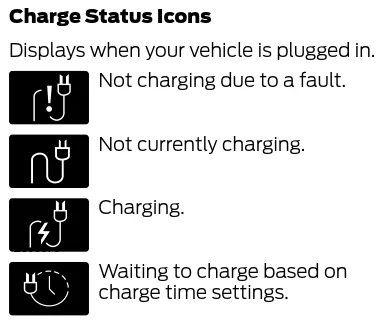

  1. If you plug in at a new or unknown location then the vehicle will begin charging now and continue to do so up to 100%. If you aren't sure if your car is charging then you can view the icons on your screen.
