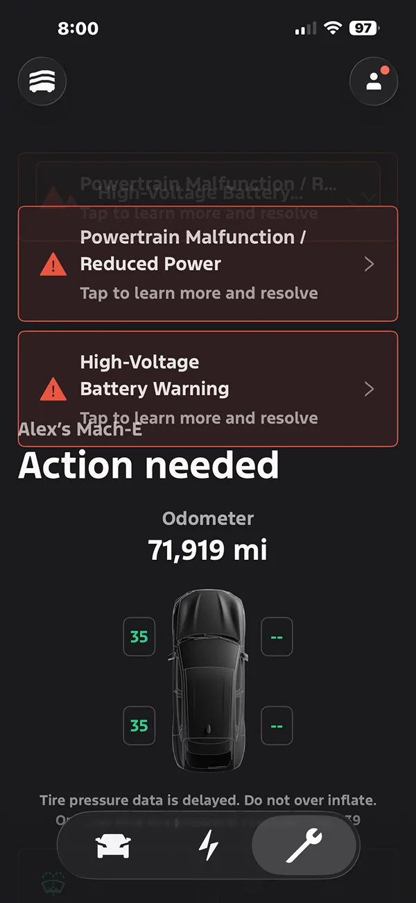

Looks like that’s probably what is is as these alerts suddenly popped up on the Ford app this morning which means they probably started working on the car already.
